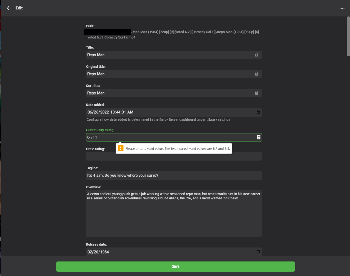

gjames50 7 Posted August 11, 2022 Posted August 11, 2022 (edited) I'm having some strange behavior with some metadata after new media is added. Occasionally the community ratings will have 100ths and 1000ths. It displays correctly however when I go to edit save the metadata (changing some other setting/parameter) I get the error "Please enter a valid value. The two nearest valid values are X.X and X.X". This is annoying as I then have to manually change the community rating to a tenths value then save. I don't ever remember running into to this before. Can Emby just automatically round these values so I don't have to manually do this? This only is an issue when I have to edit a particular piece of media that has a rating beyond the tenths. See screenshot for example. Thank you. Edited August 11, 2022 by gjames50
Happy2Play 9800 Posted August 11, 2022 Posted August 11, 2022 14 minutes ago, gjames50 said: I'm having some strange behavior with some metadata after new media is added This media shows it was added 6/26/2022 are you seeing this on any newly added media? This has been reported a couple times and appear to be from a defect on previous nfo writer. Unfortunately you have to Refresh Metadata or manually adjust the affected media.
Happy2Play 9800 Posted August 11, 2022 Posted August 11, 2022 Adding other topic. https://emby.media/community/index.php?/topic/109973-strange-issue-with-the-rating-of-movie-invalid-value
gjames50 7 Posted August 11, 2022 Author Posted August 11, 2022 15 minutes ago, Happy2Play said: This media shows it was added 6/26/2022 are you seeing this on any newly added media? This has been reported a couple times and appear to be from a defect on previous nfo writer. Unfortunately you have to Refresh Metadata or manually adjust the affected media. I'm only noticing this on newly added media, because I only edit metadata on new media. I really don't know if it is happening with old media. This media was added today and I edited it today and I only had it happen maybe four times today. I've just never ran into this. Emby is fully updated. Not sure what changed as I didn't do anything that I haven't done in the past 5 to 10 years.

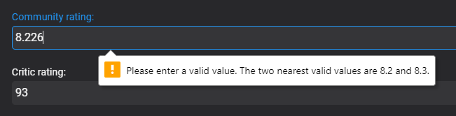

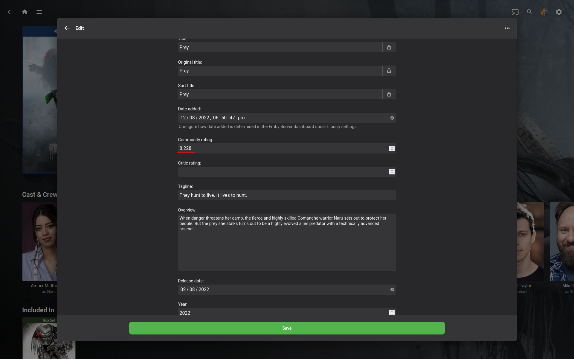

seanbuff 1353 Posted August 12, 2022 Posted August 12, 2022 43 minutes ago, Happy2Play said: @seanbuff Do you have a specific example and your metadata download order? Also do you write nfo files with media? Yup, 'Prey (2022)' I just did a refresh of the metadata, and it pulled in this value just now My order: And yes, I do write NFO files. 1

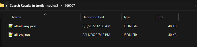

Happy2Play 9800 Posted August 12, 2022 Posted August 12, 2022 @seanbuff Thanks @Lukeapi shows 8.23 but cache all-en.json shows 8.225 and all-alllang.json shows 8.246 "vote_average": 8.23, (api) "vote_average": 8.225, "vote_average": 8.246, Refreshed metadata So is there a defect here in what is recorded Refreshed Today shown in all-en?
Junglejim 385 Posted August 12, 2022 Posted August 12, 2022 8 hours ago, seanbuff said: Yup, 'Prey (2022)' I just did a refresh of the metadata, and it pulled in this value just now My order: And yes, I do write NFO files. Yep I've seen this a few times recently. Usually I check the metadata and manually correct it.

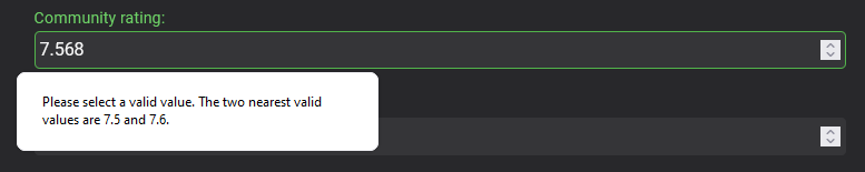

stephen_hill 46 Posted August 18, 2022 Posted August 18, 2022 Hello I'm running Emby 4.7.6.0 on Debian. The value automatically imported into the "Community Rating" field has a number of decimal places greater than the user interface allows. When editing the metadata of an affected entry, you must manually reduce the number of decimal places before you can save. The example above is for the move Arrival (2016). The imported community rating is 7.568 (3 decimal places), but when I try to save after making a unrelated change, I must manually adjust the rating. To be clear, the value "7.568" was automatically imported by Emby. One of the following changes should be made to Emby Adjust the UI to accept more decimal places (up to the maximum allowed by the database) or, round the value to 1 decimal place before importing into the database Cheers Stephen
