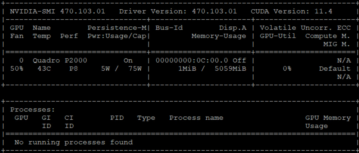

hispeed 9 Posted September 23, 2022 Author Posted September 23, 2022 @Luke So far I can give a first update: I have installed on a Ubuntu VM machine the nvidia driver sucessfully using this tutorial (https://forum.openmediavault.org/index.php?thread/38013-howto-nvidia-hardware-transcoding-on-omv-5-in-a-plex-docker-container/#codeLine_3_com_woltlab_wbb_post_313378_432646) I can also confirm that a Quadro P2000 looks so far good concering my plan to recieve hardware encoding in docker. This is a HP DL380 G9 and I'm not using an original HP part. So the GPU is not HP labeled but the numbers are very close. Here is a first image, until now it has nothing to do with docker and Emby. 1

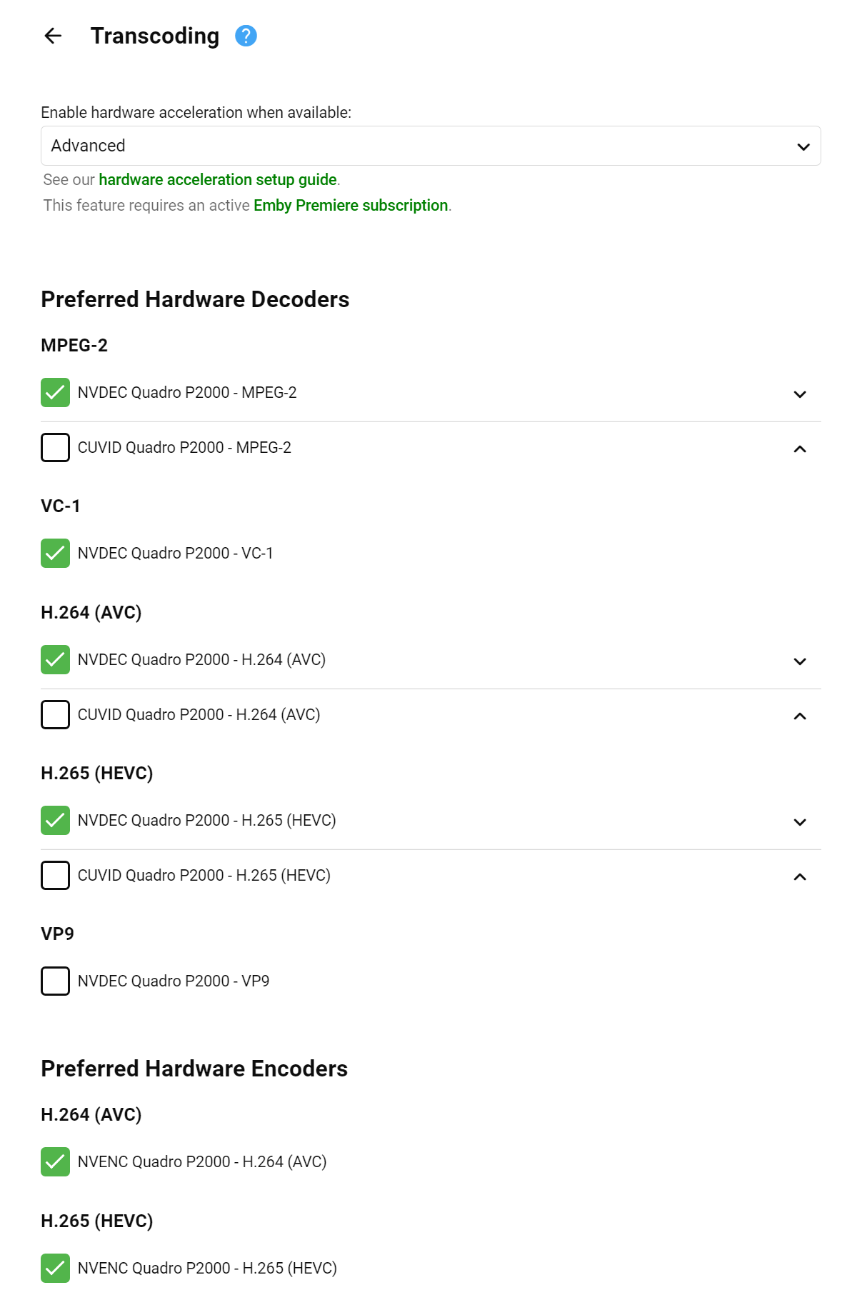

hispeed 9 Posted October 23, 2022 Author Posted October 23, 2022 @Luke I let the devil queen out there.... I copied my whole VM and added it on the ESXI Host as a copy. I only installed emby on this second docker host. This looks good but in the container it doesn't work. So it has something to do with my docker settings. Sample:
Luke 42245 Posted October 24, 2022 Posted October 24, 2022 On 10/23/2022 at 4:18 AM, hispeed said: @Luke I let the devil queen out there.... I copied my whole VM and added it on the ESXI Host as a copy. I only installed emby on this second docker host. This looks good but in the container it doesn't work. So it has something to do with my docker settings. Sample: What exactly is the problem with this?
hispeed 9 Posted October 25, 2022 Author Posted October 25, 2022 @Luke With this, there is no problem. This only to proof that the problem only exists within the docker container. Outside of the container on a virtualized system on a esxi 7.X it's working fine. My question is then, any recomendation concerning the docker compose template or so?
