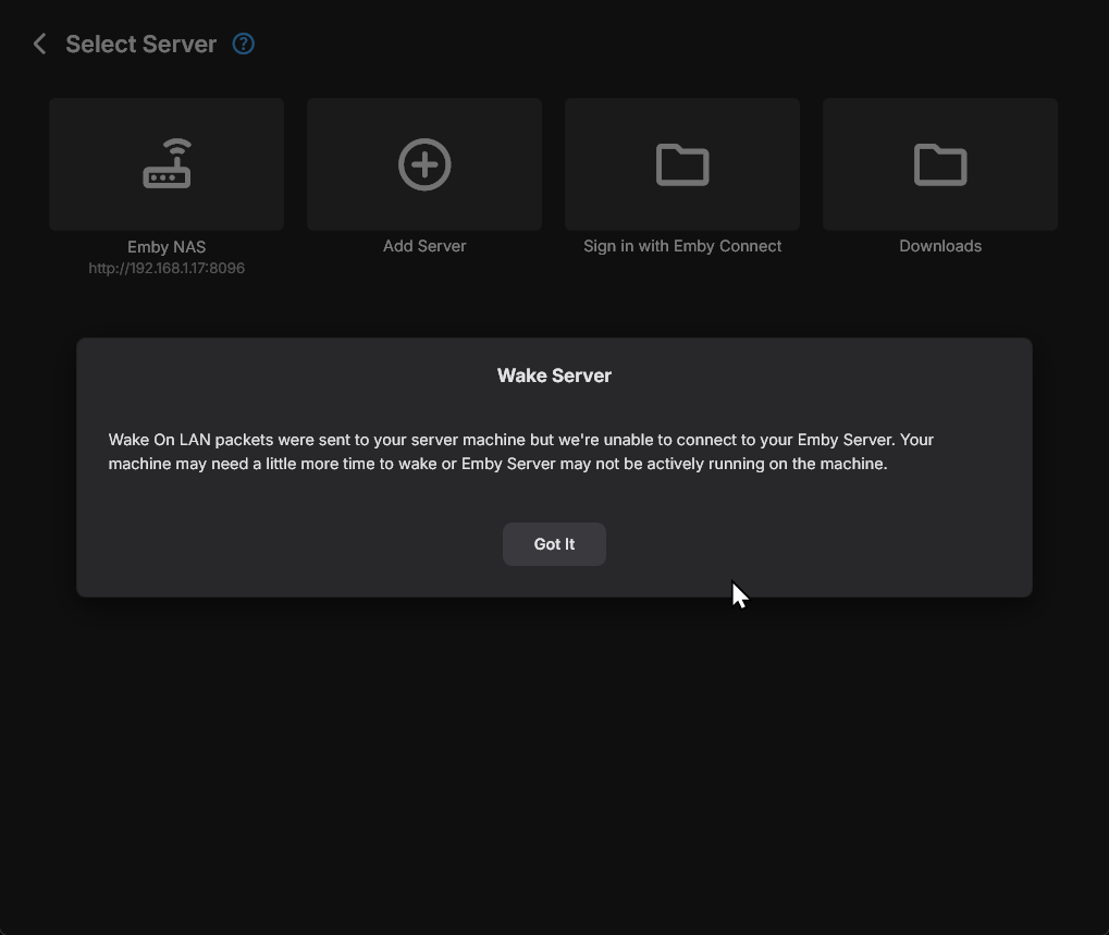

MrIncredible 2 Posted October 23, 2024 Author Posted October 23, 2024 11 hours ago, Luke said: Hi, where are you looking for it? OOps, just found it! Sorry! Was expecting to see the option once the connection failed like it does in the Desktop App. But on the Store App it's on the three dots menu. However, the WOL still does not work for the server (Unraid) on which Emby is installed (Docker container). I loaded WOLSniffer to monitor for the WOL packets when I tried to wake the server, but there were none from the App at all. Will the Desktop Theater App be updated from 3.0.20 or is this sunsetted in favor of the Emby Theater Store App? For some reason I cannot get the windows store Theater App to go full screen without a top blue border! Can you put a webhook in the client side to fire a webhook to wake the server? I have a URL that can wake the Unraid server! Here's the WOL packets that are sent out from the Alexa WOL Skill....... The tool to troubleshoot Wake-on-LAN. www.profshutdown.com (C) 2014, APREL Technologies Sniffing is started! ---------------------------Wake-On-LAN Magic Packet--------------------------- Time received: 10/23/24 12:20:11 UDP Header: |-Source IP : 192.168.1.145 |-Destination IP : 192.168.1.255 |-Source Port : 58918 |-Destination Port : 9 |-UDP Length : 110 |-UDP Checksum : 23481 MAC Address: 00 25 22 E6 60 79 Raw Data (102 bytes): FF FF FF FF FF FF 00 25 22 E6 60 79 00 25 22 E6 60 79 00 25 22 E6 60 79 00 25 22 E6 60 79 00 25 22 E6 60 79 00 25 22 E6 60 79 00 25 22 E6 60 79 00 25 22 E6 60 79 00 25 22 E6 60 79 00 25 22 E6 60 79 00 25 22 E6 60 79 00 25 22 E6 60 79 00 25 22 E6 60 79 00 25 22 E6 60 79 00 25 22 E6 60 79 00 25 22 E6 60 79 ---------------------------Wake-On-LAN Magic Packet--------------------------- Time received: 10/23/24 12:20:11 UDP Header: |-Source IP : 192.168.1.191 |-Destination IP : 192.168.1.255 |-Source Port : 48002 |-Destination Port : 9 |-UDP Length : 110 |-UDP Checksum : 34351 MAC Address: 00 25 22 E6 60 79 Raw Data (102 bytes): FF FF FF FF FF FF 00 25 22 E6 60 79 00 25 22 E6 60 79 00 25 22 E6 60 79 00 25 22 E6 60 79 00 25 22 E6 60 79 00 25 22 E6 60 79 00 25 22 E6 60 79 00 25 22 E6 60 79 00 25 22 E6 60 79 00 25 22 E6 60 79 00 25 22 E6 60 79 00 25 22 E6 60 79 00 25 22 E6 60 79 00 25 22 E6 60 79 00 25 22 E6 60 79 00 25 22 E6 60 79 ---------------------------Wake-On-LAN Magic Packet--------------------------- Time received: 10/23/24 12:20:11 UDP Header: |-Source IP : 192.168.1.145 |-Destination IP : 192.168.1.255 |-Source Port : 37379 |-Destination Port : 9 |-UDP Length : 110 |-UDP Checksum : 45020 MAC Address: 00 25 22 E6 60 79 Raw Data (102 bytes): FF FF FF FF FF FF 00 25 22 E6 60 79 00 25 22 E6 60 79 00 25 22 E6 60 79 00 25 22 E6 60 79 00 25 22 E6 60 79 00 25 22 E6 60 79 00 25 22 E6 60 79 00 25 22 E6 60 79 00 25 22 E6 60 79 00 25 22 E6 60 79 00 25 22 E6 60 79 00 25 22 E6 60 79 00 25 22 E6 60 79 00 25 22 E6 60 79 00 25 22 E6 60 79 00 25 22 E6 60 79 ---------------------------Wake-On-LAN Magic Packet--------------------------- Time received: 10/23/24 12:20:11 UDP Header: |-Source IP : 192.168.1.191 |-Destination IP : 192.168.1.255 |-Source Port : 42551 |-Destination Port : 9 |-UDP Length : 110 |-UDP Checksum : 39802 MAC Address: 00 25 22 E6 60 79 Raw Data (102 bytes): FF FF FF FF FF FF 00 25 22 E6 60 79 00 25 22 E6 60 79 00 25 22 E6 60 79 00 25 22 E6 60 79 00 25 22 E6 60 79 00 25 22 E6 60 79 00 25 22 E6 60 79 00 25 22 E6 60 79 00 25 22 E6 60 79 00 25 22 E6 60 79 00 25 22 E6 60 79 00 25 22 E6 60 79 00 25 22 E6 60 79 00 25 22 E6 60 79 00 25 22 E6 60 79 00 25 22 E6 60 79 ---------------------------Wake-On-LAN Magic Packet--------------------------- Time received: 10/23/24 12:20:11 UDP Header: |-Source IP : 192.168.1.145 |-Destination IP : 192.168.1.255 |-Source Port : 47516 |-Destination Port : 9 |-UDP Length : 110 |-UDP Checksum : 34883 MAC Address: 00 25 22 E6 60 79 Raw Data (102 bytes): FF FF FF FF FF FF 00 25 22 E6 60 79 00 25 22 E6 60 79 00 25 22 E6 60 79 00 25 22 E6 60 79 00 25 22 E6 60 79 00 25 22 E6 60 79 00 25 22 E6 60 79 00 25 22 E6 60 79 00 25 22 E6 60 79 00 25 22 E6 60 79 00 25 22 E6 60 79 00 25 22 E6 60 79 00 25 22 E6 60 79 00 25 22 E6 60 79 00 25 22 E6 60 79 00 25 22 E6 60 79 ---------------------------Wake-On-LAN Magic Packet--------------------------- Time received: 10/23/24 12:20:11 UDP Header: |-Source IP : 192.168.1.191 |-Destination IP : 192.168.1.255 |-Source Port : 43820 |-Destination Port : 9 |-UDP Length : 110 |-UDP Checksum : 38533 MAC Address: 00 25 22 E6 60 79 Raw Data (102 bytes): FF FF FF FF FF FF 00 25 22 E6 60 79 00 25 22 E6 60 79 00 25 22 E6 60 79 00 25 22 E6 60 79 00 25 22 E6 60 79 00 25 22 E6 60 79 00 25 22 E6 60 79 00 25 22 E6 60 79 00 25 22 E6 60 79 00 25 22 E6 60 79 00 25 22 E6 60 79 00 25 22 E6 60 79 00 25 22 E6 60 79 00 25 22 E6 60 79 00 25 22 E6 60 79 00 25 22 E6 60 79 Thanks.
Luke 42233 Posted October 23, 2024 Posted October 23, 2024 Hi, the app supports wol and it works just fine, however it currently requires default conditions for things like the subnet address and port. The two apps are in process of being unified together.
MrIncredible 2 Posted October 23, 2024 Author Posted October 23, 2024 (edited) Ok. However, I installed the Windows Store (WS) for the first time yesterday and AFAICT I use the default HTTP port (8096) and both my PC and the Unraid server are on the same subnet. The WS instance did not send any WOL packets when I tried to wake the server. It's not that the WS client was trying to wake the wrong server, there were NO WOL packets whatsover when I tried. Under what conditions does your WS instance 'work fine'? Mine doesn't! Thanks. Edited October 23, 2024 by MrIncredible
Luke 42233 Posted October 23, 2024 Posted October 23, 2024 I would wait and reevaluate this in a couple weeks as a newly revamped version of the app is set to be released. Thanks.
MrIncredible 2 Posted October 23, 2024 Author Posted October 23, 2024 Will do! Would a webhook in the client be a workable alternative? It certainly works well for me in the Server side!
