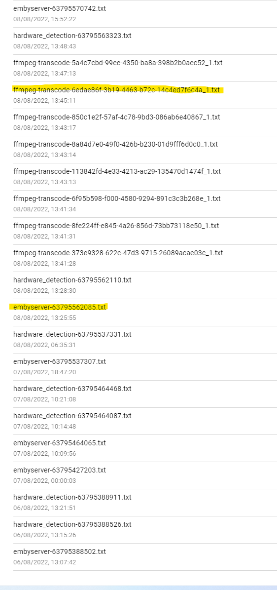

aussiedropbear 1 Posted August 9, 2022 Author Posted August 9, 2022 1 hour ago, Happy2Play said: That server log if for before the playback ffmpeg log. Can you post the server log for the same time frame. I believe that is for the same time frame? see image screenshot
Happy2Play 9811 Posted August 9, 2022 Posted August 9, 2022 @aussiedropbear that log ends at 2022-08-08 13:25:55.158 but the playback ffmpeg log starts at 2022-08-08 13:43:18.070 almost 20 minutes later. I would guess the top log from that image.
aussiedropbear 1 Posted August 9, 2022 Author Posted August 9, 2022 (edited) 2 hours ago, Happy2Play said: @aussiedropbear that log ends at 2022-08-08 13:25:55.158 but the playback ffmpeg log starts at 2022-08-08 13:43:18.070 almost 20 minutes later. I would guess the top log from that image. Well, here is the log directly above .. Happy to give access if it helps? embyserver-63795570742.txt Edited August 9, 2022 by aussiedropbear
