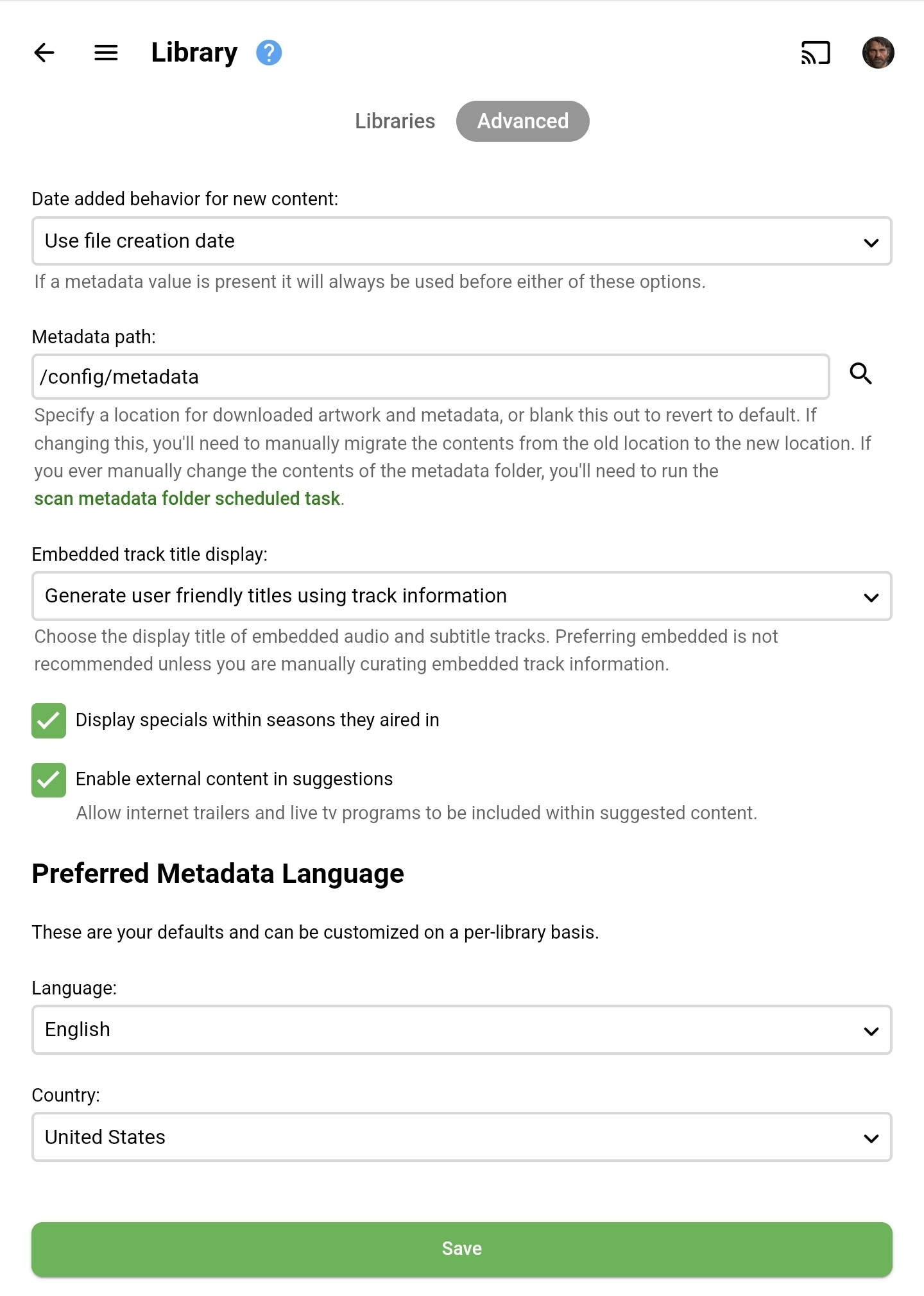

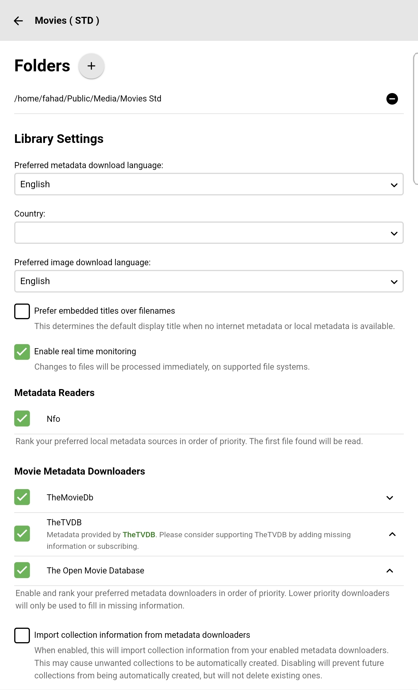

fahad92 7 Posted August 7, 2022 Posted August 7, 2022 (edited) Hi, I had my default language for one of my libery to Arabic but change it later to English but ever since every day I find my media are having Arabic Title, summary ( whatever is available in the Sources in Arabic) I tried the below with no luck : 1 - deleted all my metadata content and caches which is working at first then again Emby change it later to Arabic 2 - manual referesh is working but I will find later changed to Arabic 3 - deleted any info files in the media folders 4 - tried to check and play with all settings options My settings screenshots are attached and logs as well which is very huge one ( the latest) and I don't know how to trigger this issue it could take 24 hours for some of my media to switch back to Arabic and again the log is gonna be long as this one. It's very annoying issue, I did the same thing with Plex but all are good any language switch is smooth so this is clearfiy the issue is not in my media folder. embyserver.txt Edited August 7, 2022 by fahad92

Happy2Play 9812 Posted August 8, 2022 Posted August 8, 2022 @fahad92 But deleting an nfo that is already added to the database does not change already imported information. If language is already set in nfo files then it will always be used, so can you go over a specific example to include the nfo file.
fahad92 7 Posted August 8, 2022 Author Posted August 8, 2022 37 minutes ago, Happy2Play said: @fahad92 But deleting an nfo that is already added to the database does not change already imported information. If language is already set in nfo files then it will always be used, so can you go over a specific example to include the nfo file. Attached one example but I don't understand why this language still being choosed in the file. I set it to English few weeks ago but new contents still added in Arabic. Example.nfo
Solution Happy2Play 9812 Posted August 8, 2022 Solution Posted August 8, 2022 @fahad92 What program is maked this nfo file as it does not appear to something Emby made? But not seeing a language field from original guess. 1
fahad92 7 Posted August 8, 2022 Author Posted August 8, 2022 34 minutes ago, Happy2Play said: @fahad92 What program is maked this nfo file as it does not appear to something Emby made? But not seeing a language field from original guess. Oh right your question made me realize I did connect something external to grap the metadata to that folder but completely forget about it. Sorry to waste your time but if you didn't mention that this nfo is not by Emby I would have never remembered. Thank you 1
