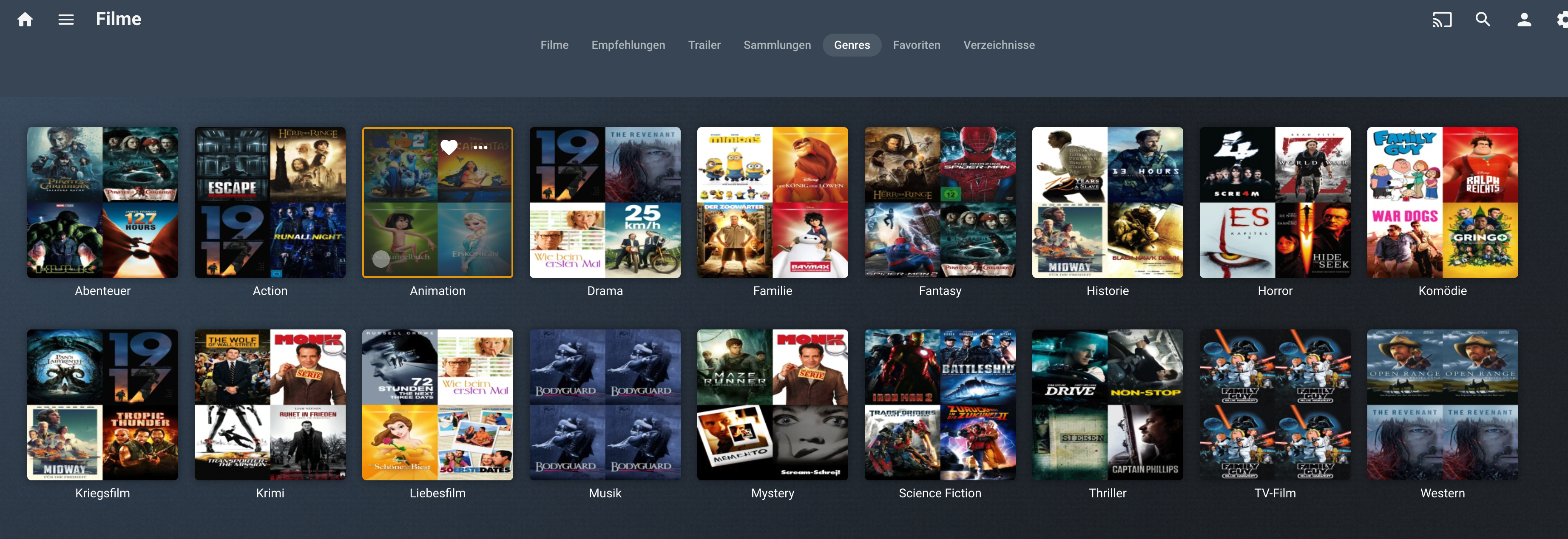

Pixelpaule 4 Posted September 23, 2022 Author Posted September 23, 2022 Hey, sorry @Luke for my late feedback. Unfortunately, I only got around to putting the info together yesterday. I'll try to describe the problem in a bit more detail. @Happy2Play When the remote shares with my movies and series (Unraid Server 2) are not accessible, because the server is in standby, the pictures and graphics of the movies and series are partly not displayed. Remote share is offline (stand by) Some movies are displayed correctly, many are missing images. Descriptions, actors and other data remain visible. Collections are always displayed correctly. Genres are always displayed correctly. Only after I click "Update metadata" + "Replace existing images" the images are displayed again. But for this the remote share must be reachable! If the share is not available (because in standby), all movies & series are removed from the library. The images are not displayed if the remote share is online and I have not executed "Update Metadata"! I store all media data (covers, fanarts, logos, etc.) for movies and series in the media folders on the remote share (//data-storage/movies - as you can see in the first screenshot). As it is described in the documentation of Emby. The rest of the metadata is stored in the default directory. So these are stored in the appdata folder of the Docker container. This folder is located on the Unraid Server 1 on which Emby is running. This is online 24/7.
Happy2Play 9800 Posted October 3, 2022 Posted October 3, 2022 If I understand correctly since the media is offline the server does not display images as Emby does not preemptively cache images stored with media. Preemptively cache images - Feature Requests - Emby Community 1
