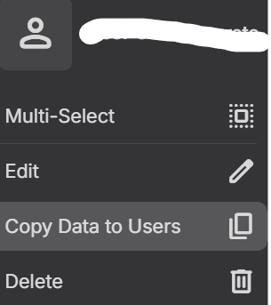

Luke 43549 Posted May 22 Posted May 22 8 hours ago, dcook said: 16 years has gone by and you still can't manage users properly Here are the FR's regarding user management both of them are in the top 5 of all requests Have you explored the copy settings features that have been added?

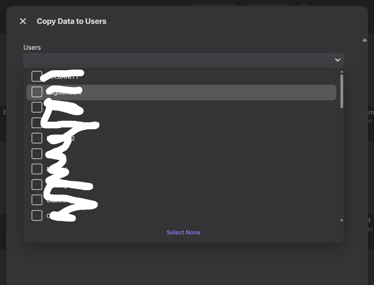

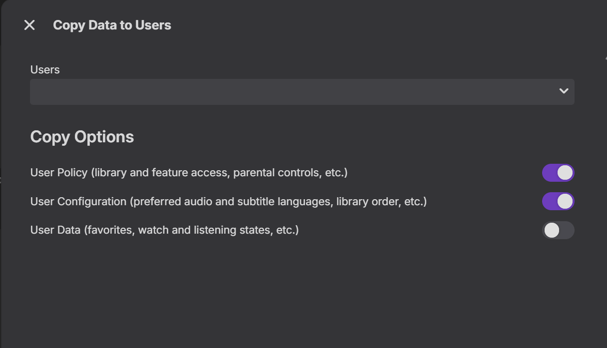

bandit8623 296 Posted May 22 Posted May 22 (edited) 8 hours ago, dcook said: 16 years has gone by and you still can't manage users properly Here are the FR's regarding user management both of them are in the top 5 of all requests looks like now there are sone nice copy features Edited May 22 by bandit8623
dcook 319 Posted May 23 Posted May 23 Yes, last time I tried it did not work 100%, not all of the user settings were copied. I still had to manually go back in and edit the user settings to match
