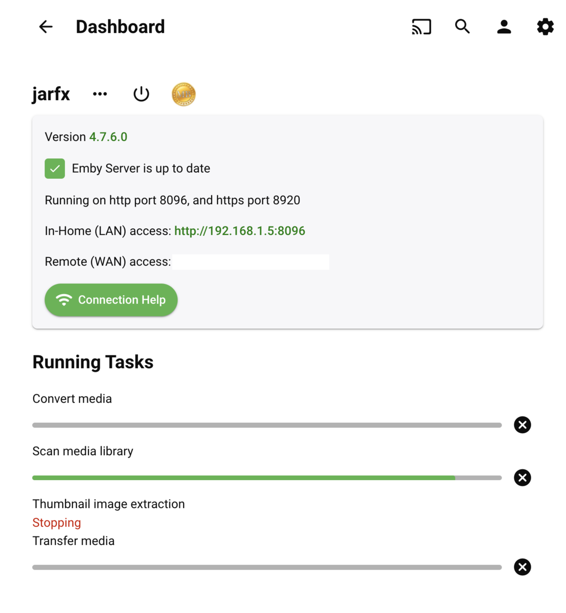

BJ1983tn 0 Posted July 30, 2022 Posted July 30, 2022 I am running the server on LEAP 15.4. It has been sitting for hours with no progress. embylogs.txt
Luke 42245 Posted July 30, 2022 Posted July 30, 2022 Hi, did you try refreshing the page? It might just be the progress bar not moving on the web page.
BJ1983tn 0 Posted July 30, 2022 Author Posted July 30, 2022 Yes. I think it was file permissions. I added Emby to the user group so it can access the files.
BJ1983tn 0 Posted July 31, 2022 Author Posted July 31, 2022 But it has been stuck at 90.1% scanning media library for 12 hours now.

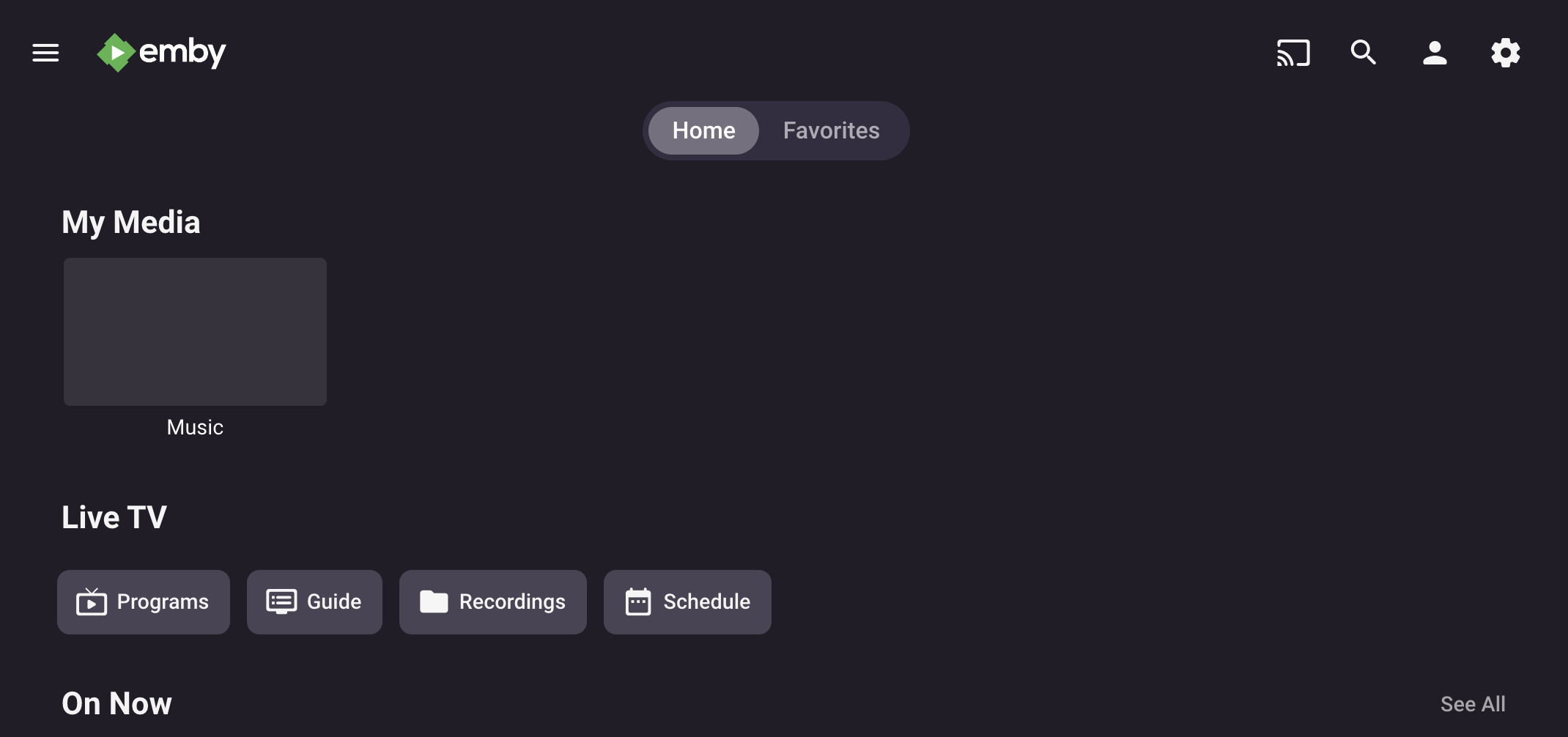

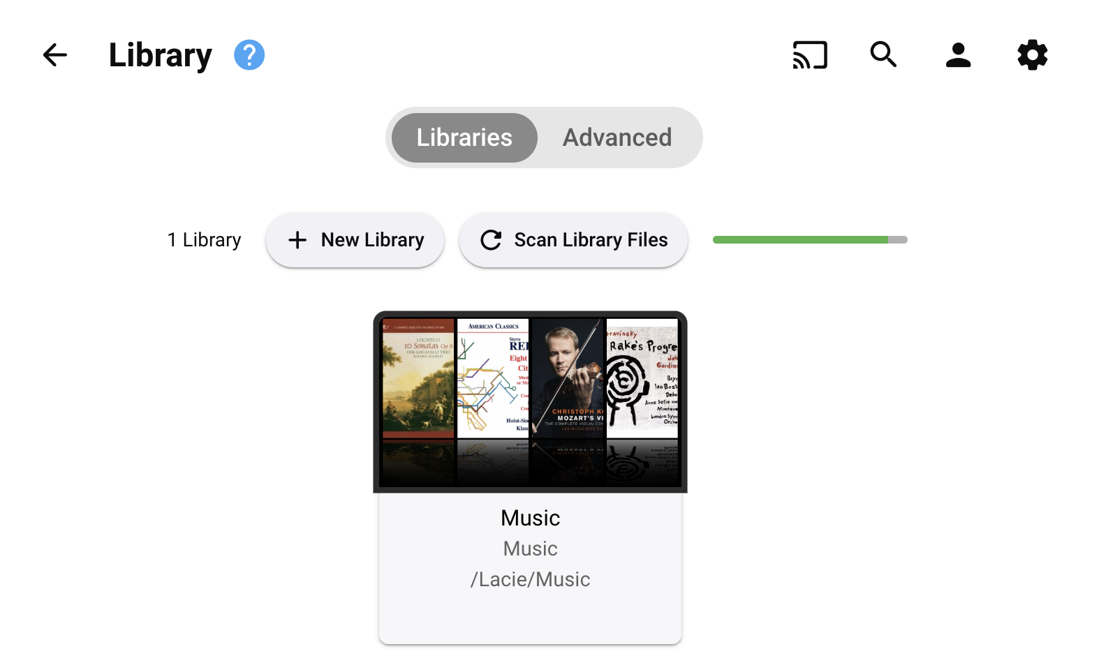

BJ1983tn 0 Posted August 1, 2022 Author Posted August 1, 2022 (edited) It was difficult to stop the server to do the update to new version. And you need to properly sign the package! Connecting after a restart briefly flashed some cover art in the Music box, and then went blank again. You can see some art on the library page, but the whole thing has not yet been scanned. The Scheduled Tasks still says 90.1%. More printed diagnostics would really help. embyserver -8-1-22.txt Edited August 1, 2022 by BJ1983tn
Luke 42245 Posted August 1, 2022 Posted August 1, 2022 HI, why do you think the package is not properly signed? I don't see any evidence of the scan being stuck. I think it's just a matter of being patient and allowing it to finish. The first scan when setting up the library can take a long time as it has to probe each file for media information. After that the scans should complete much quicker. Please let us know if this helps. Thanks.

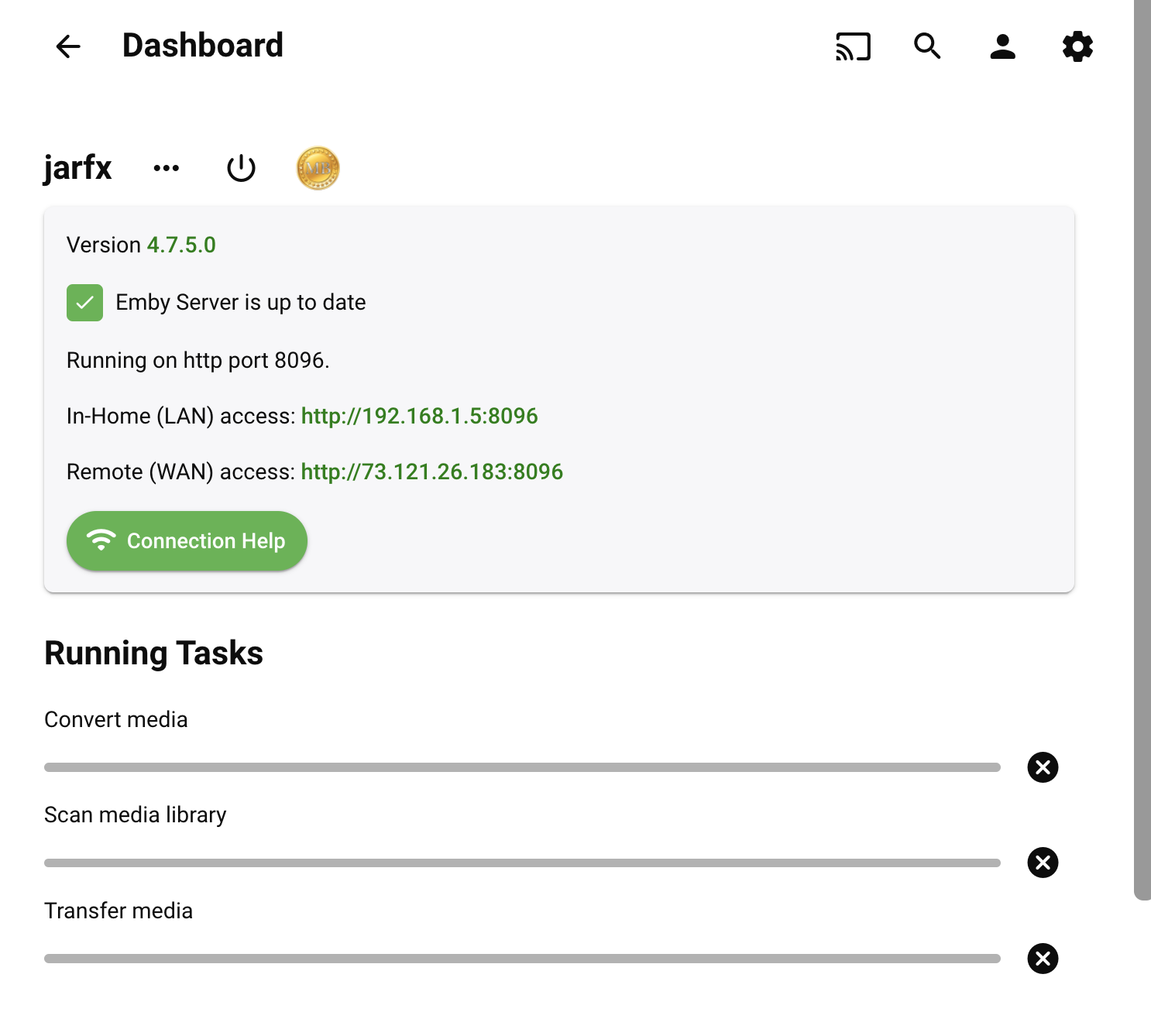

BJ1983tn 0 Posted August 2, 2022 Author Posted August 2, 2022 (edited) With zypper. They install, but without a signature, the security of the package is iffy. This morning it is still at 90.1%, Many many files have been ingested, but my Music is still blank. Edited August 2, 2022 by Happy2Play removed external address
BJ1983tn 0 Posted August 2, 2022 Author Posted August 2, 2022 Todays log shows no activity, and it is still sitting at the same place as above picture: 2022-08-02 00:00:00.001 Info App: Application version: 4.7.6.0 2022-08-02 00:00:00.001 Info App: Emby Command line: /opt/emby-server/system/EmbyServer.dll -programdata /var/lib/emby -ffdetect /opt/emby-server/bin/ffdetect -ffmpeg /opt/emby-server/bin/ffmpeg -ffprobe /opt/emby-server/bin/ffprobe -restartexitcode 3 -updatepackage emby-server-rpm_{version}_x86_64.rpm Operating system: Linux version 5.14.21-150400.24.11-default (geeko@buildhost) (gcc (SUSE Linux) 7.5.0, GNU ld (GNU Binutils; SUSE Linux Enterprise 15) 2.37.20211103-15 Framework: .NET 6.0.2 OS/Process: x64/x64 Runtime: opt/emby-server/system/System.Private.CoreLib.dll Processor count: 8 Data path: /var/lib/emby Application path: /opt/emby-server/system 2022-08-02 00:00:00.001 Info App: Logs path: /var/lib/emby/logs 2022-08-02 00:00:00.001 Info App: Cache path: /var/lib/emby/cache 2022-08-02 00:00:00.001 Info App: Internal metadata path: /var/lib/emby/metadata 2022-08-02 00:00:00.001 Info App: Transcoding temporary files path: /var/lib/emby/transcoding-temp 2022-08-02 00:00:00.001 Info App: Plugins: Bluray Folder Support 1.0.0.0 Cinema Intros 1.0.40.0 Dlna 1.0.85.0 Dvd Folder Support 1.0.0.0 Emby Guide Data 1.0.7.0 Fanart.tv 1.0.13.0 M3U TV Tuner 1.0.13.0 MovieDb 1.6.1.0 MusicBrainz 1.0.18.0 Nfo Metadata 1.0.69.0 OMDb 1.0.18.0 Open Subtitles 1.0.31.0 Port Mapper 1.1.8.0 Studio Images 1.0.3.0 TheAudioDb 1.0.15.0 TheTVDB 1.3.1.0 Webhooks 1.0.19.0 XmlTV 1.0.8.0 2022-08-02 08:23:27.055 Info Server: http/2 POST https://192.168.1.5:8920/emby/Library/VirtualFolders/LibraryOptions?X-Emby-Client=Emby Web&X-Emby-Device-Name=Microsoft Edge macOS&X-Emby-Device-Id=1d4e264e-eebf-4f89-8e7a-ab405ef73b6e&X-Emby-Client-Version=4.7.6.0&reqformat=json. UserAgent: Mozilla/5.0 (Macintosh; Intel Mac OS X 10_15_7) AppleWebKit/537.36 (KHTML, like Gecko) Chrome/105.0.0.0 Safari/537.36 Edg/105.0.1329.1 2022-08-02 11:10:49.147 Error Server: Access token is invalid or expired. 2022-08-02 11:10:49.187 Info Server: http/1.1 POST http://192.168.1.5:8096/emby/Sync/data. UserAgent: okhttp/4.9.2 2022-08-02 11:10:49.188 Error Server: Access token is invalid or expired. 2022-08-02 11:10:49.188 Info Server: http/1.1 Response 401 to host2. Time: 2ms. http://192.168.1.5:8096/emby/Sync/data 2022-08-02 11:10:59.189 Info Server: http/1.1 POST http://192.168.1.5:8096/emby/Sync/data. UserAgent: okhttp/4.9.2 2022-08-02 11:27:14.745 Error Server: Access token is invalid or expired. 2022-08-02 11:27:15.526 Info Server: http/1.1 POST http://192.168.1.5:8096/emby/Sync/data. UserAgent: okhttp/4.9.2 2022-08-02 11:27:15.527 Error Server: Access token is invalid or expired. 2022-08-02 11:27:15.527 Info Server: http/1.1 Response 401 to host2. Time: 1ms. http://192.168.1.5:8096/emby/Sync/data 2022-08-02 11:10:49.187 Info Server: http/1.1 POST http://192.168.1.5:8096/emby/Sync/data. UserAgent: okhttp/4.9.2 2022-08-02 11:10:49.188 Error Server: Access token is invalid or expired. 2022-08-02 11:10:49.188 Info Server: http/1.1 Response 401 to host2. Time: 2ms. http://192.168.1.5:8096/emby/Sync/data 2022-08-02 11:10:59.189 Info Server: http/1.1 POST http://192.168.1.5:8096/emby/Sync/data. UserAgent: okhttp/4.9.2 2022-08-02 11:27:14.745 Error Server: Access token is invalid or expired. 2022-08-02 11:27:15.526 Info Server: http/1.1 POST http://192.168.1.5:8096/emby/Sync/data. UserAgent: okhttp/4.9.2 2022-08-02 11:27:15.527 Error Server: Access token is invalid or expired. 2022-08-02 11:27:15.527 Info Server: http/1.1 Response 401 to host2. Time: 1ms. http://192.168.1.5:8096/emby/Sync/data 2022-08-02 11:27:24.792 Info Server: http/1.1 POST http://192.168.1.5:8096/emby/Sync/data. UserAgent: okhttp/4.9.2 2022-08-02 11:43:16.025 Error Server: Access token is invalid or expired. 2022-08-02 11:43:17.181 Info Server: http/1.1 POST http://192.168.1.5:8096/emby/Sync/data. UserAgent: okhttp/4.9.2 2022-08-02 11:43:17.182 Error Server: Access token is invalid or expired. 2022-08-02 11:43:17.182 Info Server: http/1.1 Response 401 to host2. Time: 1ms. http://192.168.1.5:8096/emby/Sync/data 2022-08-02 11:43:26.073 Info Server: http/1.1 POST http://192.168.1.5:8096/emby/Sync/data. UserAgent: okhttp/4.9.2 2022-08-02 11:58:45.096 Error Server: Access token is invalid or expired. 2022-08-02 11:58:45.824 Info Server: http/1.1 POST http://192.168.1.5:8096/emby/Sync/data. UserAgent: okhttp/4.9.2 2022-08-02 11:58:45.824 Error Server: Access token is invalid or expired. 2022-08-02 11:58:45.824 Info Server: http/1.1 Response 401 to host2. Time: 1ms. http://192.168.1.5:8096/emby/Sync/data 2022-08-02 11:58:55.140 Info Server: http/1.1 POST http://192.168.1.5:8096/emby/Sync/data. UserAgent: okhttp/4.9.2 2022-08-02 12:14:40.515 Error Server: Access token is invalid or expired. 2022-08-02 12:14:40.541 Info Server: http/1.1 POST http://192.168.1.5:8096/emby/Sync/data. UserAgent: okhttp/4.9.2 2022-08-02 12:14:40.541 Error Server: Access token is invalid or expired. 2022-08-02 12:14:40.541 Info Server: http/1.1 Response 401 to host2. Time: 1ms. http://192.168.1.5:8096/emby/Sync/data 2022-08-02 12:14:50.559 Info Server: http/1.1 POST http://192.168.1.5:8096/emby/Sync/data. UserAgent: okhttp/4.9.2 2022-08-02 12:30:33.636 Error Server: Access token is invalid or expired. 2022-08-02 12:30:33.745 Info Server: http/1.1 POST http://192.168.1.5:8096/emby/Sync/data. UserAgent: okhttp/4.9.2 2022-08-02 12:30:33.745 Error Server: Access token is invalid or expired. 2022-08-02 12:30:33.745 Info Server: http/1.1 Response 401 to host2. Time: 1ms. http://192.168.1.5:8096/emby/Sync/data 2022-08-02 12:30:43.012 Info Server: http/1.1 POST http://192.168.1.5:8096/emby/Sync/data. UserAgent: okhttp/4.9.2 2022-08-02 12:46:23.055 Error Server: Access token is invalid or expired. 2022-08-02 12:46:23.076 Info Server: http/1.1 POST http://192.168.1.5:8096/emby/Sync/data. UserAgent: okhttp/4.9.2 2022-08-02 12:46:23.077 Error Server: Access token is invalid or expired. 2022-08-02 12:46:23.077 Info Server: http/1.1 Response 401 to host2. Time: 1ms. http://192.168.1.5:8096/emby/Sync/data 2022-08-02 12:46:33.098 Info Server: http/1.1 POST http://192.168.1.5:8096/emby/Sync/data. UserAgent: okhttp/4.9.2 2022-08-02 13:03:26.398 Error Server: Access token is invalid or expired. 2022-08-02 13:03:26.417 Info Server: http/1.1 POST http://192.168.1.5:8096/emby/Sync/data. UserAgent: okhttp/4.9.2 2022-08-02 13:03:26.418 Error Server: Access token is invalid or expired. 2022-08-02 13:03:26.418 Info Server: http/1.1 Response 401 to host2. Time: 1ms. http://192.168.1.5:8096/emby/Sync/data 2022-08-02 13:03:36.444 Info Server: http/1.1 POST http://192.168.1.5:8096/emby/Sync/data. UserAgent: okhttp/4.9.2 2022-08-02 13:09:17.383 Info HttpClient: GET https://api.github.com/repos/MediaBrowser/Emby.Releases/releases 2022-08-02 13:09:17.626 Info HttpClient: GET https://www.mb3admin.com/admin/service/EmbyPackages.json 2022-08-02 15:36:38.769 Error Server: Access token is invalid or expired. 2022-08-02 15:36:39.511 Info Server: http/1.1 POST http://192.168.1.5:8096/emby/Sync/data. UserAgent: okhttp/4.9.2 2022-08-02 15:36:39.512 Error Server: Access token is invalid or expired. 2022-08-02 15:36:39.512 Info Server: http/1.1 Response 401 to host2. Time: 1ms. http://192.168.1.5:8096/emby/Sync/data 2022-08-02 15:36:48.825 Info Server: http/1.1 POST http://192.168.1.5:8096/emby/Sync/data. UserAgent: okhttp/4.9.2

BJ1983tn 0 Posted August 4, 2022 Author Posted August 4, 2022 (edited) here they are. Same status today. The Music folder now has pictures on it, but is blank if I open it. I rebooted the server machine too. alllogs.zip Edited August 4, 2022 by BJ1983tn
Luke 42245 Posted August 11, 2022 Posted August 11, 2022 Hi, the log does show that it is busy scanning new audio files. Can you try just waiting for the scan to finish? The first scan can take a long time as it is probing all of your audio files for media info. Once you get through that, subsequent scans should be much quicker.
