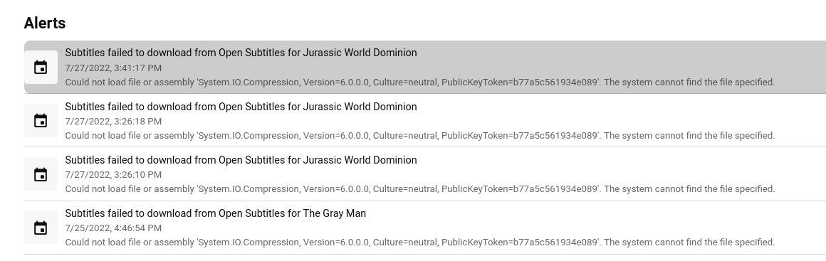

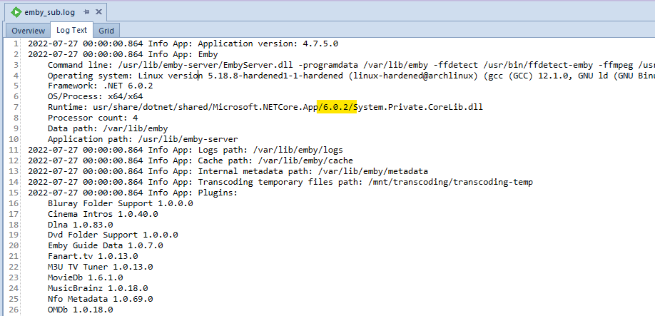

Utini 14 Posted July 28, 2022 Posted July 28, 2022 I am running latest emby on Arch with the LG emby app on my TV. I can suddenly not download any subtitles and also subtitles from movie files aren't displayed in the emby LG app. Attached is the emby log. emby_sub.log
Utini 14 Posted July 28, 2022 Author Posted July 28, 2022 Here is a screenshot from the dashboard alert.
Utini 14 Posted July 28, 2022 Author Posted July 28, 2022 1 minute ago, Luke said: Hi, how exactly did you install Emby Server? Well, basically according to the wiki: https://wiki.archlinux.org/title/Emby It has worked so far as well and I didn't re-install or change anything.
softworkz 5133 Posted July 30, 2022 Posted July 30, 2022 On 7/28/2022 at 8:55 PM, Utini said: I can suddenly not download any subtitles Which version did you have before where this error didn't happen?
Utini 14 Posted July 30, 2022 Author Posted July 30, 2022 probably just one version before the current arch package which was updated on 30.06.22.
softworkz 5133 Posted July 30, 2022 Posted July 30, 2022 I'm not familiar with Arch. Maybe you can try to update the dotnet runtime package which seems to be at 6.0.2 on your system while 6.0.6 seems to be available. You could also check whether System.Drawing.Primitives.dll exists in the framework folder.
Utini 14 Posted July 30, 2022 Author Posted July 30, 2022 2 hours ago, softworkz said: I'm not familiar with Arch. Maybe you can try to update the dotnet runtime package which seems to be at 6.0.2 on your system while 6.0.6 seems to be available. You could also check whether System.Drawing.Primitives.dll exists in the framework folder. Hmm actually I am on 6.0.6 and the file exists as well :S
Utini 14 Posted July 30, 2022 Author Posted July 30, 2022 13 minutes ago, softworkz said: And yet 6.0.6 is installed. I re-installed it and did a reboot. It seems to work now. Really weird. Thanks for your effort!
softworkz 5133 Posted July 30, 2022 Posted July 30, 2022 23 minutes ago, Utini said: Thanks for your effort! You're welcome! Does it show 6.0.6 in the log now?
