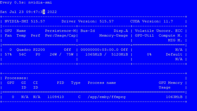

Ratatouille 14 Posted July 23, 2022 Author Posted July 23, 2022 Does not explain why is not working with emby/embyserver
