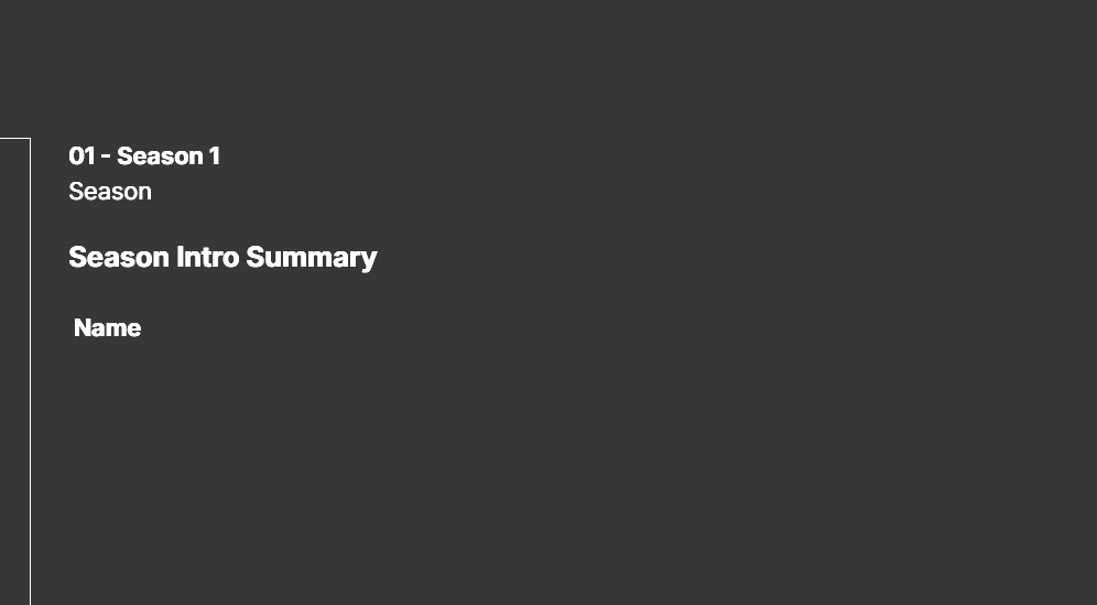

podonnell 48 Posted October 18, 2024 Posted October 18, 2024 On 9/13/2024 at 5:21 AM, TeamB said: go back one level to the season view. I have a series that auto detected 9 out of 10 episodes correctly, but my OCD wants to go back and fill in the first one. However, I am not seeing anything on the Season level... What is required to get this section to populate? I have perfect intro chapters in a specific episode showing up, but I just need to extract that chroma data... Thanks!
TeamB 2440 Posted October 18, 2024 Author Posted October 18, 2024 3 hours ago, podonnell said: I have a series that auto detected 9 out of 10 episodes correctly, but my OCD wants to go back and fill in the first one. However, I am not seeing anything on the Season level... What is required to get this section to populate? I have perfect intro chapters in a specific episode showing up, but I just need to extract that chroma data... Thanks! what server version?
podonnell 48 Posted October 19, 2024 Posted October 19, 2024 (edited) 8 hours ago, TeamB said: what server version? Version 4.8.10.0 Although, the built in intro detector likely ran when I added this media a month or two ago. Edited October 19, 2024 by podonnell
TeamB 2440 Posted October 19, 2024 Author Posted October 19, 2024 does it show any of your shows seasons or is it just some that are not showing up. I dont know why it is doing it for you.
ados8000 53 Posted October 20, 2024 Posted October 20, 2024 23 hours ago, podonnell said: Version 4.8.10.0 Although, the built in intro detector likely ran when I added this media a month or two ago. Maybe good old remove and reinstall?
podonnell 48 Posted October 21, 2024 Posted October 21, 2024 On 10/19/2024 at 4:53 AM, TeamB said: does it show any of your shows seasons or is it just some that are not showing up. I dont know why it is doing it for you. It looks like I have a vast number of seasons that show nothing. I do have some that have populated the data, and I've been able to go to some seasons and extract the json file and apply it to the season as a whole. However it seems like more than half of my content does not show anything at the season level. Is there a chance this is tied to chapters not being present? I didn't see if the shows I looked at had that data or not, just trying to think of a cause.
TeamB 2440 Posted October 22, 2024 Author Posted October 22, 2024 It should still work with no chapters at all Bring up the Browser console (hit f12) and look in the console output tab for any errors. Also have a look in the Emby Server log for any errors.
podonnell 48 Posted October 22, 2024 Posted October 22, 2024 11 hours ago, TeamB said: It should still work with no chapters at all Bring up the Browser console (hit f12) and look in the console output tab for any errors. Also have a look in the Emby Server log for any errors. No errors in developer console, and not seeing anything jumping out in emby server log. I would presume it would be around this part: > 2024-10-22 12:51:26.868 Info ChapterApi - ChapterApiEndpoint: ChapterApi - ChapterApiEndpoint Loaded 2024-10-22 12:51:28.853 Info ChapterApi - ChapterApiEndpoint: ChapterApi - ChapterApiEndpoint Loaded 2024-10-22 12:51:29.428 Info ChapterApi - ChapterApiEndpoint: ChapterApi - ChapterApiEndpoint Loaded 2024-10-22 12:51:29.428 Info ChapterApi - ChapterApiEndpoint: Severance : Item Type(Series) 2024-10-22 12:51:29.429 Info ChapterApi - ChapterApiEndpoint: ChapterApi - ChapterApiEndpoint Loaded 2024-10-22 12:51:29.429 Info ChapterApi - ChapterApiEndpoint: GetItemPath 2024-10-22 12:51:29.429 Info ChapterApi - ChapterApiEndpoint: GetCollectionFolders: Series(13972,False) 2024-10-22 12:51:29.429 Info ChapterApi - ChapterApiEndpoint: AddingPathItem: Severance(13972,False,True) 2024-10-22 12:51:29.429 Info ChapterApi - ChapterApiEndpoint: TopParentItem: Series(6,True,True) 2024-10-22 12:51:29.429 Info ChapterApi - ChapterApiEndpoint: AddingCollectionItem:Series(5,False,True) 2024-10-22 12:51:29.429 Info ChapterApi - ChapterApiEndpoint: ChapterApi - ChapterApiEndpoint Loaded 2024-10-22 12:51:30.320 Info ChapterApi - ChapterApiEndpoint: ChapterApi - ChapterApiEndpoint Loaded Isn't there a job I need to run for it to detect intros or something? "Process New Episodes" ? I typically use the built-in editor. I'm guessing perhaps the ones I've worked with in the past have had chapters built in to the files. Whereas all the ones I'm looking at now do not. Is there a way I can run the analyze just on a single series? I don't believe there's a way to edit Emby's built-in intro detector.
TeamB 2440 Posted October 22, 2024 Author Posted October 22, 2024 Sorry, I don't know what is going on. Unfortunately there are no docs on how to use the plugin, there are a few short hints in the first post put apart from that it's trial and error for a user. I don't think many people are using this plugin any longer, or even initially, I wrote it as a way to put a bunch of research I had done arround audio fingerprinting into practice and work on a way to target episodes. Technically I think it is a superior approach to the built-in one however it does require more from a user to set it up. I would say just delete the plugin and move on with your life. 1
rbjtech 5345 Posted October 23, 2024 Posted October 23, 2024 9 hours ago, TeamB said: I don't think many people are using this plugin any longer, or even initially, I wrote it as a way to put a bunch of research I had done arround audio fingerprinting into practice and work on a way to target episodes. Technically I think it is a superior approach to the built-in one however it does require more from a user to set it up. They are likely not using it for Detection agreed, but as it's the only method to edit existing detected Intro's on the core 'implementation' then I believe it's used a lot for that function. Agree on the superiority of the fingerprint detection method used, it had great possibilities to be used for 'Previously On' segments and all sorts of other hard to detect segments but as you say, without mass user involvement and contributions, it's effectiveness was limited.
podonnell 48 Posted October 23, 2024 Posted October 23, 2024 When I searched about a month back, there was certainly nothing like this. For me, the built-in detector works very well but just misses some episodes sometimes. I would love to know why the season view isn't working for most of my content, because it would be great to grab that fingerprint for easy fixes. But I'm also able to just add the IntroStart and IntroEnd chapters manually without too much trouble if it's just one or two episodes messed up.
TeamB 2440 Posted October 23, 2024 Author Posted October 23, 2024 6 hours ago, podonnell said: When I searched about a month back, there was certainly nothing like this. nothing like what? 7 hours ago, podonnell said: I would love to know why the season view isn't working for most of my content, if there are no errors then it has something to do with the actual media items in emby. you could try and work out what is different between them. i could look into it but the only way really is for me to get a copy of your emby server library.db file so i can see if i can replicate the issue. if you are ok with me having a copy of your emby lib file zip and pm it to me.
podonnell 48 Posted October 24, 2024 Posted October 24, 2024 (edited) On 10/23/2024 at 4:15 PM, TeamB said: nothing like what? if there are no errors then it has something to do with the actual media items in emby. you could try and work out what is different between them. i could look into it but the only way really is for me to get a copy of your emby server library.db file so i can see if i can replicate the issue. if you are ok with me having a copy of your emby lib file zip and pm it to me. 1) I meant nothing like this plugin that I could find. This one seemed to be cream of the crop at least. 2) I figured it out! I was not using season folders for my shows, so they were all lumped into a single folder. As soon as I moved a show into its own season folders, this lit up. Hopefully this helps someone in the future! Edited October 24, 2024 by podonnell
TeamB 2440 Posted October 25, 2024 Author Posted October 25, 2024 2 hours ago, podonnell said: 1) I meant nothing like this plugin that I could find. This one seemed to be cream of the crop at least. this plugin has been out for close to 2 years or so 2 hours ago, podonnell said: 2) I figured it out! I was not using season folders for my shows, so they were all lumped into a single folder. As soon as I moved a show into its own season folders, this lit up. Hopefully this helps someone in the future! The plugin uses a lot of "ParentID" and ParentContainer logic so that might be causing issues in the internal queries. I don't use flat structures (i.e. everything in the same dir) so I would not have tested that when creating the plugin. Glad you identified the reason.

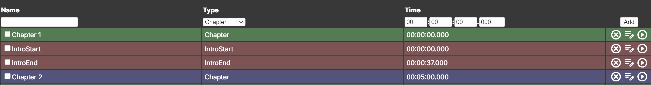

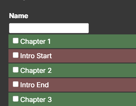

Jutsch80 13 Posted November 14, 2024 Posted November 14, 2024 Am I overlooking something or is there no way to actually edit chapters (for example the intro times) and the only option is to create new chapters and delete the old ones which sounds super tedious if having to be done for many episodes. For example the core intro detection basically detected all the intros of the second season of the office wrong. Third season seems to work again but it would be nice to at least edit the times it created 1
rbjtech 5345 Posted November 14, 2024 Posted November 14, 2024 (edited) Agreed - editing intro chapters is a little tedious - especially vs the original Introskip plugin where you could just overwrite the value. You could also clear a seasons or an entire shows intros on the click of a button (and of course you could do the same with credits as it detected those too) .. After years of the original Introskip core feature 'replacing' the plugin, these simple but time saving features have never been implemented - a real shame imo. btw - without the Chapter API from a 3rd party - you would not be able to edit the Intro's at all ! Edited November 14, 2024 by rbjtech 2
