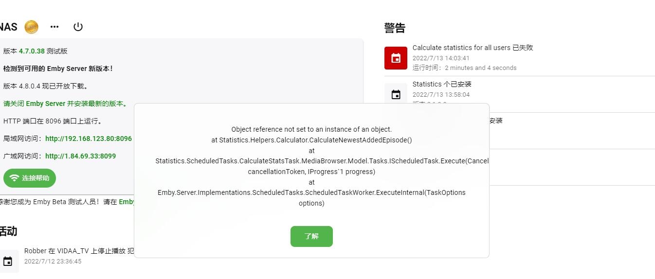

Solution Robber 3 Posted July 13, 2022 Solution Posted July 13, 2022 Plugin version:2.1.3.0 Emby version:4.7.0.38 Server OS:Synology DS918+ 7.1-42661 Client browser:Google Chrome 103.0.5060.114 前几天使用还正常 每24小时更新扫描一次 最近几天就出问题了
hackthis02 130 Posted July 13, 2022 Posted July 13, 2022 Can you post your emby.log file? With debug logging enable if possiable.

Robber 3 Posted July 14, 2022 Author Posted July 14, 2022 7 hours ago, hackthis02 said: 您可以发布您的 emby.log 文件吗?如果可能,启用调试日志记录。 是这个么 embyserver.txt
hackthis02 130 Posted July 14, 2022 Posted July 14, 2022 It looks like you have an issue with a few of your series. The plugin can't find the TVDB JSON file. Try refreshing the metadata on them.
Robber 3 Posted July 16, 2022 Author Posted July 16, 2022 On 7/14/2022 at 1:49 PM, hackthis02 said: It looks like you have an issue with a few of your series. The plugin can't find the TVDB JSON file. Try refreshing the metadata on them. 按照你说的这个可能性 试着删除了无效信息后就正常了 确实和这个有关系 感谢 1
