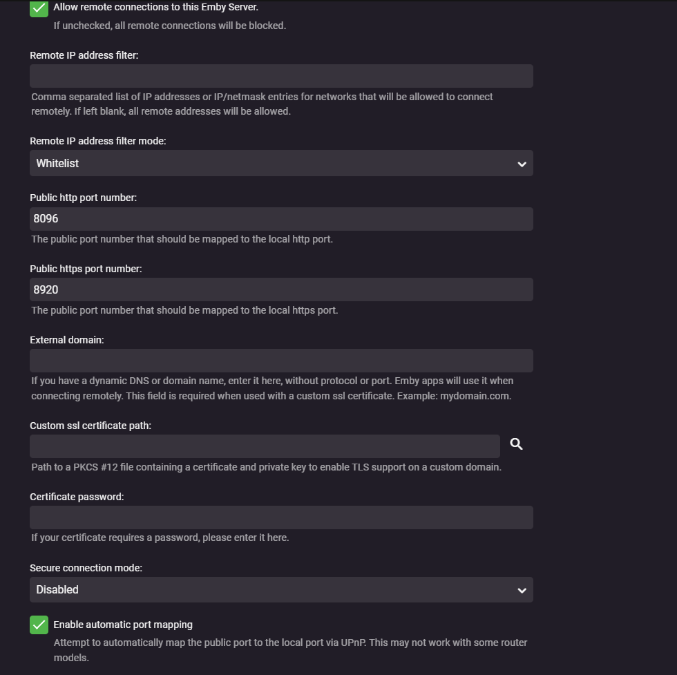

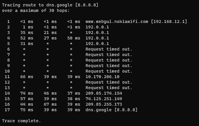

zeyno 0 Posted July 13, 2022 Author Posted July 13, 2022 (edited) Alright so, I start with remote access, both of them are checked, and I cannot enable uPnP from my router. I might have to talk to a T-Mobile rep about that. Next up, port forwarding, can't do that either. My router doesn't give me a lot of customization options. Under Verify Public IP and Port it says, "If it doesn't remote access will not work and likely your ISP is using CG-NAT and you are blocked from running services. In this case visit our forums for assistance." I have turned off my VPN, (for now) and have run tracert 8.8.8.8 and lines 2-5 use 192 as the first number, and it also says "What you want to see is if any of the next 3 or 4 lines start with 10., 192. or 172. If the first number is a 172 we need to check the second number to see if it's between 16 to 31. If any of these returned lines matches this you are likely being blocked by your ISP." Edited July 13, 2022 by zeyno
zeyno 0 Posted July 13, 2022 Author Posted July 13, 2022 5 minutes ago, zeyno said: Alright so, I start with remote access, both of them are checked, and I cannot enable uPnP from my router. I might have to talk to a T-Mobile rep about that. Next up, port forwarding, can't do that either. My router doesn't give me a lot of customization options. Under Verify Public IP and Port it says, "If it doesn't remote access will not work and likely your ISP is using CG-NAT and you are blocked from running services. In this case visit our forums for assistance." I have turned off my VPN, (for now) and have run tracert 8.8.8.8 and lines 2-5 use 192 as the first number, and it also says "What you want to see is if any of the next 3 or 4 lines start with 10., 192. or 172. If the first number is a 172 we need to check the second number to see if it's between 16 to 31. If any of these returned lines matches this you are likely being blocked by your ISP." A Remote IP does show up, but it is not the same as it should be on canyouseeme.org, and even when I do try port 8096, it times out.

mohoelx 12 Posted July 15, 2022 Posted July 15, 2022 Actually, the only way it works is using some sort of VPN (I use Tailscale) to access your Emby remotely. Don't know specifically about using Emby Connect, but TMHI is IPV6 only on the public side, and it is rapidly changed, and there is absolutely no IPV4 port forwarding that can be configured in the TMHI router. Frustrating, but there's a LOT of apps that have a lot of retooling to go through in order to work natively on IPV6.
jorr@entofga.com 5 Posted May 2, 2023 Posted May 2, 2023 I had the same issue with T-Mobile Home Internet and discovered it is the carrier-grade NAT used by T-Mobile. Emby Connect didn't work for me , either. A reverse proxy program like LocalXpose or a VPN that allows port forwarding like PureVPN work. My other problem is that I have Emby on my QNAP NAS and I need to learn more about Linux. Unfortunately, until I learn more, I have converted to using PLEX, which does NOT have this problem when using their cloud-connect. I like Emby better and I wish Emby could correct this. Lastly, I just found out that T-Mobile has a Business Internet Router, the Inseego Wavemaker FX2000 5g Indoor Router that can port-forward! I am "negotiating" with T-Mobile to see if they will swap-out my Sagecom Router for this one. Inseego Wavemaker FX2000 5g Indoor Router Brochure.pdf
