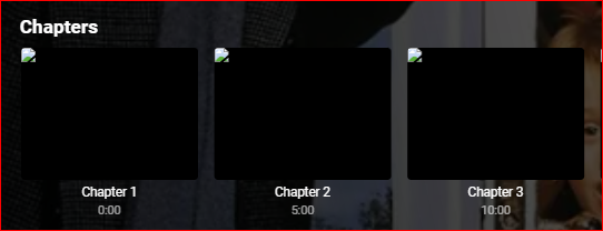

justinrh 264 Posted July 13, 2022 Author Posted July 13, 2022 This is what happened after I deleted the BIF. Will this correct itself?
Happy2Play 9800 Posted July 13, 2022 Posted July 13, 2022 Not positive if you have to Refresh the media or just scan. But this is common across the board as the database is still looking for the previous files you deleted.
Solution justinrh 264 Posted July 13, 2022 Author Solution Posted July 13, 2022 3 hours ago, justinrh said: thumbnails as if I never ever had them? So the answer to this question is: Disable thumbnails in the library, then delete all the BIFs for the affected library (not easy if using the default storage location), then refresh the metadata. Now I know more than the Emby folks 1
