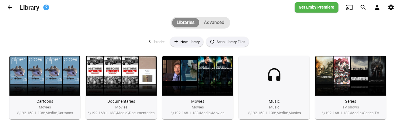

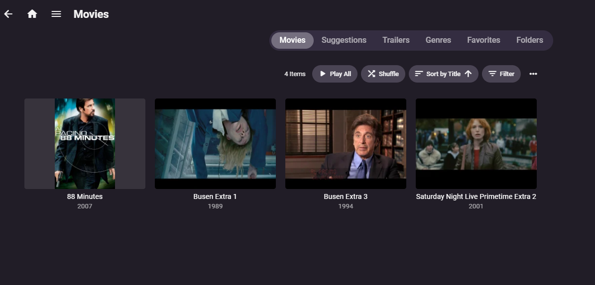

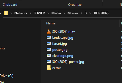

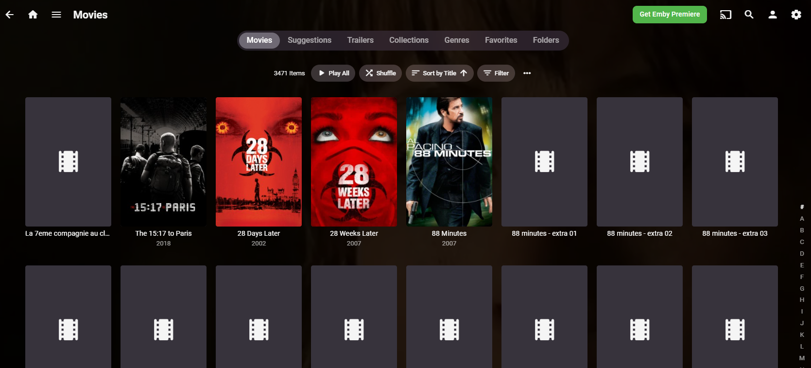

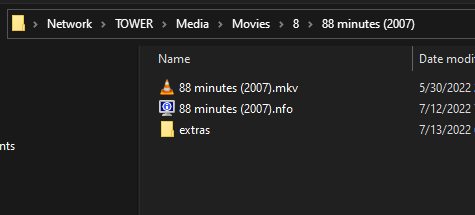

zfrenchy 12 Posted July 12, 2022 Posted July 12, 2022 Hi everyone, I update my UNRAID server, then after that Emby cannot works, I uninstalled Emby then installed, but now it's a mess. here is a screenshot of movies main page in primary mode then a screenshot of my files organization (for 300 movie) I think it's something wrong on the settings of Emby, but I cannot find'it.
zfrenchy 12 Posted July 12, 2022 Author Posted July 12, 2022 May be something left over while uninstalling emby ?????

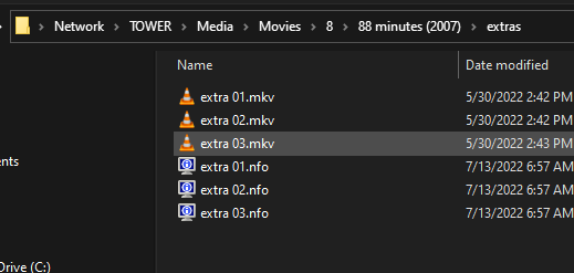

zfrenchy 12 Posted July 12, 2022 Author Posted July 12, 2022 may be an important info ... Like the movie "88 minutes", I have an "extras" folder, files insides are names "extra 01.mkv, extra 02.mkv ...". at the Emby page of "88 minutes" movie, nothing appear about extras.
chef 3811 Posted July 12, 2022 Posted July 12, 2022 25 minutes ago, zfrenchy said: yes I did, multiple time. Can I delete the Db then run a scan again ? I wouldn't delete it yet. What happens if you refresh metadata on the movie 88 minutes? Click the three dots and select "refresh metadata"
zfrenchy 12 Posted July 12, 2022 Author Posted July 12, 2022 same, nothing change, still not extras on the page of the movie If I display in EMBY by folder, I see folder "8", then folder "88 minutes" with the movie inside AND THE "extras" folder, but inside the "extras" folder are files from other movies, not "88 minutes" Looks like the Db is completely broken, no ?

zfrenchy 12 Posted July 12, 2022 Author Posted July 12, 2022 I move all movies to a temporary folder, only 88 minutes is in the Movies folder, with the extra folder inside.

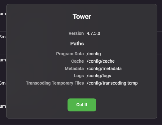

Happy2Play 9800 Posted July 12, 2022 Posted July 12, 2022 8 minutes ago, zfrenchy said: under /mnt/cache/appdata - binhex-emby - cache - config - data - logs - metadata - plugins - root - transcoding-temp - EmbyServer - cache - config - data - logs - metadata - plugins - root - transcoding-temp - emby (empty folder) - mariadb-official (empty folder) There is a definite installation issue as two locations should not exist. So one of these replaced the other. Would need to see a server log or click the three dot menu button next to power button on Emby Dashboard to see server info to know which folders are currently being used.

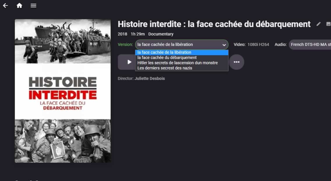

zfrenchy 12 Posted July 13, 2022 Author Posted July 13, 2022 Just saw another problem... I have a "documentaries" folder ... here is how the movie page show ... shows as version, not as movie, WEIRD !

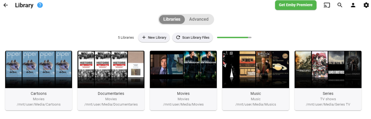

ebr 16307 Posted July 13, 2022 Posted July 13, 2022 Just now, zfrenchy said: shows as version, not as movie Hi. That is because your folder and file naming exactly match our convention for multi-versions. Remove the " - " from the file names and that should clear up. As for your extras, exactly how have you setup your libraries and what folders do they point to? Make sure you don't have multiple libraries pointing to the same items.

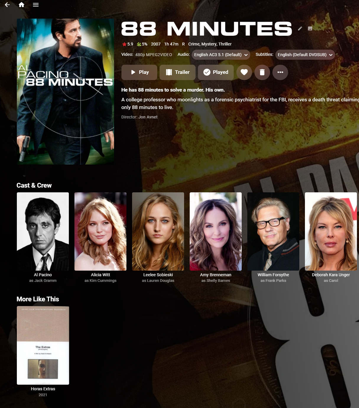

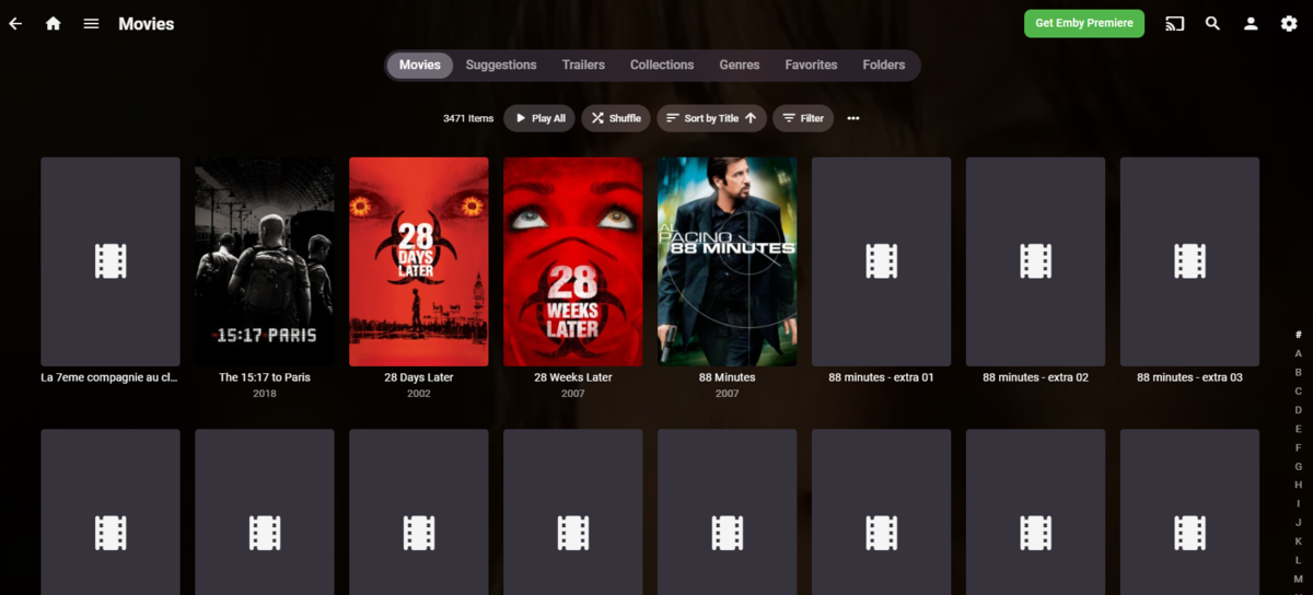

zfrenchy 12 Posted July 13, 2022 Author Posted July 13, 2022 here is how it is for the movie "88 minutes" here the extras folder here how it shows in main movie page, in emby here the page of the movie, no extras folder showing
Luke 42186 Posted July 13, 2022 Posted July 13, 2022 Instead of adding windows shares directly to emby server, what I would suggest instead is to mount the shares to local paths using docker or unRAID, and then add those local paths into emby server.
