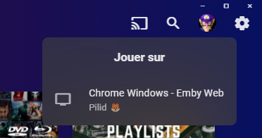

LazyMonday91 25 Posted July 12, 2022 Posted July 12, 2022 hello, I have a problem since the new update of the plugin DLNA , my TV is still clearly visible by emby and I still have sound control from the server but impossible to launch a file with dlan on the tv nothing came on the tv , i switch to the version before I have no problem with this version and return to stay at version 1.0.80.0 for the moment. hoping that you will help you for the next update, have a nice day

LazyMonday91 25 Posted July 12, 2022 Author Posted July 12, 2022 (edited) sorry @Luke missed the sujet , the problem encounter : Problems of multimedia reading with DLNA plugin nouvelle mise a jour The problem to highlight is for the tv modele: Panasonic TV model : TX-55GZ1500 Best Regards LazyMonday Edited July 12, 2022 by LazyMonday91
LazyMonday91 25 Posted July 12, 2022 Author Posted July 12, 2022 (edited) sorry @Luke missed the sujet , the problem encounter : Problems of multimedia reading with DLNA plugin new update my TV is still clearly visible and I still have sound control from the web server but impossible to launch a file to the tv Panasonic TV model : TX-55GZ1500 have a problem since the new update of the plugin Best Regards LazyMonday Edited July 12, 2022 by LazyMonday91

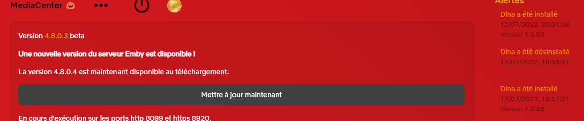

LazyMonday91 25 Posted July 12, 2022 Author Posted July 12, 2022 (edited) when returning to version 1.0.80.0 : all work fine, Edited July 12, 2022 by LazyMonday91
LazyMonday91 25 Posted July 12, 2022 Author Posted July 12, 2022 work with 1.0.83.0 now thanks you so much @Luke 1
LazyMonday91 25 Posted July 12, 2022 Author Posted July 12, 2022 Ok i notify the problem come from the new beta update of MB serveur 4.8.0.4 Best regard ! Lazymonday. 1
