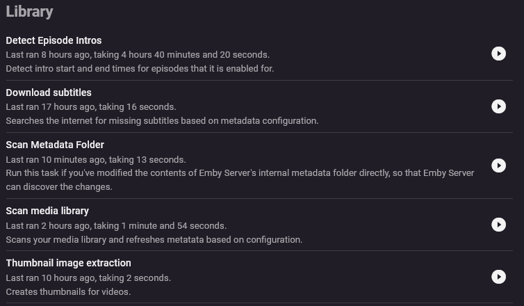

Luke 42289 Posted July 11, 2022 Posted July 11, 2022 OK now please run the detect episode intros scheduled task and then attach the server log when it completes. Thanks.
Gravis 2 Posted July 11, 2022 Author Posted July 11, 2022 ran it again. it only took a few seconds. first time took hours embyserver(2).txt

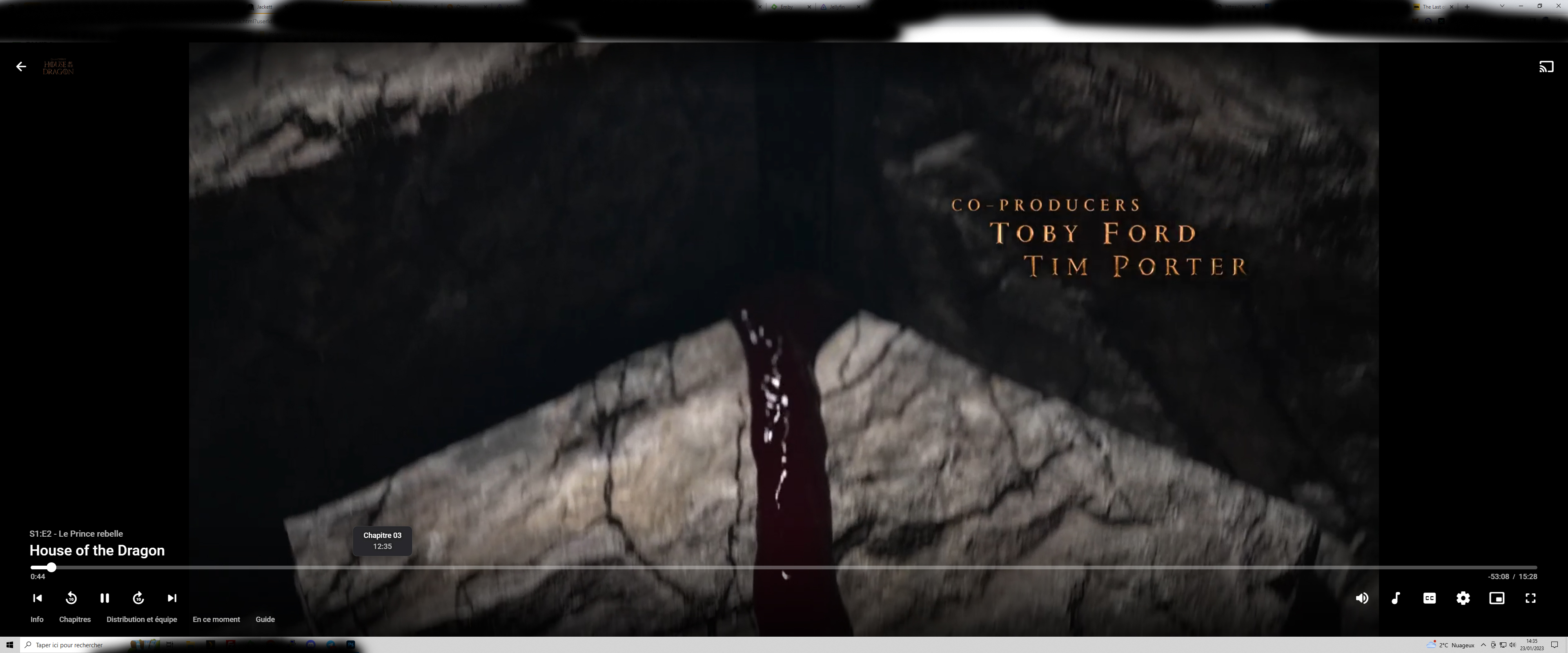

Bingegang 3 Posted January 23, 2023 Posted January 23, 2023 (edited) It sees ending credits, shows the chapters, but never the intros. Never saw that button since i'm using EMBY. If if's a metadata provider or something let me know. Also i have to identify most of the videos by myself. It make me movies in double, but they are not the same name. X (2022) it showed me an WWF movie. Had to identify by myself. Edited January 23, 2023 by Bingegang

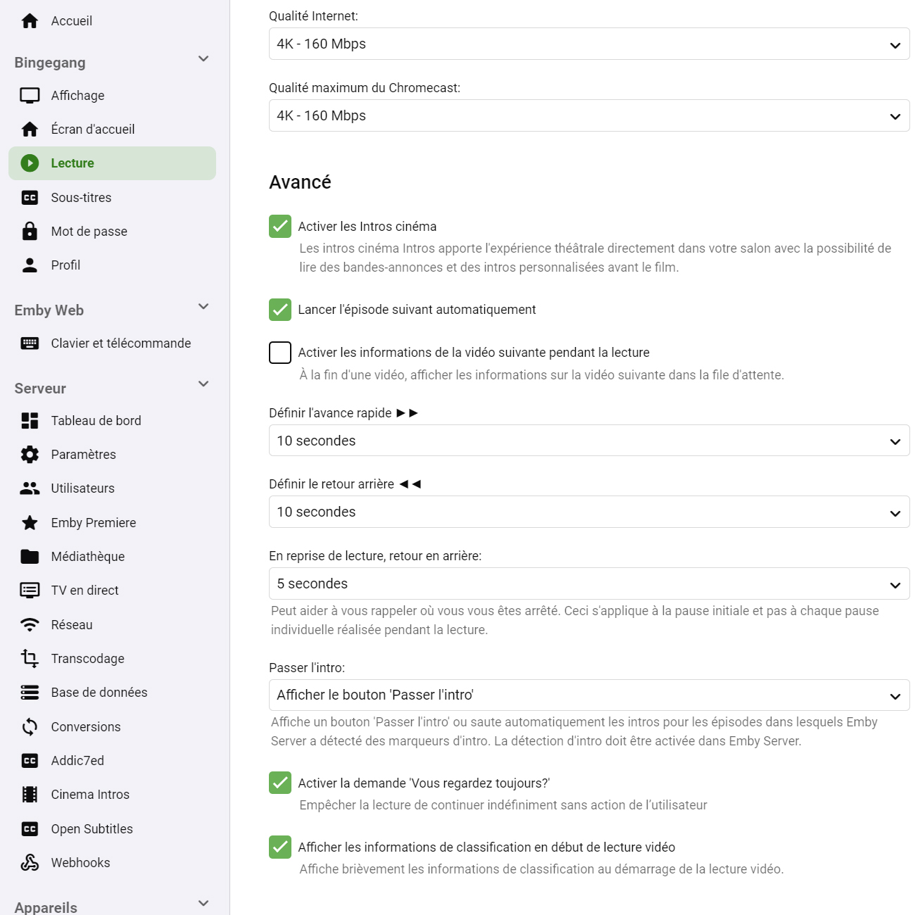

samuelqwe 317 Posted January 23, 2023 Posted January 23, 2023 2 hours ago, Bingegang said: It sees ending credits, shows the chapters, but never the intros. Never saw that button since i'm using EMBY. If if's a metadata provider or something let me know. Also i have to identify most of the videos by myself. It make me movies in double, but they are not the same name. X (2022) it showed me an WWF movie. Had to identify by myself. Have you enabled the intro marker detection in your TV shows library and run the task to detect the intros? 1
Bingegang 3 Posted January 23, 2023 Posted January 23, 2023 Going to take a look. Just saw the option to activate the intro skip. Now looking to make it search the intros to test it. Thanks. I'll let you know
