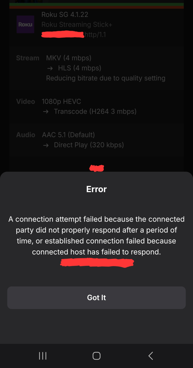

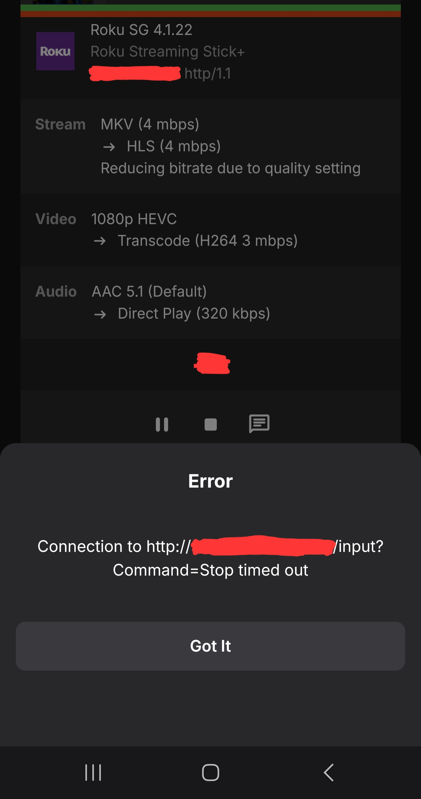

Fender1978 10 Posted June 12, 2024 Posted June 12, 2024 @LukeHi, I'm so sorry to revive an old thread but this is the exact issue I'm having in 2024 with the latest Emby Server for Windows (v4.8.8.0). I can't stop/remove streams that have lost connection and would like to be able to remove the old stream from the server instead of it hanging there as the stop button doesn't work with a disconnected device. Any advice appreciated. Images attached of when I hit the stop button.
Luke 42184 Posted June 12, 2024 Posted June 12, 2024 44 minutes ago, Fender1978 said: @LukeHi, I'm so sorry to revive an old thread but this is the exact issue I'm having in 2024 with the latest Emby Server for Windows (v4.8.8.0). I can't stop/remove streams that have lost connection and would like to be able to remove the old stream from the server instead of it hanging there as the stop button doesn't work with a disconnected device. Any advice appreciated. Images attached of when I hit the stop button. Hi, generally Roku cannot be remote controlled over a remote connection. If the user has stopped playing then the server will automatically remove the connection. There is nothing you need to do. Have they stopped playing?
Fender1978 10 Posted June 12, 2024 Posted June 12, 2024 (edited) 11 minutes ago, Luke said: Hi, generally Roku cannot be remote controlled over a remote connection. If the user has stopped playing then the server will automatically remove the connection. There is nothing you need to do. Have they stopped playing? Gotcha. It appears that they have reached the end of the show (you can see the stream and transcode bars) but the steam just sits there in limbo and I'm unable to remove it. It's been on my dashboard for hours doing nothing. Edited June 12, 2024 by Fender1978

Happy2Play 9798 Posted June 13, 2024 Posted June 13, 2024 (edited) Actually, I guess it issue was before that transcode log and in session 2d2aebf0f3bedad0710ae7323f55fa87. 2024-06-13 07:28:52.262 Info Server: http/1.1 POST http://192.168.1.12:8096/emby/Sessions/2d2aebf0f3bedad0710ae7323f55fa87/Playing/Stop?X-Emby-Client=Emby for Android&X-Emby-Device-Name=SM-S908B&X-Emby-Device-Id=03021881f75a702d&X-Emby-Client-Version=3.3.95&X-Emby-Token=x_secret3_x&X-Emby-Language=en-gb. UserAgent: Mozilla/5.0 (Linux; Android 14; SM-S908B Build/UP1A.231005.007; wv) AppleWebKit/537.36 (KHTML, like Gecko) Version/4.0 Chrome/125.0.6422.165 Mobile Safari/537.36 2024-06-13 07:28:52.263 Info HttpClient: POST http://WANADDRESS:8060/input?Command=Stop 2024-06-13 07:29:06.789 Error HttpClient: Connection to http://WANADDRESS:8060/input?Command=Stop timed out 2024-06-13 07:29:06.790 Error Server: Error processing request *** Error Report *** Version: 4.8.8.0 Command line: C:\Emby-Server\system\EmbyServer.dll -noautorunwebapp Operating system: Microsoft Windows 10.0.20348 Framework: .NET 6.0.30 OS/Process: x64/x64 Runtime: C:/Emby-Server/system/System.Private.CoreLib.dll Processor count: 8 Data path: C:\Emby-Server\programdata Application path: C:\Emby-Server\system MediaBrowser.Model.Net.HttpException: MediaBrowser.Model.Net.HttpException: Connection to http://WANADDRESS:8060/input?Command=Stop timed out ---> System.Threading.Tasks.TaskCanceledException: The request was canceled due to the configured HttpClient.Timeout of 20 seconds elapsing. ---> System.TimeoutException: A task was canceled. ---> System.Threading.Tasks.TaskCanceledException: A task was canceled. at System.Threading.Tasks.TaskCompletionSourceWithCancellation`1.WaitWithCancellationAsync(CancellationToken cancellationToken) at System.Net.Http.HttpConnectionPool.GetHttp11ConnectionAsync(HttpRequestMessage request, Boolean async, CancellationToken cancellationToken) at System.Net.Http.HttpConnectionPool.SendWithVersionDetectionAndRetryAsync(HttpRequestMessage request, Boolean async, Boolean doRequestAuth, CancellationToken cancellationToken) at System.Net.Http.DiagnosticsHandler.SendAsyncCore(HttpRequestMessage request, Boolean async, CancellationToken cancellationToken) at System.Net.Http.RedirectHandler.SendAsync(HttpRequestMessage request, Boolean async, CancellationToken cancellationToken) at System.Net.Http.DecompressionHandler.SendAsync(HttpRequestMessage request, Boolean async, CancellationToken cancellationToken) at System.Net.Http.HttpClient.<SendAsync>g__Core|83_0(HttpRequestMessage request, HttpCompletionOption completionOption, CancellationTokenSource cts, Boolean disposeCts, CancellationTokenSource pendingRequestsCts, CancellationToken originalCancellationToken) --- End of inner exception stack trace --- --- End of inner exception stack trace --- at System.Net.Http.HttpClient.HandleFailure(Exception e, Boolean telemetryStarted, HttpResponseMessage response, CancellationTokenSource cts, CancellationToken cancellationToken, CancellationTokenSource pendingRequestsCts) at System.Net.Http.HttpClient.<SendAsync>g__Core|83_0(HttpRequestMessage request, HttpCompletionOption completionOption, CancellationTokenSource cts, Boolean disposeCts, CancellationTokenSource pendingRequestsCts, CancellationToken originalCancellationToken) at Emby.Server.Implementations.HttpClientManager.CoreHttpClientManager.SendAsyncInternal(HttpRequestOptions options, String httpMethod) --- End of inner exception stack trace --- at Emby.Server.Implementations.HttpClientManager.CoreHttpClientManager.SendAsyncInternal(HttpRequestOptions options, String httpMethod) at Emby.Server.Implementations.HttpClientManager.CoreHttpClientManager.SendAsync(HttpRequestOptions options, String httpMethod) at Emby.Server.Implementations.Session.RokuSessionController.SendRequest(HttpRequestOptions options) at Emby.Server.Implementations.Session.RokuSessionController.SendMessage[T](ReadOnlyMemory`1 name, String messageId, T data, CancellationToken cancellationToken) at Emby.Server.Implementations.Session.SessionManager.SendMessageToSession[T](SessionInfo session, Boolean requireUserInterface, ReadOnlyMemory`1 name, T data, CancellationToken cancellationToken) at Emby.Server.Implementations.Services.ServiceController.GetTaskResult(Task task) at Emby.Server.Implementations.Services.ServiceHandler.ProcessRequestAsync(HttpListenerHost httpHost, IServerApplicationHost appHost, IRequest httpReq, IResponse httpRes, IStreamHelper streamHelper, RestPath restPath, String responseContentType, CancellationToken cancellationToken) at Emby.Server.Implementations.HttpServer.HttpListenerHost.RequestHandler(IRequest httpReq, ReadOnlyMemory`1 urlString, ReadOnlyMemory`1 localPath, CancellationToken cancellationToken) Source: Emby.Server.Implementations TargetSite: Void MoveNext() InnerException: System.Threading.Tasks.TaskCanceledException: The request was canceled due to the configured HttpClient.Timeout of 20 seconds elapsing. Source: System.Net.Http TargetSite: Void HandleFailure(System.Exception, Boolean, System.Net.Http.HttpResponseMessage, System.Threading.CancellationTokenSource, System.Threading.CancellationToken, System.Threading.CancellationTokenSource) at System.Net.Http.HttpClient.HandleFailure(Exception e, Boolean telemetryStarted, HttpResponseMessage response, CancellationTokenSource cts, CancellationToken cancellationToken, CancellationTokenSource pendingRequestsCts) at System.Net.Http.HttpClient.<SendAsync>g__Core|83_0(HttpRequestMessage request, HttpCompletionOption completionOption, CancellationTokenSource cts, Boolean disposeCts, CancellationTokenSource pendingRequestsCts, CancellationToken originalCancellationToken) at Emby.Server.Implementations.HttpClientManager.CoreHttpClientManager.SendAsyncInternal(HttpRequestOptions options, String httpMethod) InnerException: System.TimeoutException: A task was canceled. Source: TargetSite: InnerException: System.Threading.Tasks.TaskCanceledException: A task was canceled. Source: System.Private.CoreLib TargetSite: Void ThrowForNonSuccess(System.Threading.Tasks.Task) at System.Threading.Tasks.TaskCompletionSourceWithCancellation`1.WaitWithCancellationAsync(CancellationToken cancellationToken) at System.Net.Http.HttpConnectionPool.GetHttp11ConnectionAsync(HttpRequestMessage request, Boolean async, CancellationToken cancellationToken) at System.Net.Http.HttpConnectionPool.SendWithVersionDetectionAndRetryAsync(HttpRequestMessage request, Boolean async, Boolean doRequestAuth, CancellationToken cancellationToken) at System.Net.Http.DiagnosticsHandler.SendAsyncCore(HttpRequestMessage request, Boolean async, CancellationToken cancellationToken) at System.Net.Http.RedirectHandler.SendAsync(HttpRequestMessage request, Boolean async, CancellationToken cancellationToken) at System.Net.Http.DecompressionHandler.SendAsync(HttpRequestMessage request, Boolean async, CancellationToken cancellationToken) at System.Net.Http.HttpClient.<SendAsync>g__Core|83_0(HttpRequestMessage request, HttpCompletionOption completionOption, CancellationTokenSource cts, Boolean disposeCts, CancellationTokenSource pendingRequestsCts, CancellationToken originalCancellationToken) 2024-06-13 07:29:06.791 Info Server: http/1.1 Response 500 to host4. Time: 20002ms. POST http://192.168.1.12:8096/emby/Sessions/2d2aebf0f3bedad0710ae7323f55fa87/Playing/Stop?X-Emby-Client=Emby for Android&X-Emby-Device-Name=SM-S908B&X-Emby-Device-Id=03021881f75a702d&X-Emby-Client-Version=3.3.95&X-Emby-Token=x_secret3_x&X-Emby-Language=en-gb Edited June 15, 2024 by Happy2Play removed address
Fender1978 10 Posted June 13, 2024 Posted June 13, 2024 @Happy2PlayI honestly don't understand the logs very well but yes, the finished stream is just stuck on the dashboard. The Activity section says that the person has finished playing an item but the item just sits there on the dashboard with play progress marker at the end. I've only ever seen it happen before on transcoded items as this one is also.
