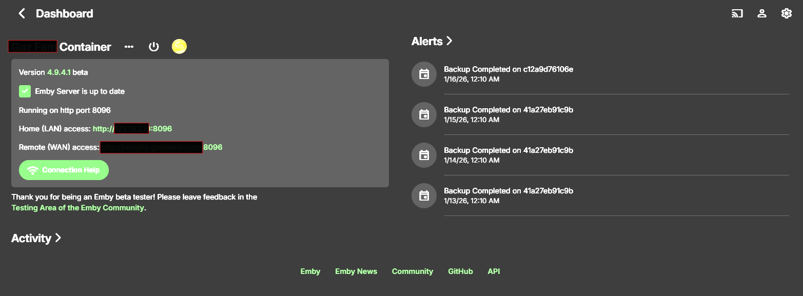

And the problems continue... Today, I saw an update in Truenas. So I decided to do a clean install with a non-beta version. I deleted the server, reinstalled it, and lo and behold, Emby beta 4.9.2.6 again. I am not offered an update after installation either.
So... today there was a notification of a new version in Truenas. This time installed via Update... 4.9.2.7... beta ...
Performed a new clean install... 4.9.2.7... beta ...
Just double checking where my issue is for this. Currently can't search for plugins after upgrading to Electric Eel and noticing the beta version. Wanna knock out one avenue of where my issue is while I'm looking into if my network settings are wacked somewhere.
  • 4 weeks later...

What you’re seeing (and why it looks wrong)
1️⃣ TrueNAS App UI
App Version: 4.9.4.1 Train: stable Source: emby/embyserver
This only describes the container packaging, not whether Emby itself is beta or stable.
TrueNAS “stable” ≠ Emby “stable”.
It just means:
  • The TrueNAS chart is considered stable
  • Not that the Emby binary inside is non-beta
2️⃣ Emby Web UI says: 4.9.4.1 beta
This is the actual truth.
You are running:
👉 Emby Server 4.9.4.1 BETA
That text comes from Emby itself, not Docker, not TrueNAS.
3️⃣ “You’re on the latest available version”
Also true — but latest beta.
Emby treats beta and stable as two separate tracks:
  • Stable users → latest stable
  • Beta testers → latest beta
You are enrolled as a beta tester, so this message is expected.

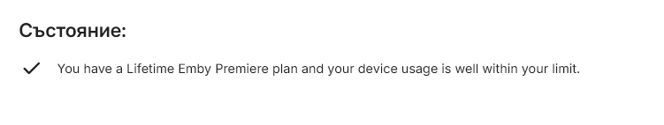

4️⃣ Lifetime Premiere status
This part is totally fine ✅
You have a Lifetime Emby Premiere plan
Beta / stable has zero impact on:
  • Your license
  • Transcoding
  • Hardware acceleration
  • Device limits
The root cause (this is the key part)
🔴 The Docker image you’re using defaults to BETA
emby/embyserver behaves like this:
  • If no explicit version tag is pinned
  • And if your config folder has beta enrollment
    ➡️ You will always get beta builds
Once a server joins beta it stays there unless you explicitly leave.

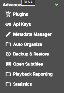

🟡 Option B — Leave beta (recommended if you want sanity)
Steps (important order):
  • In Emby Web UI
    Dashboard → Advanced
    Disable “Beta updates”
    Save
  • Stop the container
  • Recreate / redeploy the app
    Same config
    Same image
    No rollback needed
  • On next start:
    Emby will downgrade itself to latest stable
    The “beta tester” message disappears
    Version label becomes clean
⚠️ This is safe. Emby handles downgrade metadata fine.

The answer is already in the comments, you don’t need AI to figure it out. Is simple, Emby has nothing to do with how TrueNAS deploys the app. The issue is with TrueNAS not Emby
  • Like 1
  • Agree 1
Apparently they can only detect stable if we give them a release number ending in .0. Unfortunately that's just hard to do sometimes. We're going to try, and we're hoping to do that with the next stable update soon. It's  just hard to promise being able to continue to do that. I thought I did read someone was working on some other way to detect it.

BrettDioson
Also your first step:
Quote
  • In Emby Web UI
    Save
doesn't exist, at least not on TrueSCALE from what I see.  There is no "Dashboard → Advanced" setting.  There also is no explicit settings under the "Advanced" area at the bottom right menu.
On 1/2/2026 at 9:42 AM, Encho said:
Happy new year everybody !
1️⃣ TrueNAS App UI
It just means:
You are running:
  • Your license
  • Transcoding
  • Device limits
Correct there is no option in Emby to disable beta updates because the update process happens outside of it.
Neminem
