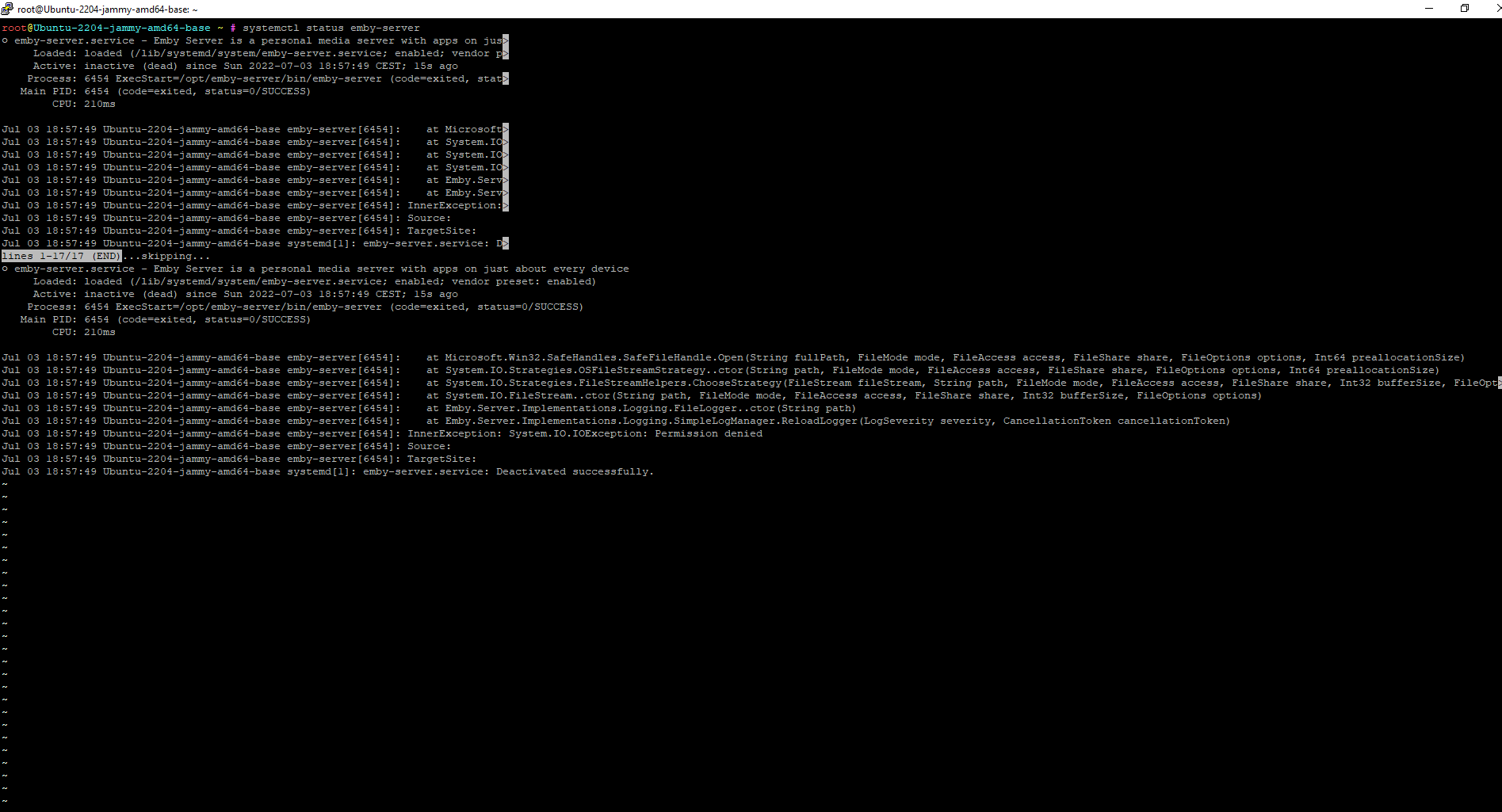

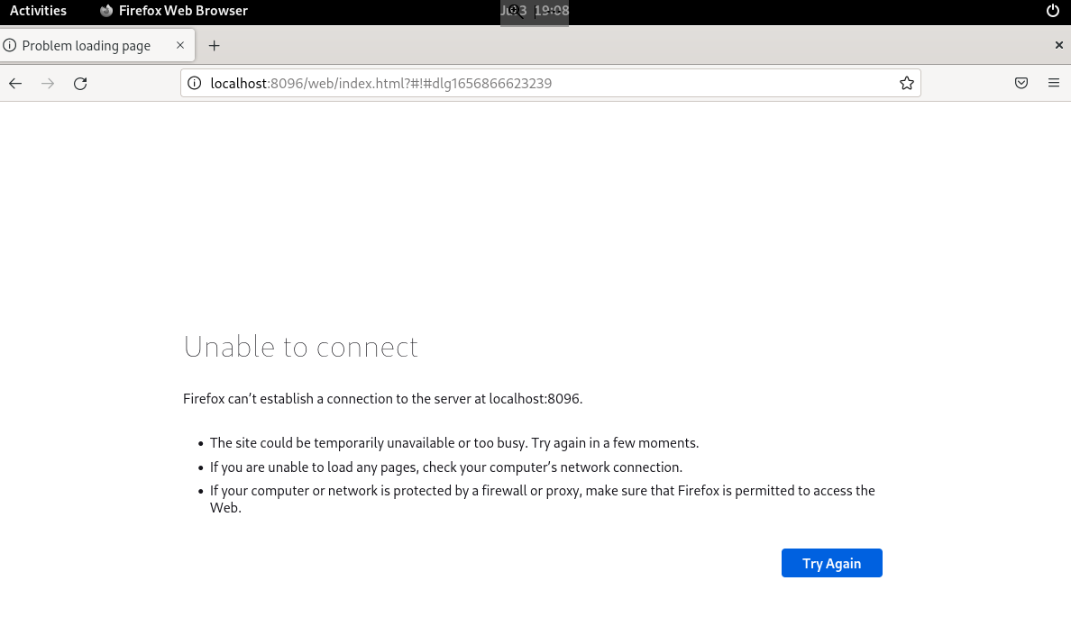

Hola, actualmente estoy migrando mi servidor a otro nuevo, pero el problema es que cuando instalo los archivos del backup en la carpeta /var/lib/emby e inicio el servidor, este no funciona y al ver el status del server me dice lo siguiente:
○ emby-server.service - Emby Server is a personal media server with apps on jus>
     Loaded: loaded (/lib/systemd/system/emby-server.service; enabled; vendor p>
     Active: inactive (dead) since Sun 2022-07-03 18:57:49 CEST; 15s ago
    Process: 6454 ExecStart=/opt/emby-server/bin/emby-server (code=exited, stat>
   Main PID: 6454 (code=exited, status=0/SUCCESS)
        CPU: 210ms
Jul 03 18:57:49 Ubuntu-2204-jammy-amd64-base emby-server[6454]:    at Microsoft>
Jul 03 18:57:49 Ubuntu-2204-jammy-amd64-base emby-server[6454]:    at System.IO>
Jul 03 18:57:49 Ubuntu-2204-jammy-amd64-base emby-server[6454]:    at Emby.Serv>
Jul 03 18:57:49 Ubuntu-2204-jammy-amd64-base emby-server[6454]: InnerException:>
Jul 03 18:57:49 Ubuntu-2204-jammy-amd64-base emby-server[6454]: Source:
Jul 03 18:57:49 Ubuntu-2204-jammy-amd64-base emby-server[6454]: TargetSite:
Jul 03 18:57:49 Ubuntu-2204-jammy-amd64-base systemd[1]: emby-server.service: D>
lines 1-17/17 (END)...skipping...
○ emby-server.service - Emby Server is a personal media server with apps on just about every device
     Loaded: loaded (/lib/systemd/system/emby-server.service; enabled; vendor preset: enabled)
    Process: 6454 ExecStart=/opt/emby-server/bin/emby-server (code=exited, status=0/SUCCESS)
        CPU: 210ms
Jul 03 18:57:49 Ubuntu-2204-jammy-amd64-base emby-server[6454]:    at Microsoft.Win32.SafeHandles.SafeFileHandle.Open(String fullPath, FileMode mode, FileAccess access, FileShare share, FileOptions options, Int64 preallocationSize)
Jul 03 18:57:49 Ubuntu-2204-jammy-amd64-base emby-server[6454]:    at System.IO.Strategies.OSFileStreamStrategy..ctor(String path, FileMode mode, FileAccess access, FileShare share, FileOptions options, Int64 preallocationSize)
Jul 03 18:57:49 Ubuntu-2204-jammy-amd64-base emby-server[6454]:    at System.IO.Strategies.FileStreamHelpers.ChooseStrategy(FileStream fileStream, String path, FileMode mode, FileAccess access, FileShare share, Int32 bufferSize, FileOpt>
Jul 03 18:57:49 Ubuntu-2204-jammy-amd64-base emby-server[6454]:    at System.IO.FileStream..ctor(String path, FileMode mode, FileAccess access, FileShare share, Int32 bufferSize, FileOptions options)
Jul 03 18:57:49 Ubuntu-2204-jammy-amd64-base emby-server[6454]:    at Emby.Server.Implementations.Logging.FileLogger..ctor(String path)
Jul 03 18:57:49 Ubuntu-2204-jammy-amd64-base emby-server[6454]:    at Emby.Server.Implementations.Logging.SimpleLogManager.ReloadLogger(LogSeverity severity, CancellationToken cancellationToken)
Jul 03 18:57:49 Ubuntu-2204-jammy-amd64-base emby-server[6454]: InnerException: System.IO.IOException: Permission denied
Jul 03 18:57:49 Ubuntu-2204-jammy-amd64-base systemd[1]: emby-server.service: Deactivated successfully.
No entiendo por que sucede ahora, ya lo había instalado anteriormente tal y como lo hice y si había funcionado pero ahora que volví a reinstalar (ya que había formateado mi servidor para instalarlo de nuevo) ya no funciona, que puedo hacer? gracias!
