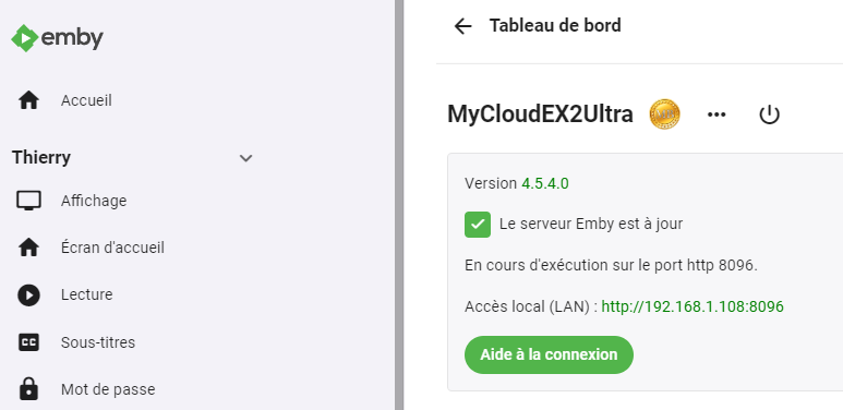

JacquesSullivan 4 Posted July 5, 2022 Posted July 5, 2022 I have exactly the same error message from Emby-Theater (Windows 10) freshly downloaded and installed on a new computer : "This Emby server needs to be updated. To download the latest version, please visit https://emby.media". On other computers with Emby-Theater installed a few months ago, I have also the same message from one or two days. So, it's impossible to connect Emby-Theater to the server any more... Emby server is on a WD NAS and is already updated (v4.5.4.0) from a few months ago. No problem with the emby application on my LG TV. Note : excuse for my bad english, I speak french natively.

JacquesSullivan 4 Posted July 5, 2022 Posted July 5, 2022 my Emby server is already updated to the last version (v4.5.4.0).
Luke 42239 Posted July 5, 2022 Posted July 5, 2022 8 minutes ago, JacquesSullivan said: my Emby server is already updated to the last version (v4.5.4.0). Hi, I think it's just not detecting that there's an update, but the latest version is now 4.7.4.
JacquesSullivan 4 Posted July 5, 2022 Posted July 5, 2022 Oh ! OK. Is it possible to update emby server without having to recreate all my libraries ? Thanks for your help
