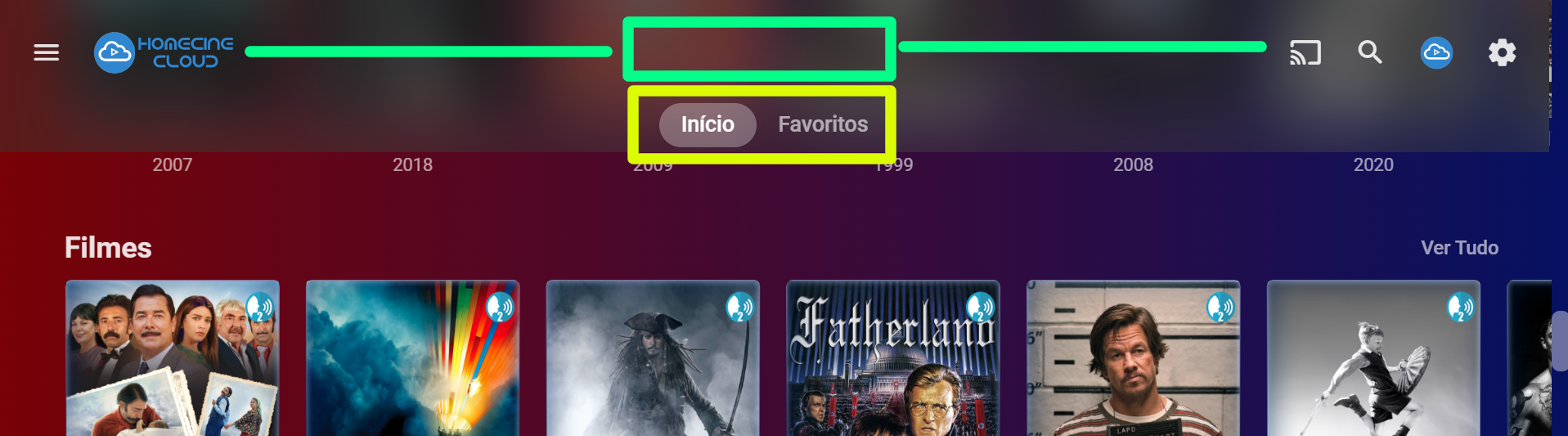

Guest Posted July 1, 2022 Posted July 1, 2022 Hi, Is it possible to use CSS/HTML to position links in the yellow frame to the green frame? I see it would look better because we have an empty space above and it would look nicer visually. Thank you very much
GrimReaper 4895 Posted July 1, 2022 Posted July 1, 2022 AFAIK that depends on the size of the window, I don't see it either on Fulscreen or 1920x1080p maximized window, but once windowed that gap shows, so you might end-up with overlapping text. If you go Fullscreen, does tab-bar move up? 1
GrimReaper 4895 Posted July 1, 2022 Posted July 1, 2022 (edited) Hm, I can only assume you already have some CSS that's interfering. Fullscreen: Maximized windowed: Windowed: Edited July 1, 2022 by GrimReaper

Solution ebr 16332 Posted July 1, 2022 Solution Posted July 1, 2022 I believe the key here is resolution. At smaller resolutions, the tabs move down so they will all fit without colliding with the other items. 1

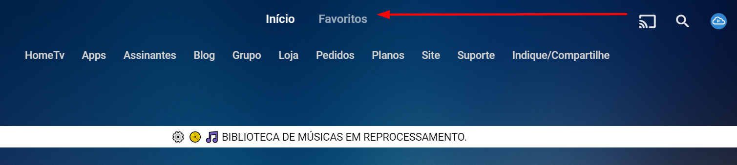

Happy2Play 9811 Posted July 2, 2022 Posted July 2, 2022 From Plex theme topic but with fix for width. Will shift row back down at lower resolution. @media (min-width: 80em) { .headerMiddle.sectionTabs.headerMiddle-withSectionTabs { position: absolute; top: 0; bottom: 0; left: 0; right: 0; width: 55%; } }

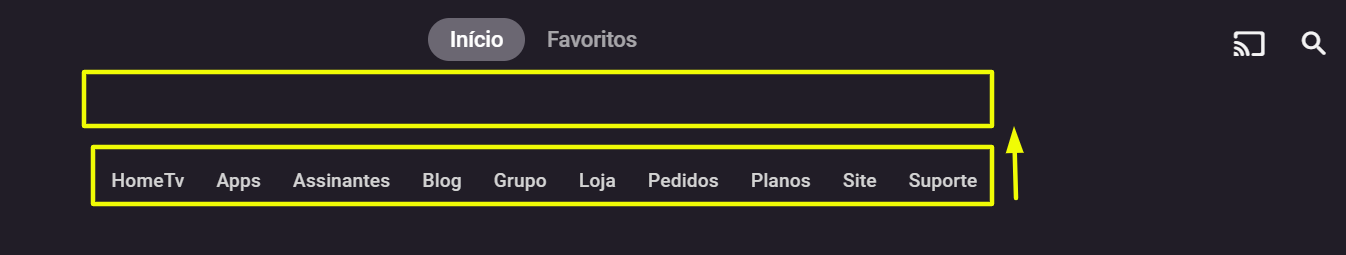

Guest Posted July 2, 2022 Posted July 2, 2022 Your effort is above expectations, thank you very much. The code worked and raised the Home and Favorites position, but my personal link line couldn't make it go up. It was at 120px, I changed it to 100px and then to 80px but it didn't change position. Is it possible to go up that line?
Happy2Play 9811 Posted July 2, 2022 Posted July 2, 2022 (edited) It moves just fine for me adjusting the inline top value but will have a possition issue on smaller screens where headermiddle will move over it. @CarlosLima but did you try adding it in "@media (min-width: 80em)" as you will need it to move with resolution? @media (min-width: 80em) { .headerMiddle.sectionTabs.headerMiddle-withSectionTabs { position: absolute; top: 0; bottom: 0; left: 0; right: 0; width: 55%; } .Personal-Links { top: 65px !important; } } Edited July 3, 2022 by Happy2Play

Guest Posted July 22, 2022 Posted July 22, 2022 On 7/2/2022 at 8:39 PM, Happy2Play said: It moves just fine for me adjusting the inline top value but will have a possition issue on smaller screens where headermiddle will move over it. @CarlosLima but did you try adding it in "@media (min-width: 80em)" as you will need it to move with resolution? @media (min-width: 80em) { .headerMiddle.sectionTabs.headerMiddle-withSectionTabs { position: absolute; top: 0; bottom: 0; left: 0; right: 0; width: 55%; } .Personal-Links { top: 65px !important; } } Hi, I think I missed this answer, sorry. Yes, I applied this code and everything seems to be fine. Thank you very much.

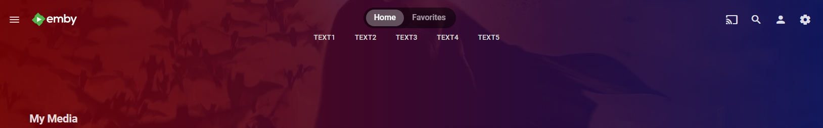

King Pin 34 Posted August 12, 2022 Posted August 12, 2022 On 7/1/2022 at 8:30 AM, GrimReaper said: AFAIK that depends on the size of the window, I don't see it either on Fulscreen or 1920x1080p maximized window, but once windowed that gap shows, so you might end-up with overlapping text. If you go Fullscreen, does tab-bar move up? That's what happens with me. First pic is window at 100%. Second pic is window at 80%. 1
Guest Posted August 12, 2022 Posted August 12, 2022 (edited) Tested at 80% and 100% and perfect alignment in Chrome. I also tested it at 25%, perfect and only at 110% the line goes down. Edited August 12, 2022 by CarlosLima
