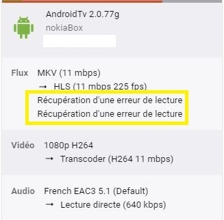

fredlaca 3 Posted August 11, 2022 Author Posted August 11, 2022 (edited) I am in the process of switching everyone to the new server but I have a question for a user with fiber internet speed, the trancoding activates each time and it tells me that it sometimes has artifacts you know why ? Edited August 11, 2022 by fredlaca
RanmaCanada 502 Posted August 12, 2022 Posted August 12, 2022 Just because they have fibre doesn't meant their ISP, or yours, aren't being assholes and throttling the traffic. As for artifacts, what is the exact hardware they are using? I see it's named as a NokiaBox. Is it this? This has the same chipset as the Firecube, and I only ever see "artifacting" on anime and it's usually due to framerates being stupid and screwy. I know it's a lot to ask of them, but see if they can record the artifacts and send them to you and then possibly post them here. Though I am almost 100% sure their problem is a client issue and not a server issue (the artifacts not the transcoding). You could also ask them to check what the quality is set to. If it's on auto, tell them to change it to an actual number and report back to you. I would also recommend to make a test video folder and dump the infamous jellyfish videos (original hosting site is down?) into them and have them play them back on auto and see when it starts to transcode. Then have them put their client to 100mb (or max speed but NOT auto)and tell them to try again and see if it transcodes. I find this is great for figuring out ISP shenanigans and have used it with multiple people to get them to switch ISPs. Good luck!
