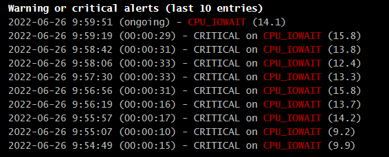

averon 7 Posted June 26, 2022 Author Posted June 26, 2022 Seems like Emby uses a lot of memory, while in the screenshot it is only 22GB, it peaked up to 27GB. My System only has 32GB and runs out of RAM causing CPU_IOWAIT. The OS is forced to use the disk as SWAP. Emby Version: 4.7.4.0 Docker: 20.10.17 Image: LinuxServer.io (I couldn't get your image running with GPU) OS: Debian GNU/Linux 10 64bit / Linux 5.10.0-0.bpo.9-amd64 What I tried: I ran iotop which didn't show that the disk usage was causing the CPU_IOWAIT Tried to set DB buffer to 1024MB Optimized/Vacumized the DB Restarted Emby Issue is gone, when I stop the rescan of the libraries

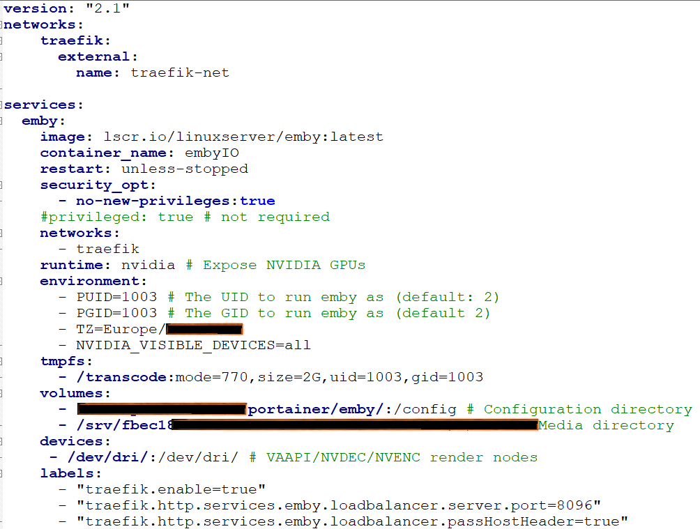

averon 7 Posted June 27, 2022 Author Posted June 27, 2022 Hi, Already uninstalled statistic plugin, now also removed the auto-organize plugin. What I have noticed is: when Emby takes up so much RAM, I am unable to play anything via Embycon, it starts stuttering immediately and is impossible to watch anything, at the same time via the mobile app or web app it works just normally. (no idea why) when I restart/shutdown Emby via dashboard, it doesn't free-up the memory, I have to restart the container itself Here my docker-compose: In case smh is wrong with it.

Q-Droid 1011 Posted June 28, 2022 Posted June 28, 2022 I/O wait by itself is not all that meaningful. If you think you have a storage bottleneck then utilities like sar, iostat and iotop can help identify the problem.
averon 7 Posted June 29, 2022 Author Posted June 29, 2022 12 hours ago, Q-Droid said: I/O wait by itself is not all that meaningful. If you think you have a storage bottleneck then utilities like sar, iostat and iotop can help identify the problem. Well, already used that, I guess my bottleneck is the 1Gb connection, even tho I use a bond, I didn't know that a single stream is still limited to 1Gb. Thinking about to remove the bond and using two single connections and split the apps on them. What do you think about it?
Q-Droid 1011 Posted June 29, 2022 Posted June 29, 2022 A 1Gb connection for what, storage? If you're using network storage then you'll have to monitor the storage device itself. If splitting the bond reduces contention between the apps it could help. But if they're using the same storage via different paths you could still run into a bottleneck. Bandwidth is part of the equation along with IOPS and service times. Pushing the limits of what the storage can deliver for any of those introduces waits. In the end you might be chasing a ghost that started with a false alarm - memory usage.
