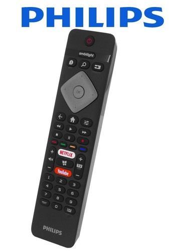

errrata 1 Posted April 15, 2023 Posted April 15, 2023 I have a number of Philips TVs (2022-2023 models) using this remote control layout - https://i.ebayimg.com/images/g/tLsAAOSwWC1iYsdp/s-l500.jpg , that lacks the 'next/prev' buttons, so I would appreciate a solution for this as well. I also have the 'mecool' remote ( https://cdn.shopify.com/s/files/1/0375/3646/5034/products/2021MECOOLVoiceControlRemoteforMECOOLKM2NetflixCertifiedAndroidTVBox_2.png?v=1667183332 ) paired that lacks these buttons just as well. It would be particularly useful when listening to music or watching music videos. I believe using channel up/down for next/prev would be an elegant solution, however as an alternative (as it was proposed in a different thread), 'pause - right' / 'pause - left' could also be a good shortcut, that would also help when using 'Shield' remote control and maybe other simplistic remotes. 1
