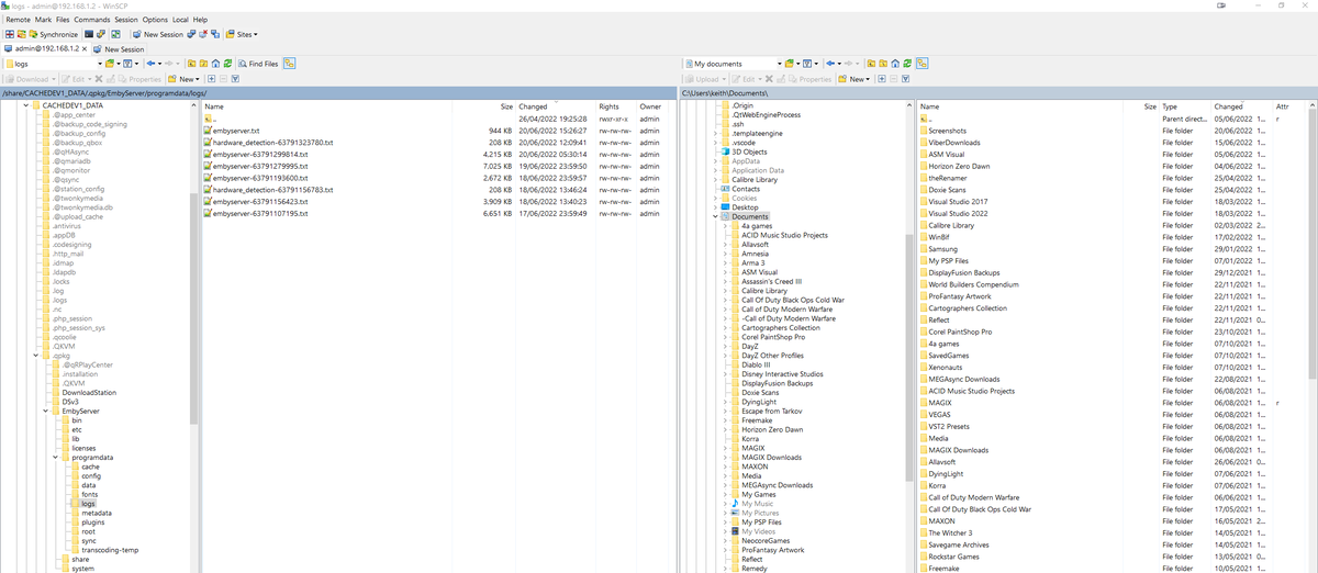

keithsrobertson 11 Posted June 20, 2022 Posted June 20, 2022 Could maybe try and use WinSCP to login to the Qnap NAS and browse to /share/CACHEDEV1_DATA/.qpkg/EmbyServer/programdata/logs folder to see if any logs are there, and copy them to local pc folder somewhere for upload. Probably have to make sure that the Allow SSH and Enable SFTP options are ticked in the Control Panel->Network & File Services->Telnet / SSH to allow you to use WinSCP - Think the Qnap Finder application for Windows will allow you to enable/disable those settings remotely as needed - ideally you only have it on when you need to use it and off for security reasons.
Alsterschiffer 1 Posted June 20, 2022 Author Posted June 20, 2022 1 hour ago, keithsrobertson said: Could maybe try and use WinSCP to login to the Qnap NAS and browse to /share/CACHEDEV1_DATA/.qpkg/EmbyServer/programdata/logs folder to see if any logs are there, and copy them to local pc folder somewhere for upload. Probably have to make sure that the Allow SSH and Enable SFTP options are ticked in the Control Panel->Network & File Services->Telnet / SSH to allow you to use WinSCP - Think the Qnap Finder application for Windows will allow you to enable/disable those settings remotely as needed - ideally you only have it on when you need to use it and off for security reasons. Got the logfile. Don't see any errors.....can I mail it to you via PM?
keithsrobertson 11 Posted June 20, 2022 Posted June 20, 2022 Quote emby-server-qnap-mono_{version}_arm-x19.qpkg I think for some reason its trying to use an arm version, whereas your Nas is x86-64. I would uninstall everything tbh, make sure all the folder are gone (verify they are removed by using WinSCP) and then get the https://github.com/MediaBrowser/Emby.Releases/releases/download/4.8.0.2/emby-server-qnap_4.8.0.2_x86_64.qpkg one. Here are my logs for comparison: 2022-06-20 12:09:15.521 Info Main: Application path: /share/CACHEDEV1_DATA/.qpkg/EmbyServer/system/EmbyServer.dll 2022-06-20 12:09:17.106 Info Main: Emby Command line: /share/CACHEDEV1_DATA/.qpkg/EmbyServer/system/EmbyServer.dll -programdata /share/CACHEDEV1_DATA/.qpkg/EmbyServer/programdata -ffdetect /share/CACHEDEV1_DATA/.qpkg/EmbyServer/bin/ffdetect -ffmpeg /share/CACHEDEV1_DATA/.qpkg/EmbyServer/bin/ffmpeg -ffprobe /share/CACHEDEV1_DATA/.qpkg/EmbyServer/bin/ffprobe -defaultdirectory /share/CACHEDEV1_DATA/Public -updatepackage emby-server-qnap_{version}_x86_64.qpkg Operating system: Linux version 5.10.60-qnap (root@U16BuildServer172) (x86_64-QNAP-linux-gnu-gcc (toolchain config: [gcc-4.9.2 binutils-2.25 glibc-2.21]) 4.9.2, GNU ld Framework: .NET 6.0.2 OS/Process: x64/x64 Runtime: share/CACHEDEV1_DATA/.qpkg/EmbyServer/system/System.Private.CoreLib.dll Processor count: 4 Data path: /share/CACHEDEV1_DATA/.qpkg/EmbyServer/programdata Application path: /share/CACHEDEV1_DATA/.qpkg/EmbyServer/system 2022-06-20 12:09:17.106 Info Main: Logs path: /share/CACHEDEV1_DATA/.qpkg/EmbyServer/programdata/logs 2022-06-20 12:09:17.106 Info Main: Cache path: /share/CACHEDEV1_DATA/.qpkg/EmbyServer/programdata/cache 2022-06-20 12:09:17.107 Info Main: Internal metadata path: /share/CACHEDEV1_DATA/.qpkg/EmbyServer/programdata/metadata 2022-06-20 12:09:17.108 Info Main: Transcoding temporary files path: /share/CACHEDEV1_DATA/.qpkg/EmbyServer/programdata/transcoding-temp 2022-06-20 12:09:17.300 Info App: Application version: 4.8.0.2 and yours: 2022-06-20 17:51:49.709 Info Main: Application path: /share/MD0_DATA/.qpkg/EmbyServer/system/EmbyServer.exe 2022-06-20 17:52:02.582 Debug App: AddMonoUriWorkaround 2022-06-20 17:52:02.739 Info Main: Emby Command line: /share/MD0_DATA/.qpkg/EmbyServer/system/EmbyServer.exe -programdata /share/MD0_DATA/.qpkg/EmbyServer/programdata -ffdetect /share/MD0_DATA/.qpkg/EmbyServer/bin/ffdetect -ffmpeg /share/MD0_DATA/.qpkg/EmbyServer/bin/ffmpeg -ffprobe /share/MD0_DATA/.qpkg/EmbyServer/bin/ffprobe -defaultdirectory /share/CACHEDEV1_DATA/Public -updatepackage emby-server-qnap-mono_{version}_arm-x19.qpkg Operating system: Linux version 3.4.6 (root@U16BuildServer105) (gcc version 4.2.1) #1 Tue Oct 6 02:13:52 CST 2020 Framework: Mono: 6.12.0.122 (tarball Wed Oct 6 07:53:52 PM UTC 2021) OS/Process: X86/X86 Runtime: share/MD0_DATA/.qpkg/EmbyServer/lib/mono/4.5/mscorlib.dll Processor count: 1 Data path: /share/MD0_DATA/.qpkg/EmbyServer/programdata Application path: /share/MD0_DATA/.qpkg/EmbyServer/system 2022-06-20 17:52:02.750 Info Main: Logs path: /share/MD0_DATA/.qpkg/EmbyServer/programdata/logs 2022-06-20 17:52:02.750 Info Main: Cache path: /share/MD0_DATA/.qpkg/EmbyServer/programdata/cache 2022-06-20 17:52:02.751 Info Main: Internal metadata path: /share/MD0_DATA/.qpkg/EmbyServer/programdata/metadata 2022-06-20 17:52:02.755 Info Main: Transcoding temporary files path: /share/MD0_DATA/.qpkg/EmbyServer/programdata/transcoding-temp 2022-06-20 17:52:04.144 Info App: Application version: 4.7.2.0
Alsterschiffer 1 Posted June 20, 2022 Author Posted June 20, 2022 12 minutes ago, keithsrobertson said: I think for some reason its trying to use an arm version, whereas your Nas is x86-64. I would uninstall everything tbh, make sure all the folder are gone (verify they are removed by using WinSCP) and then get the https://github.com/MediaBrowser/Emby.Releases/releases/download/4.8.0.2/emby-server-qnap_4.8.0.2_x86_64.qpkg one. Here are my logs for comparison: 2022-06-20 12:09:15.521 Info Main: Application path: /share/CACHEDEV1_DATA/.qpkg/EmbyServer/system/EmbyServer.dll 2022-06-20 12:09:17.106 Info Main: Emby Command line: /share/CACHEDEV1_DATA/.qpkg/EmbyServer/system/EmbyServer.dll -programdata /share/CACHEDEV1_DATA/.qpkg/EmbyServer/programdata -ffdetect /share/CACHEDEV1_DATA/.qpkg/EmbyServer/bin/ffdetect -ffmpeg /share/CACHEDEV1_DATA/.qpkg/EmbyServer/bin/ffmpeg -ffprobe /share/CACHEDEV1_DATA/.qpkg/EmbyServer/bin/ffprobe -defaultdirectory /share/CACHEDEV1_DATA/Public -updatepackage emby-server-qnap_{version}_x86_64.qpkg Operating system: Linux version 5.10.60-qnap (root@U16BuildServer172) (x86_64-QNAP-linux-gnu-gcc (toolchain config: [gcc-4.9.2 binutils-2.25 glibc-2.21]) 4.9.2, GNU ld Framework: .NET 6.0.2 OS/Process: x64/x64 Runtime: share/CACHEDEV1_DATA/.qpkg/EmbyServer/system/System.Private.CoreLib.dll Processor count: 4 Data path: /share/CACHEDEV1_DATA/.qpkg/EmbyServer/programdata Application path: /share/CACHEDEV1_DATA/.qpkg/EmbyServer/system 2022-06-20 12:09:17.106 Info Main: Logs path: /share/CACHEDEV1_DATA/.qpkg/EmbyServer/programdata/logs 2022-06-20 12:09:17.106 Info Main: Cache path: /share/CACHEDEV1_DATA/.qpkg/EmbyServer/programdata/cache 2022-06-20 12:09:17.107 Info Main: Internal metadata path: /share/CACHEDEV1_DATA/.qpkg/EmbyServer/programdata/metadata 2022-06-20 12:09:17.108 Info Main: Transcoding temporary files path: /share/CACHEDEV1_DATA/.qpkg/EmbyServer/programdata/transcoding-temp 2022-06-20 12:09:17.300 Info App: Application version: 4.8.0.2 and yours: 2022-06-20 17:51:49.709 Info Main: Application path: /share/MD0_DATA/.qpkg/EmbyServer/system/EmbyServer.exe 2022-06-20 17:52:02.582 Debug App: AddMonoUriWorkaround 2022-06-20 17:52:02.739 Info Main: Emby Command line: /share/MD0_DATA/.qpkg/EmbyServer/system/EmbyServer.exe -programdata /share/MD0_DATA/.qpkg/EmbyServer/programdata -ffdetect /share/MD0_DATA/.qpkg/EmbyServer/bin/ffdetect -ffmpeg /share/MD0_DATA/.qpkg/EmbyServer/bin/ffmpeg -ffprobe /share/MD0_DATA/.qpkg/EmbyServer/bin/ffprobe -defaultdirectory /share/CACHEDEV1_DATA/Public -updatepackage emby-server-qnap-mono_{version}_arm-x19.qpkg Operating system: Linux version 3.4.6 (root@U16BuildServer105) (gcc version 4.2.1) #1 Tue Oct 6 02:13:52 CST 2020 Framework: Mono: 6.12.0.122 (tarball Wed Oct 6 07:53:52 PM UTC 2021) OS/Process: X86/X86 Runtime: share/MD0_DATA/.qpkg/EmbyServer/lib/mono/4.5/mscorlib.dll Processor count: 1 Data path: /share/MD0_DATA/.qpkg/EmbyServer/programdata Application path: /share/MD0_DATA/.qpkg/EmbyServer/system 2022-06-20 17:52:02.750 Info Main: Logs path: /share/MD0_DATA/.qpkg/EmbyServer/programdata/logs 2022-06-20 17:52:02.750 Info Main: Cache path: /share/MD0_DATA/.qpkg/EmbyServer/programdata/cache 2022-06-20 17:52:02.751 Info Main: Internal metadata path: /share/MD0_DATA/.qpkg/EmbyServer/programdata/metadata 2022-06-20 17:52:02.755 Info Main: Transcoding temporary files path: /share/MD0_DATA/.qpkg/EmbyServer/programdata/transcoding-temp 2022-06-20 17:52:04.144 Info App: Application version: 4.7.2.0 emby-server-qnap_4.8.0.2_x86_64.qpkg doesn't install. My QNAP is TS-220 and has a Marvell 1.6GHz CPU. According to the emby website, ARM19 is the right file. ARM X12, X19, X20, X21 - Supported models (not an exhaustive list): TS-112P, TS-120, TS-121, TS-212-E, TS-212P, TS-220, TS-221, TS-412, TS-420, TS-420U, TS-421, TS-421U
