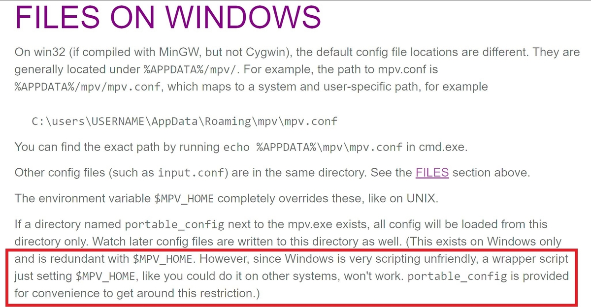

Guest Posted June 18, 2022 Posted June 18, 2022 Also something to consider. And portable_config doesn't work with libmpv
