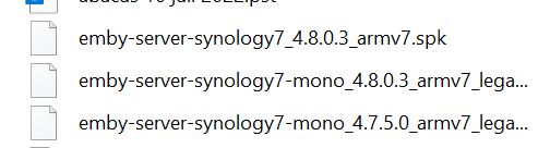

hanssax 1 Posted July 25, 2022 Author Posted July 25, 2022 Hi Luke, I am back from my vacation, I have trouble finding the right file. I us a Synology DS218 Play NAS, so far I 've tried these updates: @FrostByte but none of them seems to work on my system. I have installed currently Emby server 4.8.0.0 Beta, te settings page suggests that there should be a 4.8.0.7 update, but as said, I can't find the right version. Could you help me here please? thanks, Hans
Luke 42241 Posted August 3, 2022 Posted August 3, 2022 On 7/25/2022 at 1:38 PM, hanssax said: Hi Luke, I am back from my vacation, I have trouble finding the right file. I us a Synology DS218 Play NAS, so far I 've tried these updates: @FrostByte but none of them seems to work on my system. I have installed currently Emby server 4.8.0.0 Beta, te settings page suggests that there should be a 4.8.0.7 update, but as said, I can't find the right version. Could you help me here please? thanks, Hans hi @hanssax for your model, what do our download instructions point to? https://emby.media/synology-server.html 1
FrostByte 5453 Posted August 3, 2022 Posted August 3, 2022 On 7/25/2022 at 1:38 PM, hanssax said: Hi Luke, I am back from my vacation, I have trouble finding the right file. I us a Synology DS218 Play NAS, so far I 've tried these updates: @FrostByte but none of them seems to work on my system. I have installed currently Emby server 4.8.0.0 Beta, te settings page suggests that there should be a 4.8.0.7 update, but as said, I can't find the right version. Could you help me here please? thanks, Hans If you click on the link at the top of the download page called "architecture of your Synology NAS" you should be able to find your NAS and it looks like it's an armv8.
Luke 42241 Posted August 5, 2022 Posted August 5, 2022 23 hours ago, hanssax said: Thanks very much, it is indeed armv8 HI, are you all set now?
hanssax 1 Posted August 7, 2022 Author Posted August 7, 2022 Hi Luke, yes!!! I have tested a number of times and everything works fine. Thanks for all your help 1
