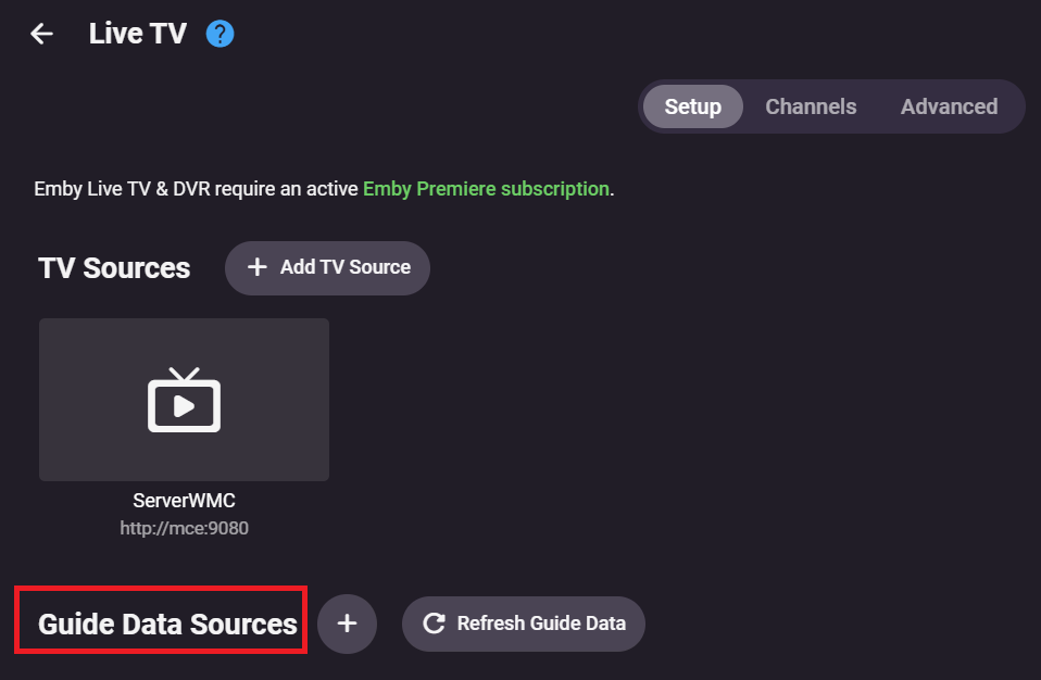

jriker1 21 Posted June 14, 2022 Author Posted June 14, 2022 (edited) 14 minutes ago, Luke said: Emby will do the recording work now Can you explain this a bit? If I click into ServerWMC in the client when I actually can see a guide, and pick a show and click record, that recording will happen with the Emby engine and not WMC? So then basically that show recording won't show up in WMC correct like thru my XBox 360 as an extender (not referring to the Emby addon for XBox 360)? And by the way, so do I not pick anything in the highlighted area below? Edited June 14, 2022 by jriker1
ebr 16357 Posted June 15, 2022 Posted June 15, 2022 13 hours ago, jriker1 said: If I click into ServerWMC in the client when I actually can see a guide, and pick a show and click record, that recording will happen with the Emby engine and not WMC? No, if you do this directly in ServerWMC, then WMC will still do that recording. But, if you schedule a recording in Emby, then Emby will be the one recording. Basically, the ServerWMC system is just seen as another tuner to Emby now.
Luke 42301 Posted June 15, 2022 Posted June 15, 2022 If you want to use guide data from ServerWMC, I've restored that in this build of the plugin here if you'd like to try it out and provide feedback: Thanks.

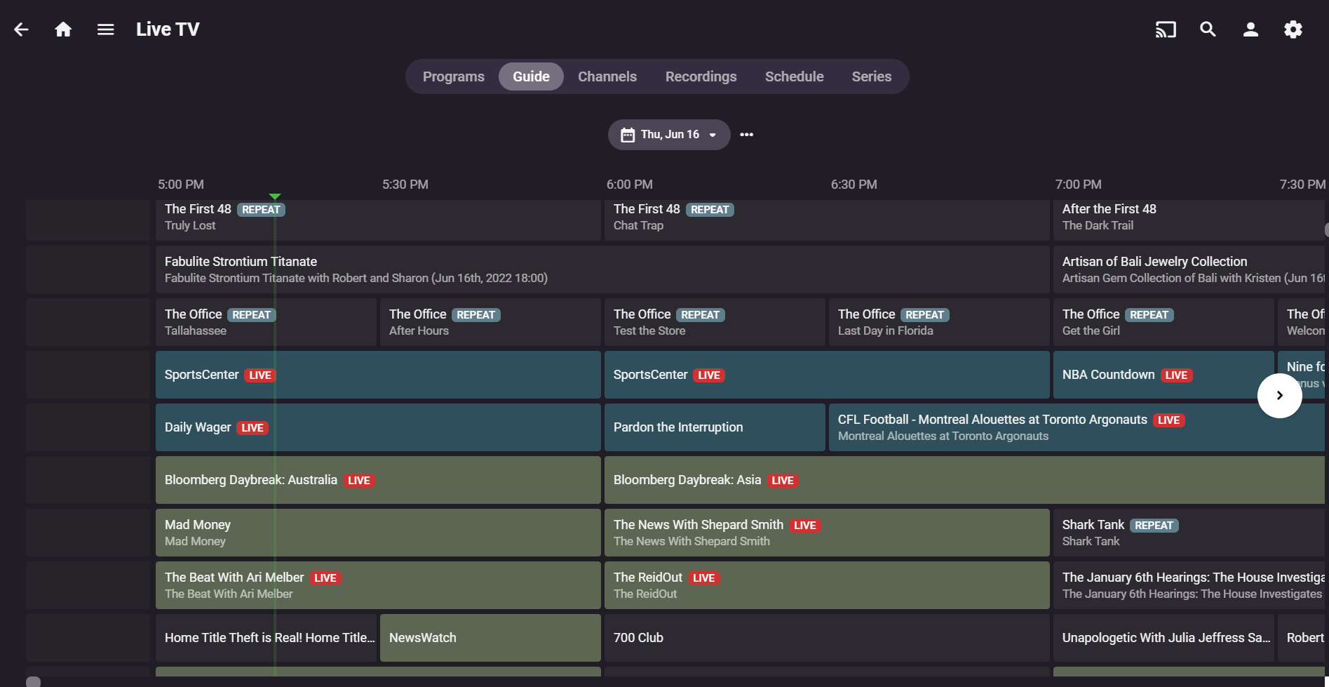

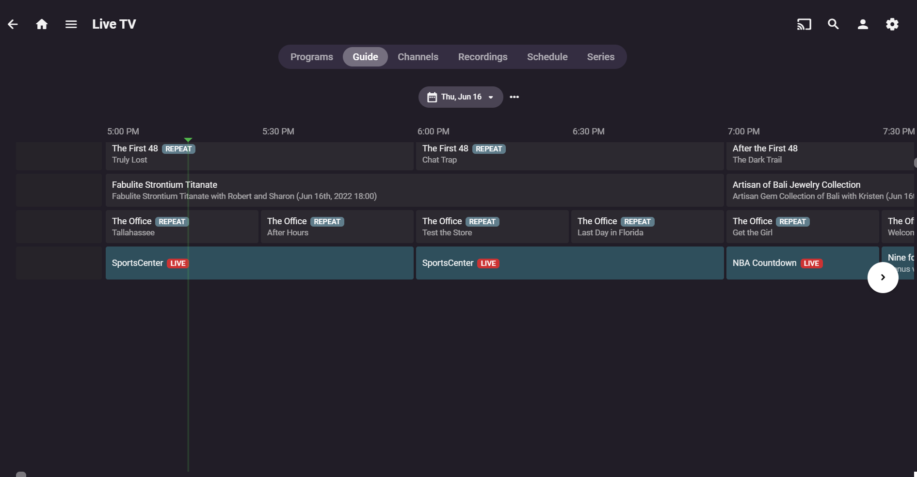

jriker1 21 Posted June 16, 2022 Author Posted June 16, 2022 That works!! Thank you!! Recorded some shows as well. Haven't tried to play them yet. Issue I see, at least so far thru the web interface is the guide display is slow. Numbers don't show on the left side but think they are there as they show in the iPhone app. So I pull up the Guide in my browser and it's blank. Then a bit shows. If I scroll down I get like this: So only a bit has populated the screen. Then wait a few more seconds and more displays under that Channels and Programs tabs are similar but works.
Luke 42301 Posted June 16, 2022 Posted June 16, 2022 That's odd. What browser and browser version is that?
jriker1 21 Posted June 16, 2022 Author Posted June 16, 2022 (edited) Microsoft EdgeVersion 102.0.1245.41 (Official build) (64-bit) Another example, I just clicked on Recordings which there is one. Took a count of 20 seconds on a blank screen before the thumbnail showed. Edited June 16, 2022 by jriker1
