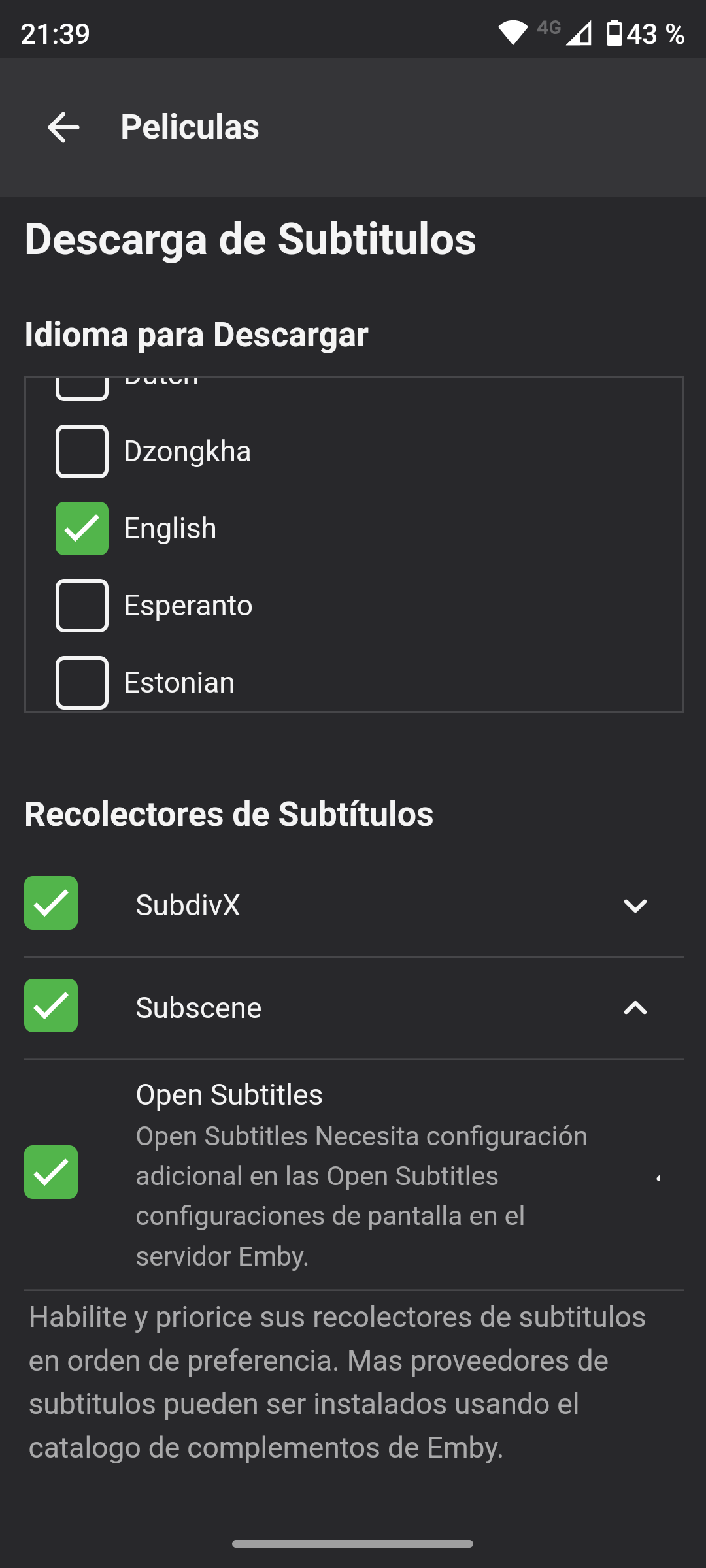

victor@vialy.com 9 Posted June 13, 2022 Posted June 13, 2022 Hi. I have opensubtitles, Subdivx and Subscene as subtitle providers. I can manually get the subtitles for movies on the title screen (edit subtitles function) But Emby does not automatically download my library sobtitles when running the scheduled task. Attached is my error log. Emby Server running on Windows 7 x64 Thanks in advance! emby.log.txt

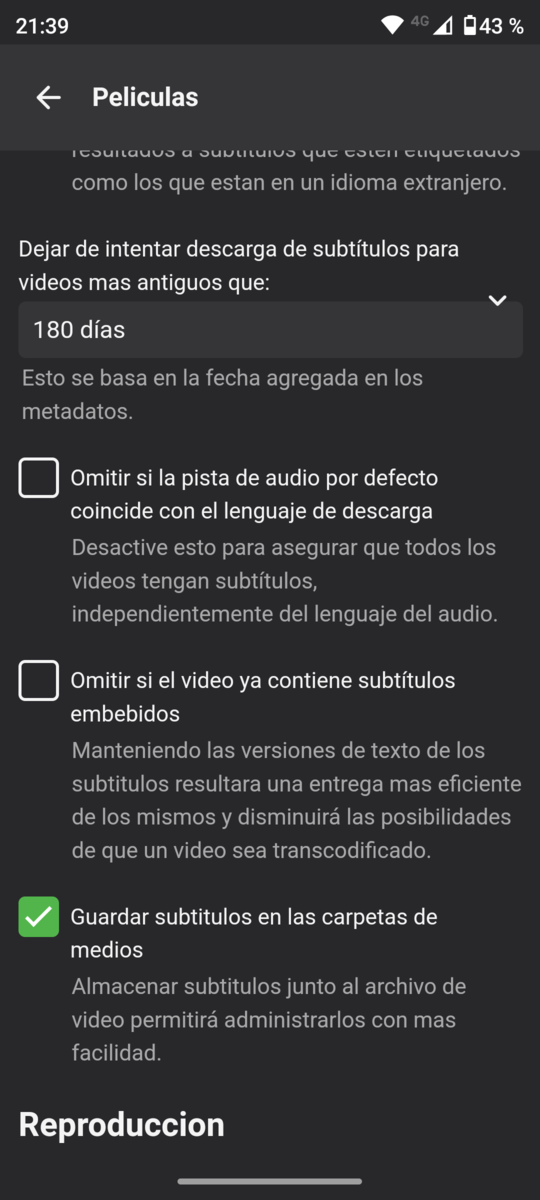

victor@vialy.com 9 Posted June 14, 2022 Author Posted June 14, 2022 Hi Luke. Everything is configured. Please check the log.
victor@vialy.com 9 Posted June 14, 2022 Author Posted June 14, 2022 English and Spanish subtitles download, no exact match required, on the 3 subtitle sources added. Tried also deactivating open subtitles (in case that the opensuntitle plugin stopped working with their new beta site) with same results.
