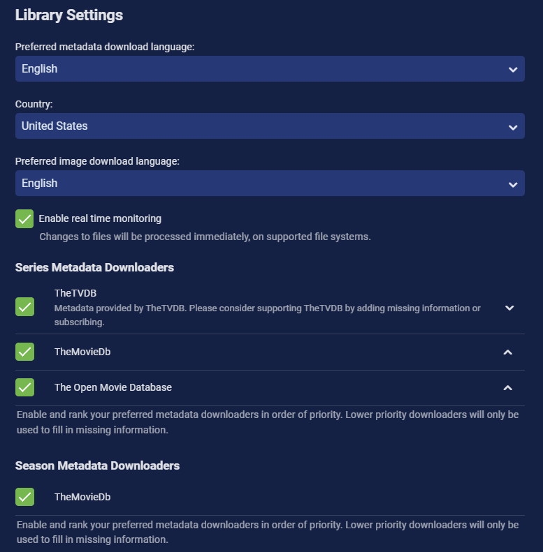

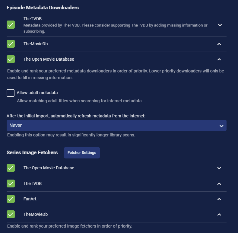

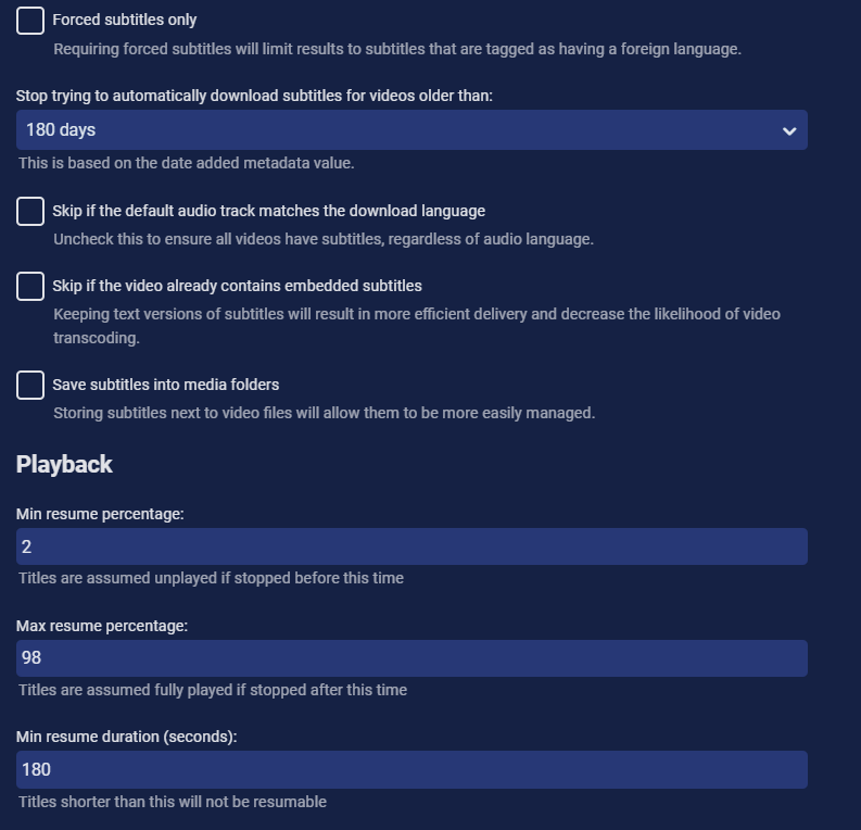

crusher11 1153 Posted June 14, 2022 Posted June 14, 2022 31 minutes ago, mbarylski said: Ugh, no. I guess things are getting flipped around in my mind. Here's a screenshot. But what do the files look like in there? And what about the library settings?
MBSki 1116 Posted June 14, 2022 Author Posted June 14, 2022 1 minute ago, crusher11 said: But what do the files look like in there? And what about the library settings? Here are a couple more screen shots.
crusher11 1153 Posted June 14, 2022 Posted June 14, 2022 Turn off all the metadata and image fetchers.
MBSki 1116 Posted June 14, 2022 Author Posted June 14, 2022 Just now, crusher11 said: Turn off all the metadata and image fetchers. Alright, thanks. I'll give that a shot.
