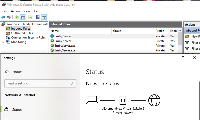

Geniuses! It was very counter-intuitive for me and I thought private internet profiles were more secure, so I thought my internet was "private", but by default it was in fact "public", so once I deleted the firewall rule for the "Public" profiles, it works now!

The correct solution is as per your original view - LAN should always be private ;)
You need to make your LAN private (and not public) - and then the emby private rule would have worked.  By using a public LAN profile - you are putting your PC at unnecessary risk.
Ensure all the other hosts on the network are private as well - you'll probably find your old emby host was.
Actually, the "public" profile is more locked down than the "private" one - it makes it harder to connect between machines and devices within the local network, so that on public "local" networks such as airport lounges it keeps your machine more isolated.
