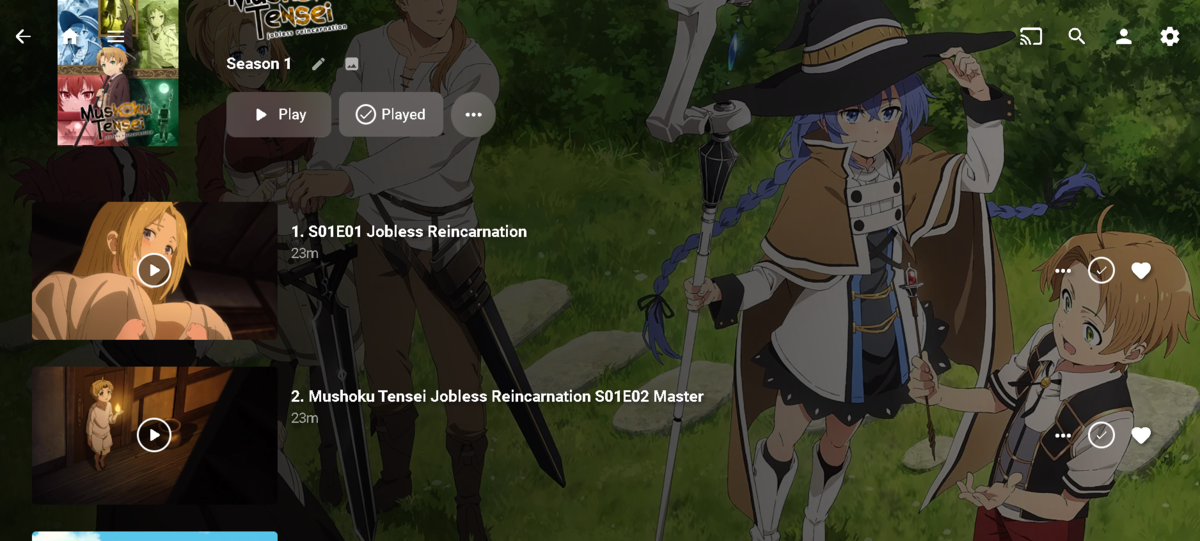

Dreakon13 143 Posted June 12, 2022 Posted June 12, 2022 (edited) EDIT: It occurs to me there's another thread about TheTVDB issues for this particular series. I'm guessing you guys are looking into it. Trying to add the anime Mushoku Tensei: Jobless Reincarnation to my Anime library. It's picking up the show well enough, but for some reason the episodes don't seem to be pulling in. Folder structure: Jobless Reincarnation - Season 01 -- S01E01 Jobless Reincarnation.mkv -- Mushoku Tensei Jobless Reincarnation S01E02 Master.mkv (Tried episode names both ways, neither seem to pull it in) Any thoughts? I guess I must be missing something. Edited June 12, 2022 by Dreakon13

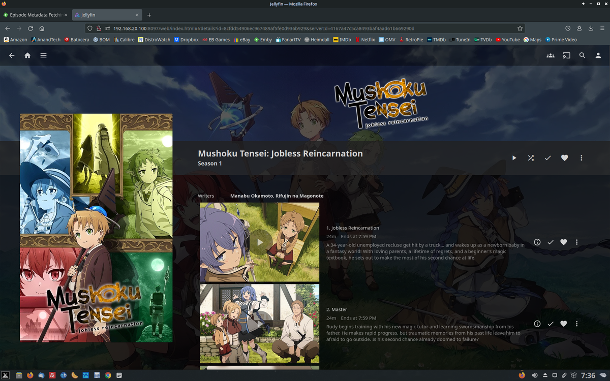

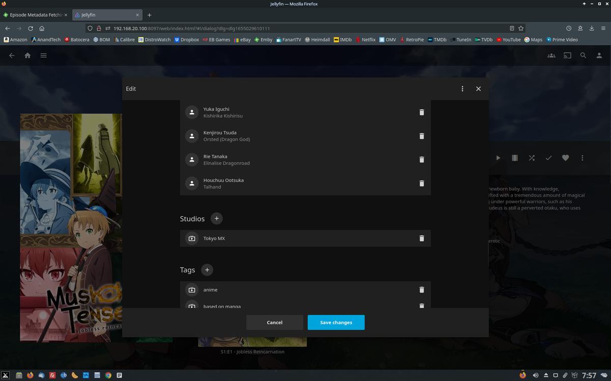

Junglejim 385 Posted June 12, 2022 Posted June 12, 2022 My series pulled the episode info fine, I just had a problem with pulling multiple studios (4). Folder structure is: Mushoku Tensei Jobless Reincarnation - Season 1 - Mushoku Tensei Jobless Reincarnation - 1x01 - Jobless Reincarnation.mkv

Dreakon13 143 Posted June 12, 2022 Author Posted June 12, 2022 (edited) 6 minutes ago, Luke said: HI there, have you compared to the data that tvdb has for this series? I changed my structure to this... Mushoku Tensei Jobless Reincarnation - Season 01 -- Mushoku Tensei Jobless Reincarnation S01E01 Jobless Reincarnation.mkv -- Mushoku Tensei Jobless Reincarnation S01E02 Master.mkv ... and it still doesn't seem to be pulling in. What data would I compare? That's the name of the series, and that's the name of Season 01. The TVDB id is correct in the series metadata. Edited June 12, 2022 by Dreakon13
Junglejim 385 Posted June 12, 2022 Posted June 12, 2022 (edited) 3 hours ago, Dreakon13 said: I changed my structure to this... Mushoku Tensei Jobless Reincarnation - Season 01 -- Mushoku Tensei Jobless Reincarnation S01E01 Jobless Reincarnation.mkv -- Mushoku Tensei Jobless Reincarnation S01E02 Master.mkv ... and it still doesn't seem to be pulling in. What data would I compare? That's the name of the series, and that's the name of Season 01. The TVDB id is correct in the series metadata. Yea what you have there should pull the metadata no probs. I think there is something going down with TVDB because I can't get any images/meta from TVDB at the mo (the website works fine), it's all TMDB/FanartTV for meta/images in Emby. Maybe have a go tomorrow and see if it gets any better. Edit: Well this is strange.. Just tried Jellyfin and it has no problems hitting the TVDB API (meta/images).. So somethings not going to plan with Emby! Edited June 12, 2022 by Junglejim

Junglejim 385 Posted June 12, 2022 Posted June 12, 2022 (edited) 53 minutes ago, los.angelme said: I'm also getting too many requests error with the TVDB since yesterday. 2022-06-12 09:12:25.421 Error ProviderManager: Error searching *** Error Report *** Version: 4.7.2.0 Command line: /system/EmbyServer.dll -programdata /config -ffdetect /bin/ffdetect -ffmpeg /bin/ffmpeg -ffprobe /bin/ffprobe -restartexitcode 3 Operating system: Linux version 5.4.0-107-generic (buildd@lcy02-amd64-058) (gcc version 9.4.0 (Ubuntu 9.4.0-1ubuntu1~20.04.1)) #121-Ubuntu SMP Thu Mar 24 16:04:27 UTC 2 Framework: .NET 6.0.2 OS/Process: x64/x64 Runtime: system/System.Private.CoreLib.dll Processor count: 12 Data path: /config Application path: /system MediaBrowser.Model.Net.HttpException: MediaBrowser.Model.Net.HttpException: TooManyRequests at Emby.Server.Implementations.HttpClientManager.CoreHttpClientManager.SendAsyncInternal(HttpRequestOptions options, String httpMethod) at Emby.Server.Implementations.HttpClientManager.CoreHttpClientManager.SendAsync(HttpRequestOptions options, String httpMethod) at Tvdb.EntryPoint.GetResponse(HttpRequestOptions request, String method) at Tvdb.TvdbSeriesProvider.FetchMainResult(String id, String language, CancellationToken cancellationToken) at Tvdb.TvdbSeriesProvider.EnsureSeriesInfo(String tvdbId, String language, IDirectoryService directoryService, CancellationToken cancellationToken) at Tvdb.TvdbSeriesProvider.FetchSeriesData(String tvdbId, String seasonType, String language, String country, IDirectoryService directoryService, CancellationToken cancellationToken) at Tvdb.TvdbSeriesProvider.GetMetadata(RemoteMetadataFetchOptions`1 options, CancellationToken cancellationToken) at Tvdb.TvdbSeriesProvider.GetSearchResults(SeriesInfo searchInfo, CancellationToken cancellationToken) at Emby.Providers.Manager.ProviderManager.GetSearchResults[TLookupType](IRemoteSearchProvider`1 provider, TLookupType searchInfo, CancellationToken cancellationToken) at Emby.Providers.Manager.ProviderManager.GetRemoteSearchResults[TItemType,TLookupType](RemoteSearchQuery`1 searchInfo, BaseItem referenceItem, CancellationToken cancellationToken) Source: Emby.Server.Implementations TargetSite: Void MoveNext() Yep there is something going wrong somewhere. I just nuked my Jellyfin docker and reinstalled it for tvshows (only a small lib about 130 shows) and it pulled all the TVDB meta no probs.. No request error's.. Still not sure why! The internet has been funky today (slow.. even this forum!).. I sure it will get sorted out. Also just one studio which made my day.. TvShows studios metadata? Edited June 12, 2022 by Junglejim
Happy2Play 9800 Posted June 12, 2022 Posted June 12, 2022 26 minutes ago, Junglejim said: I just nuked my Jellyfin docker and reinstalled it for tvshows (only a small lib about 130 shows) and it pulled all the TVDB meta no probs.. I highly doubt they are using TVDB v4 api as Emby is paying for access. I assume if one were to downgrade back to 4.6.7.0 with v3 api it would probably work just fine also. As I am still getting the error MediaBrowser.Model.Net.HttpException: TooManyRequests 1
Junglejim 385 Posted June 12, 2022 Posted June 12, 2022 (edited) 23 minutes ago, Happy2Play said: I highly doubt they are using TVDB v4 api as Emby is paying for access. I assume if one were to downgrade back to 4.6.7.0 with v3 api it would probably work just fine also. As I am still getting the error MediaBrowser.Model.Net.HttpException: TooManyRequests Yep I totally agree with that! That just proves that there is something going wrong with the new API..!? I'm sure it will get sorted out. Emby is paying for the TVDB service and they would want it to work yes? Edited June 12, 2022 by Junglejim
