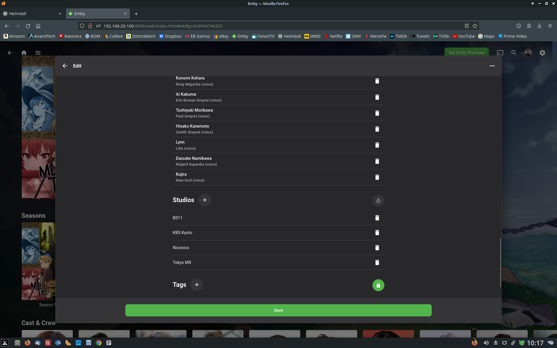

Junglejim 385 Posted June 12, 2022 Author Posted June 12, 2022 This is Mushoku Tensei: Jobless Reincarnation. As you can see it pulled 4 studios, the main studio is "Tokyo MX". So that's 3 extra studios with one show referenced and duplicated in each of them.

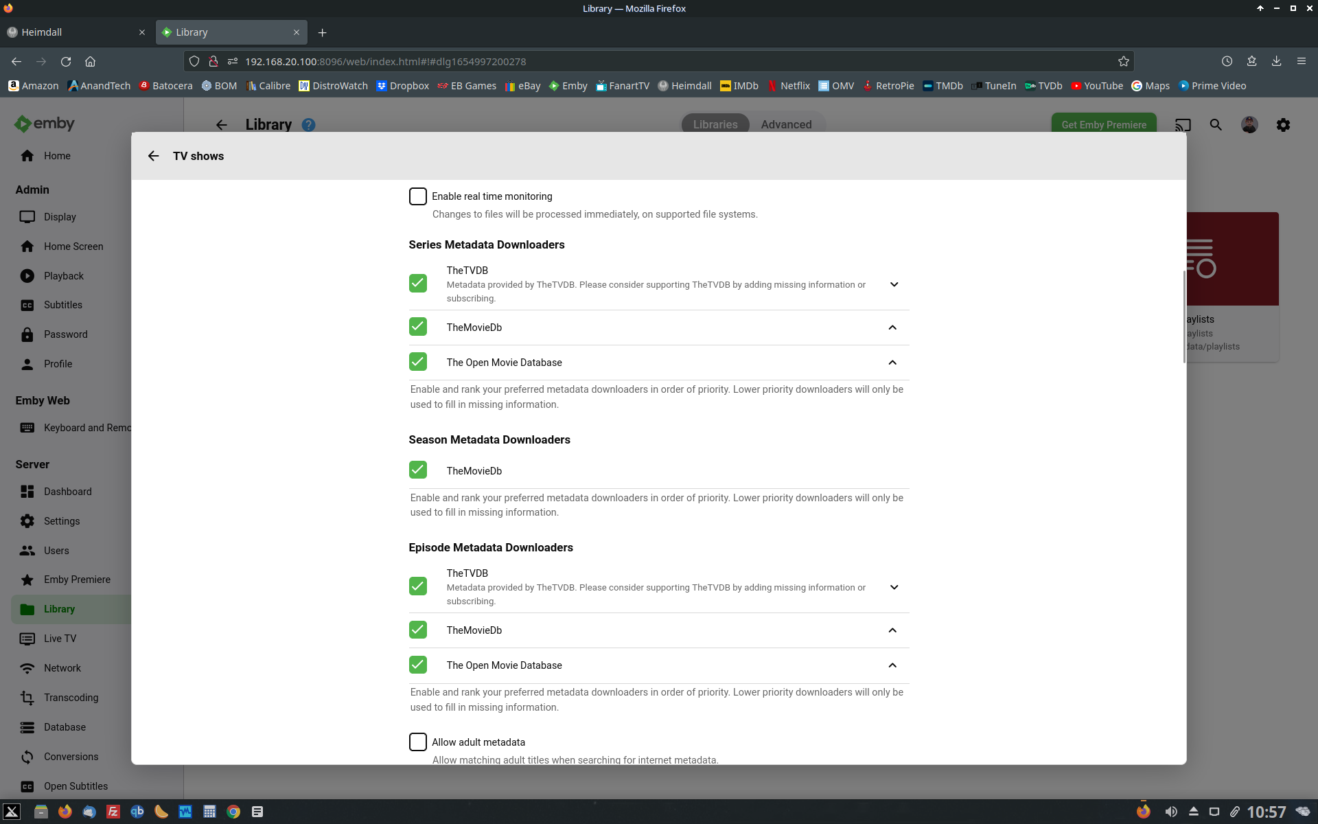

Happy2Play 9800 Posted June 12, 2022 Posted June 12, 2022 22 minutes ago, Junglejim said: This is Mushoku Tensei: Jobless Reincarnation. As you can see it pulled 4 studios, the main studio is "Tokyo MX". So that's 3 extra studios with one show referenced and duplicated in each of them. What is your provider order as TVDB only has 1 but TMDB has 4?
Junglejim 385 Posted June 12, 2022 Author Posted June 12, 2022 TheTVDB is at the top of providers for everything.
Happy2Play 9800 Posted June 12, 2022 Posted June 12, 2022 (edited) 20 minutes ago, Junglejim said: TheTVDB is at the top of providers for everything. Just tested this Series and got no Studios but can see in the log TVDB is failing do to "TooManyRequests", even Refreshing the media does not provide Studios for me right now. Actually, need to retest as I have a Studio Cleaner issue. Edited June 12, 2022 by Happy2Play
Happy2Play 9800 Posted June 12, 2022 Posted June 12, 2022 Okay retested after correcting Studio Cleaner issue and got 4 Studios, but believe it is do to TVDB "TooManyRequest" issues going on. So technically I got nothing from TVDB for this Series even though they are my first provider. @Lukeis this something new? 2022-06-11 18:56:12.574 Debug App: Running TvdbSeriesProvider for C:\Users\Media\Desktop\Videos\TV Shows - nfo\Mushoku Tensei Jobless Reincarnation 2022-06-11 18:56:12.574 Info HttpClient: GET https://api4.thetvdb.com/v4/series/371310/extended?meta=translations 2022-06-11 18:56:13.611 Error App: Error in TheTVDB *** Error Report *** Version: 4.7.2.0 Command line: C:\Users\Media\Desktop\Stable\system\EmbyServer.dll -noautorunwebapp Operating system: Microsoft Windows 10.0.25131 Framework: .NET 6.0.5 OS/Process: x64/x64 Runtime: C:/Users/Media/Desktop/Stable/system/System.Private.CoreLib.dll Processor count: 8 Data path: C:\Users\Media\Desktop\Stable\programdata Application path: C:\Users\Media\Desktop\Stable\system MediaBrowser.Model.Net.HttpException: MediaBrowser.Model.Net.HttpException: TooManyRequests at Emby.Server.Implementations.HttpClientManager.CoreHttpClientManager.SendAsyncInternal(HttpRequestOptions options, String httpMethod) at Emby.Server.Implementations.HttpClientManager.CoreHttpClientManager.SendAsync(HttpRequestOptions options, String httpMethod) at Tvdb.EntryPoint.GetResponse(HttpRequestOptions request, String method) at Tvdb.TvdbSeriesProvider.FetchMainResult(String id, String language, CancellationToken cancellationToken) at Tvdb.TvdbSeriesProvider.EnsureSeriesInfo(String tvdbId, String language, IDirectoryService directoryService, CancellationToken cancellationToken) at Tvdb.TvdbSeriesProvider.FetchSeriesData(String tvdbId, String seasonType, String language, String country, IDirectoryService directoryService, CancellationToken cancellationToken) at Tvdb.TvdbSeriesProvider.GetMetadata(RemoteMetadataFetchOptions`1 options, CancellationToken cancellationToken) at Emby.Providers.Manager.MetadataService`2.ExecuteRemoteProviders(MetadataResult`1 temp, LibraryOptions libraryOptions, String logName, TIdType id, IEnumerable`1 providers, MetadataRefreshOptions options, CancellationToken cancellationToken) Source: Emby.Server.Implementations TargetSite: Void MoveNext() 1

Luke 42186 Posted June 12, 2022 Posted June 12, 2022 6 hours ago, Junglejim said: Are you sure about this? From the tests I've run this seem's not to be the case! If tvdb failed for whatever reason it might have gone to the next provider. We'd have to look at an example: Thanks.
