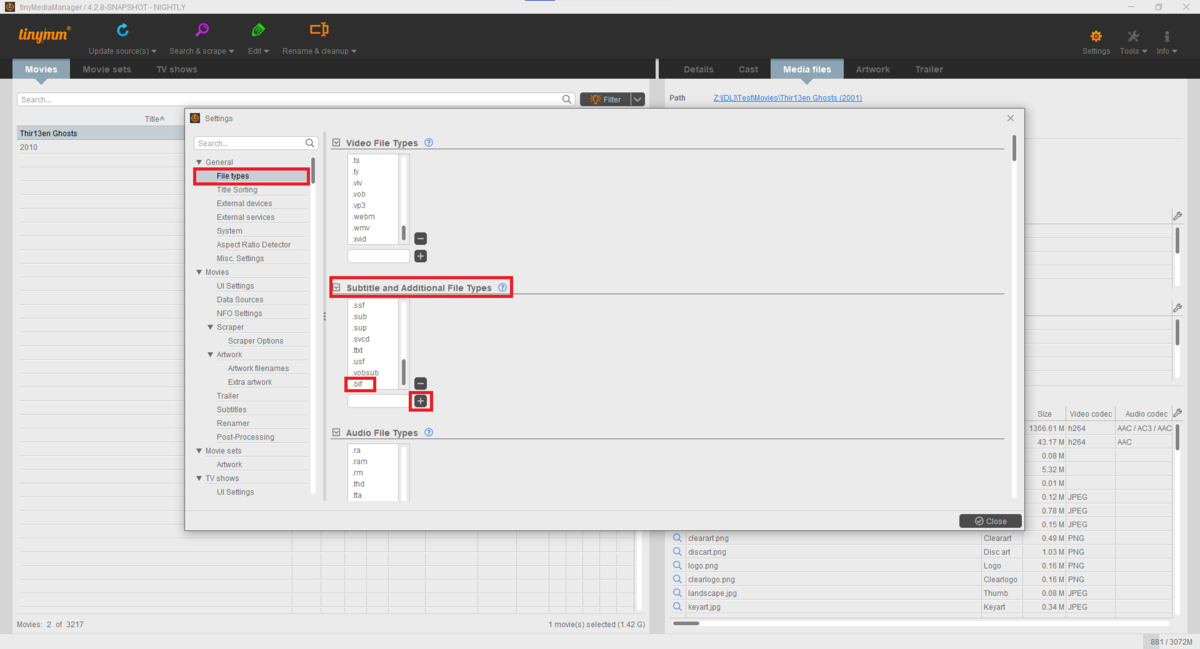

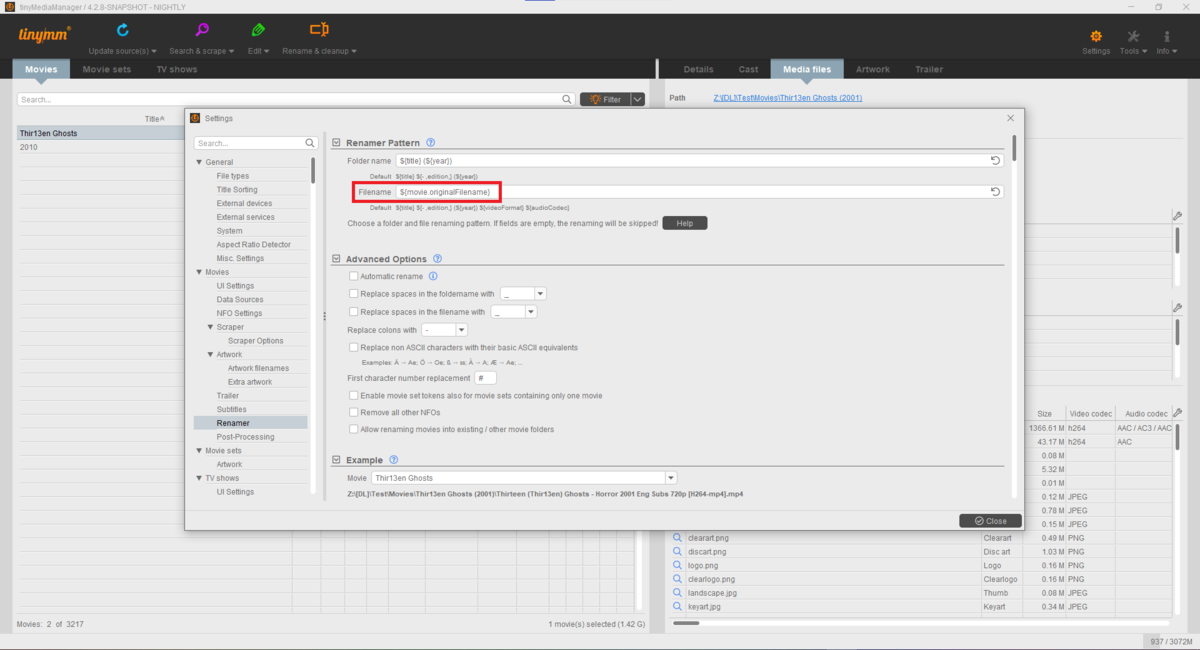

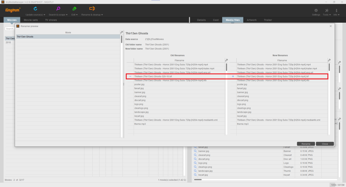

GrimReaper 4899 Posted June 10, 2022 Posted June 10, 2022 (edited) Hey up, syd It is somewhat possible via TMM, but you'll need a bulk-renaming tool (like Advanced Renamer or any other of choice) in addition. (bear with me and gimme 5 minutes as I have to edit this post thrice else images will be all around the place since I'm on mobile and it's tricky to get them in between text) If I understood you correctly, scenario is as below, movie folder with old bif file: In TMM Settings>General>File types, add .bif under "Subtitle and Additional File Types". Update Source(s) afterwards so those .bifs get read by TMM, else they'll remain ignored: In TMM Renamer settings use ${movie.originalFilename} token as Filename argument: If you now dry run Rename/Cleanup, you can see only .bif file will be renamed according new/changed/updated moviefilename: However, it will lose suffix (like -320-10) for which you can batch-search *.bif on OS level and just add that at the end with any bulk-renaming utility. Edited June 10, 2022 by GrimReaper Screenshots are PITA 1
