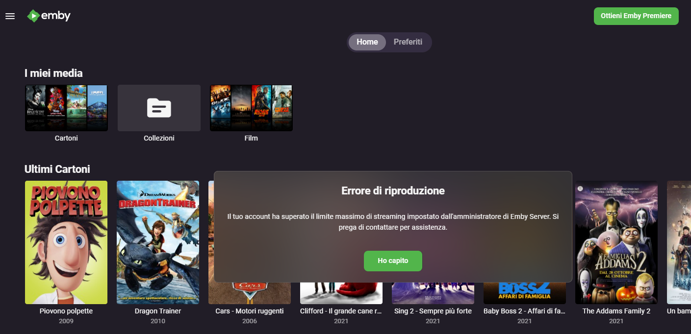

alessioP 2 Posted June 10, 2022 Posted June 10, 2022 Hello, almost every time that I'm using one user on the App of LG TV i receive the below error: "Your account has exceeded the maximum streaming limit set by the Emby Server administrator" Naturally this is not true otherwise I would not have opened this topic. Both setting about the maximum streaming limit (global and user) are set to unlimited. The source is a QNAP TS-230 and the usual player an LG TV but I tested also with other player with the same result. Can you suggest something?

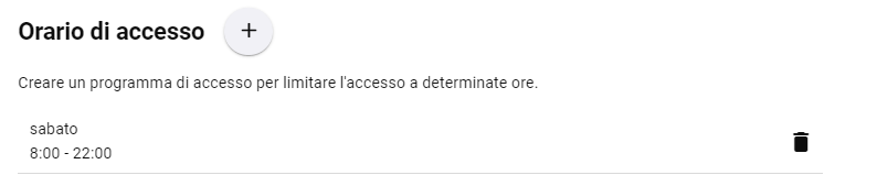

Luke 42239 Posted June 10, 2022 Posted June 10, 2022 I would also check the parental control access schedule. That could also cause this error.
alessioP 2 Posted June 13, 2022 Author Posted June 13, 2022 Hi Luke, you are right, I've put some restriction in hours and I didn't remember these. Thanks for the help, but please accept a suggestion, an alert message more related to the setting that block the action could help the user to do the right settings on the system. Could be better something like "You are watching Emby outside the allowed times"
Luke 42239 Posted June 13, 2022 Posted June 13, 2022 HI, yes we'll look at improving it. Thanks for the feedback.
