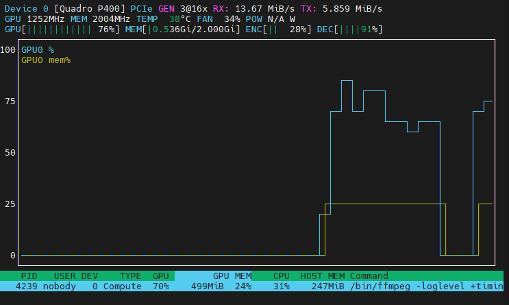

Sungray 6 Posted June 14, 2022 Author Posted June 14, 2022 (edited) This time it worked, these seem to change all the time :D. I'm not on my LAN right now. But no effect on the mem. ffmpeg-transcode-6a2081f2-d169-482d-836e-e1da143299f0_1.txt Edited June 14, 2022 by Sungray
softworkz 5133 Posted June 14, 2022 Posted June 14, 2022 The last idea that that I have is that maybe they are only encoding a small chunk and each time and then stopping the process again, so you might just see an average in the nvidia tool. At least there log has new entries every 10s in average. You could check that by using "top", watching their transcoder process and then looking at the PID of the process whether it is constant or changes every 10 seconds. Another thing you could try is to run their command manually (with sudo): /usr/lib/plexmediaserver/Plex Transcoder -codec:0 hevc -hwaccel:0 nvdec -hwaccel_fallback_threshold:0 10 -threads:0 1 -hwaccel_output_format:0 cuda -hwaccel_device:0 cuda -codec:1 dca -analyzeduration 20000000 -probesize 20000000 -i "/data/Movies/The Contractor (2022)/The.Contractor.2022.2160p.UHD.BluRay.HDR.DTS-HD.MA.5.1.x265-SPHD.mkv" -analyzeduration 20000000 -probesize 20000000 -i /transcode/Transcode/Sessions/plex-transcode-kxp7vaj0vfisl67oy3tnenwf-483a5004-5727-4f56-971c-ab0110495bb4/temp-0.srt -filter_complex "[0:0]hwupload[0];[0]scale_cuda=w=3064:h=1280:format=p010[1];[1]tonemap_cuda=mobius:nv12[2]" -map "[2]" -metadata:s:0 language=eng -codec:0 h264_nvenc -b:0 14023k -maxrate:0 18698k -bufsize:0 37396k -forced-idr:0 1 -r:0 23.975999999999999 -force_key_frames:0 "expr:gte(t,n_forced*1)" -filter_complex "[0:1] aresample=async=1:ocl='stereo':rematrix_maxval=60.000000dB:osr=48000[3]" -map "[3]" -metadata:s:1 language=eng -codec:1 aac -b:1 136k -f dash -seg_duration 1 -dash_segment_type mp4 -init_seg_name 'init-stream$RepresentationID$.m4s' -media_seg_name 'chunk-stream$RepresentationID$-$Number%05d$.m4s' -window_size 5 -delete_removed false -skip_to_segment 1 -time_delta 0.0625 -manifest_name "http://127.0.0.1:32400/video/:/transcode/session/kxp7vaj0vfisl67oy3tnenwf/483a5004-5727-4f56-971c-ab0110495bb4/manifest?X-Plex-Http-Pipeline=infinite" -avoid_negative_ts disabled -map_metadata -1 -map_chapters -1 dash -map 1:s:0 -metadata:s:0 language=eng -codec:0 ass -f segment -segment_format ass -segment_time 1 -segment_header_filename sub-header -segment_start_number 0 -segment_list "http://127.0.0.1:32400/video/:/transcode/session/kxp7vaj0vfisl67oy3tnenwf/483a5004-5727-4f56-971c-ab0110495bb4/manifest?stream=subtitles&X-Plex-Http-Pipeline=infinite" -segment_list_type csv -segment_list_size 5 -segment_list_separate_stream_times 1 -segment_format_options ignore_readorder=1 -segment_list_unfinished 1 -fflags +flush_packets "sub-chunk-%05d" -start_at_zero -copyts -vsync cfr -init_hw_device cuda=cuda: -filter_hw_device cuda -y You'll probably need to tweak this cmd a bit to get it working standalone (maybe it doesn't work at all - I don't know) You could also try the simplified command line I posted above with both Emby and their transcoder. Your findings will be interesting, but I can't walk you though each detail. Thanks, sw

Sungray 6 Posted June 14, 2022 Author Posted June 14, 2022 (edited) All I have is this: As you say in ffmpeg the thread count is configurable for video decoding, video encoding, and audio. What does this setting control? Video encoding? I suppose the replace changes thread count for video decoding? Edited June 14, 2022 by Sungray
