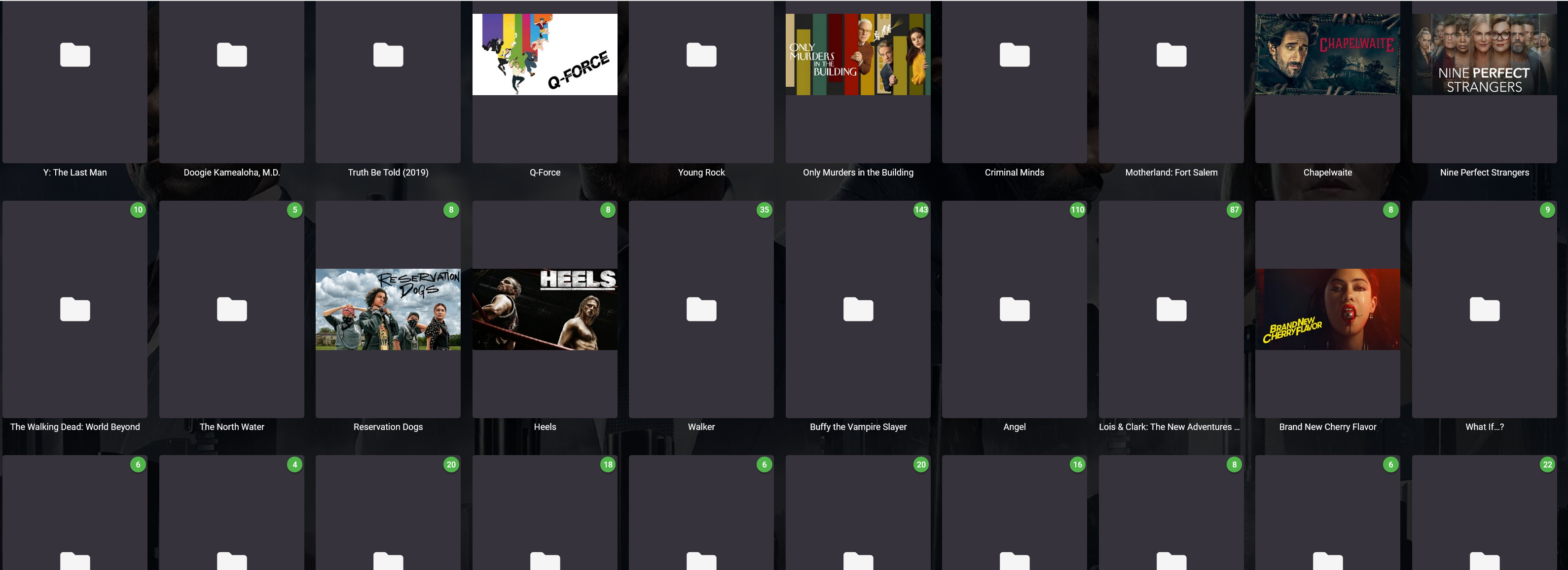

wakeboarder141 40 Posted June 9, 2022 Author Posted June 9, 2022 26 minutes ago, Luke said: Ok I'm not sure that happened, probably something related to the migration. But if you refresh metadata on existing content that should help you get images back. I have tried refreshing metadata, both replace all as well as search for missing, with or without replace existing images checked, and I still have the same issue. I have tried it at the library level as well as for individual series/movies without change. The only way I have found to get images to show is by manually editing the images and downloading new ones for each picture. I have attached a screenshot of a series after a metadata refresh. embyserver.txt
wakeboarder141 40 Posted June 10, 2022 Author Posted June 10, 2022 Update: After waiting for over a day now, the images are starting to trickle back in. It's not fast, but every time I check it there are a few more things filled in. I'm not sure why it is taking so long, but it looks like it is repairing the images.
Luke 42243 Posted June 10, 2022 Posted June 10, 2022 Right, the metadata refresh works just fine, it's just that you can't monitor the progress at this time so you essentially just have to be patient and give it time.
wakeboarder141 40 Posted June 10, 2022 Author Posted June 10, 2022 29 minutes ago, Luke said: Right, the metadata refresh works just fine, it's just that you can't monitor the progress at this time so you essentially just have to be patient and give it time. That's what had me confused. It looked like it was done, but 2 days later there are still images trickling in. Thanks for the clarification. 1
