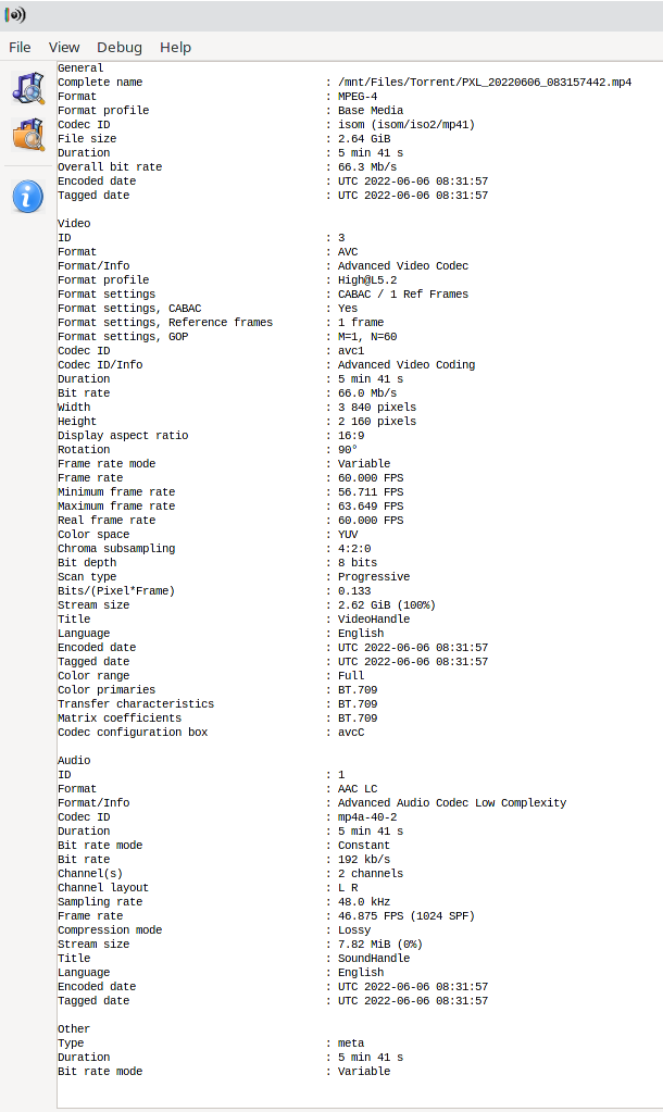

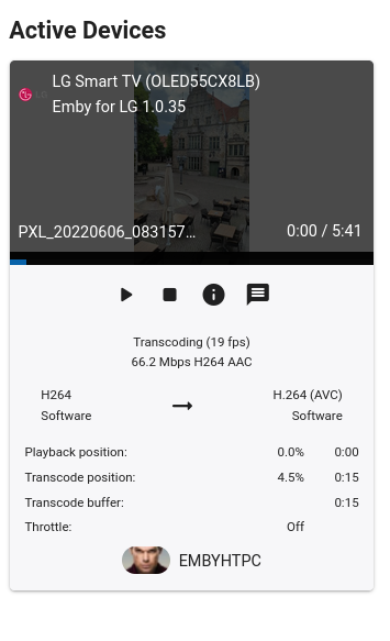

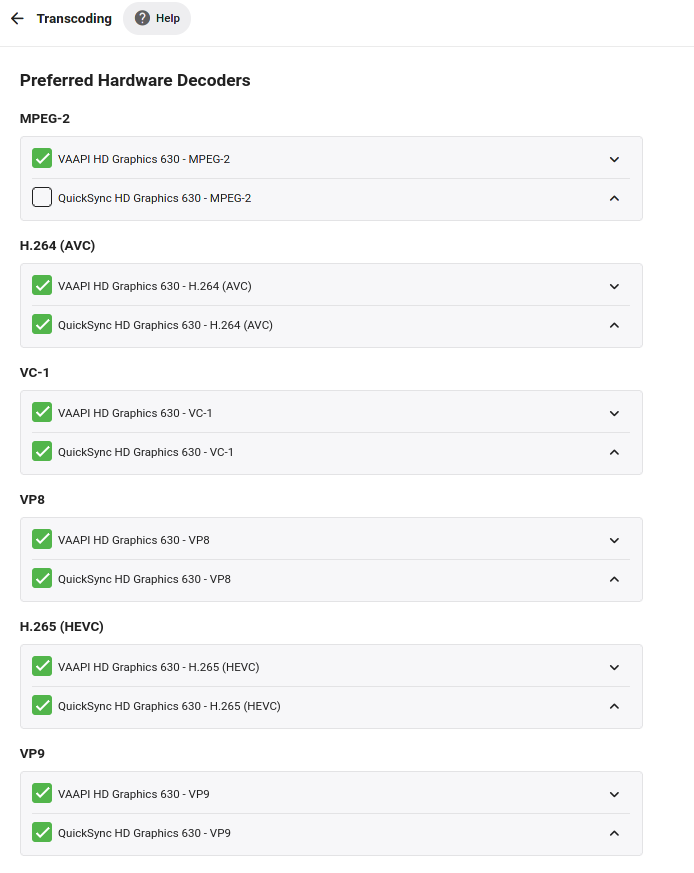

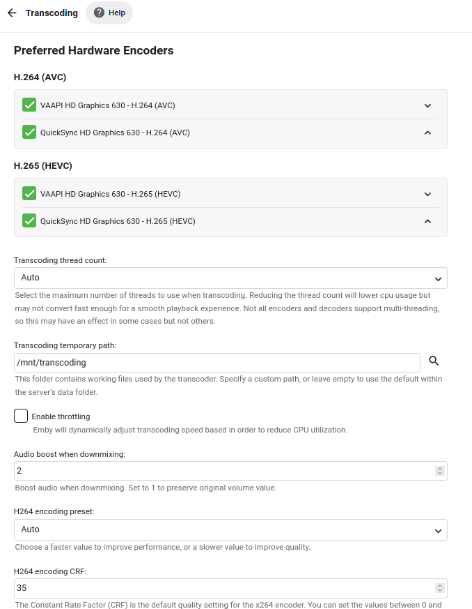

Utini 14 Posted June 7, 2022 Posted June 7, 2022 (edited) Hello everyone, I am using emby-server on Archlinux with emby-cliebt on LG OLED CX TV. I recently recorded some videos with my phone and tries watching them in emby on my TV. I noticed that a playback is very laggy and figured out that for some weird reason it is transcoding the file. I have selected all quality/speed options in the client to "auto". Or should I select the highest possible option? Also, it doesn't seem to use HW Acceleration and I don't know why? Attached are the following screenshots: emby3.png: Detailed info of the video file codec emby1.png and emby2.png showing what it is transcoding and why emby4.png and emby5.png is showing my transcoding options emby6.png shows my hardware Additional Info: The video files are on a 14TB HDD but the temportary transcoding directory is on my SSD. Log file attached as well Thanks in advance! ffmpeg-transcode-bc148b38-2004-4069-8e38-50d9f1621e7d_1.txt Edited June 7, 2022 by Utini
Utini 14 Posted June 7, 2022 Author Posted June 7, 2022 (edited) So if I understand the log file correctly then: Warning: The required encoding level (AvcLevel52) is greater than the maximum level supported by the client (AvcLevel51) My phones recording is in a higher quality than what the emby client on the LG TV supports/accepts?! Any way to fix this / change this or is transcoding the only option? And HW acceleration is not available because I do not have the premiere subscription? Bzw, just for info: my Server and Client are connected via my local home network with 1Gbit/s. Edited June 7, 2022 by Utini
Utini 14 Posted June 8, 2022 Author Posted June 8, 2022 I just purchased emby premiere and HW decoding now works fine. I can now also play the file just fine except that it is turned by 90 degrees for some reason. It was recorded in high screen instead of wide screen. Also: Transcoding TrueHD gives me weird green artifacts in the image. But I will make a new topic for that once I have done some testing.
