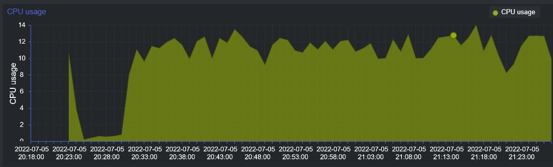

I just pointed the new server to the location of my Movies library and ran a scan.  It hummed along until it got to about 90% complete (and did so pretty quickly) and then that's when progress slows to a crawl and the RAM usage starts to climb.  This is the same sort of pattern I saw with my previous library scans (documentaries, sports, docuseries, etc) on the new server install - things go pretty smoothly until the 90% point or so (and the libraries are all quite different in terms of size) and then progress slows way down, the CPU usage increases, and the RAM usage climbs and climbs.   I'ave attached some screenshots from my Proxmox VM summary.
You can see in the CPU and Memory usage timelines how things were sailing along from the start of the scan at ~20:22:00 until ~20:30:00.  The CPU and RAM usage were both low and relatively consistent.   In that time span, the scan had gone from 0% to 86.5%.  Then things went down hill.   As I post this, I've only progressed another ~1.0% in the past hour since that spike occurred and you can see the CPU usage has been over 10x higher than that initial period (sitting at about 11-12% utilization of the 8 cores of i9-11900K that I have passed to the VM), and the RAM usage has crept up to max out all of the 32GB that the VM has allocated.

Hi, please try removing these plugins:
2022-07-05 11:24:13.742 Info App: Loading statistics, Version=3.0.0.0, Culture=neutral, PublicKeyToken=null from /var/lib/emby/plugins/Statistics.dll
2022-07-05 11:24:13.743 Info App: Loading VantagePoint, Version=1.0.0.7, Culture=neutral, PublicKeyToken=null from /var/lib/emby/plugins/VantagePoint.dll
Then restart the server and see how that compares. Additionally it appears you enabled nfo saving but did not ensure that emby server has write access to your media folders, so that's probably not helping:
2022-07-05 23:23:12.879 Error ProviderManager: Error in metadata saver
	*** Error Report ***
	Version: 4.7.5.0
	Command line: /opt/emby-server/system/EmbyServer.dll -programdata /var/lib/emby -ffdetect /opt/emby-server/bin/ffdetect -ffmpeg /opt/emby-server/bin/ffmpeg -ffprobe /opt/emby-server/bin/ffprobe -restartexitcode 3 -updatepackage emby-server-deb_{version}_amd64.deb
	Operating system: Linux version 5.15.0-40-generic (buildd@lcy02-amd64-047) (gcc (Ubuntu 11.2.0-19ubuntu1) 11.2.0, GNU ld (GNU Binutils for Ubuntu) 2.38) #43-Ubuntu SMP
	Framework: .NET 6.0.2
	OS/Process: x64/x64
	Runtime: opt/emby-server/system/System.Private.CoreLib.dll
	Processor count: 8
	Data path: /var/lib/emby
	Application path: /opt/emby-server/system
	System.UnauthorizedAccessException: System.UnauthorizedAccessException: Access to the path '/emby/media/videos/cartoons & anime/Golgo 13 (2008)/Season 1/Golgo 13 (2008) - S01E05 - The Superstar's Joint Appearance  (720p BluRay h264 8bit AC3 EN-JP 2.0).nfo' is denied.
I would choose to either turn that off or resolve the permissions problem.

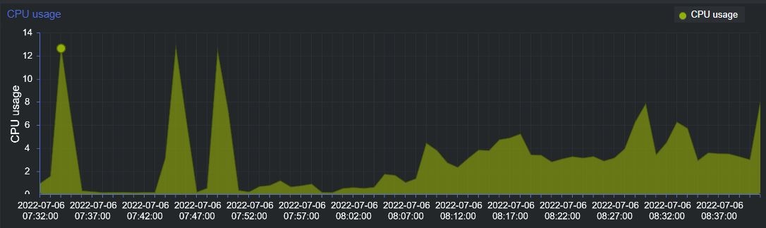

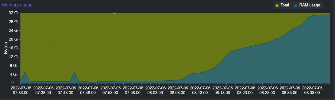

Clearing up the permissions and errors we've discussed appears to have corrected the CPU usage (it's now sitting in the 2%-4% range, about a third of what it was last night).   But the RAM is still being completely pegged.  See screenshots below.
