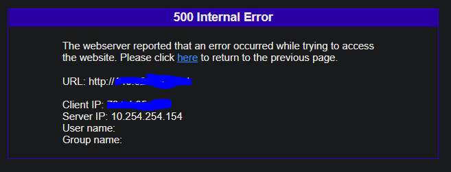

Luke 42186 Posted June 5, 2022 Posted June 5, 2022 HI, where exactly did you see a 500 error? Can you please show a screenshot? thanks.
gruppa 3 Posted June 5, 2022 Author Posted June 5, 2022 It's coming up when you try to go to my Emby server in a browser. I have Emby configured on port 80 and the router port forwarding 80 to the Emby server and it has been working fine up until Friday. I know the port forwarding is working because 10.254.254.154 in the screenshot is the internal IP of the server and if I shut down Emby the 500 error does not come up, instead it just times out. The router itself does not have a web interface on port 80 and no other services on the server are running on that port either. I have attached a screenshot of the message but can't find anything in the Emby logs.
gruppa 3 Posted June 6, 2022 Author Posted June 6, 2022 So I found the problem after poking around some more. Apparently one of my firewall policies just happened to expire at the same time Emby updated. Removing the expired policy from the Emby rule in the firewall fixed the issue so it was not a problem with the Emby server at all.
