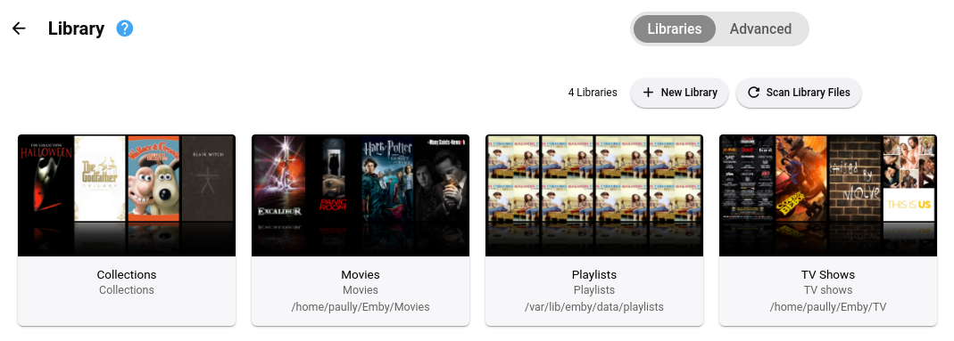

plittlefield 56 Posted June 23, 2022 Author Posted June 23, 2022 Here are some shots from the Docker version ... Β and... Is there a way to keep network_mode: host for performance but have port 8920 available and used??? Paully Β
plittlefield 56 Posted June 23, 2022 Author Posted June 23, 2022 OK, my bad... fixed the SSL issue as well. I'd put /var/lib/emby/ssl/Β in the web gui instead ofΒ /config/ssl/ I should have done this later in the day and on more coffee. The Libaries are all there, the Users are all there, my progress is all there, so ... ... all good so far! A huge thanks to all who helped and this is now making my server upgrade a lot easier. I'll watch a few things tonight and report back for a final verdict. Regards, Paully Β 1
