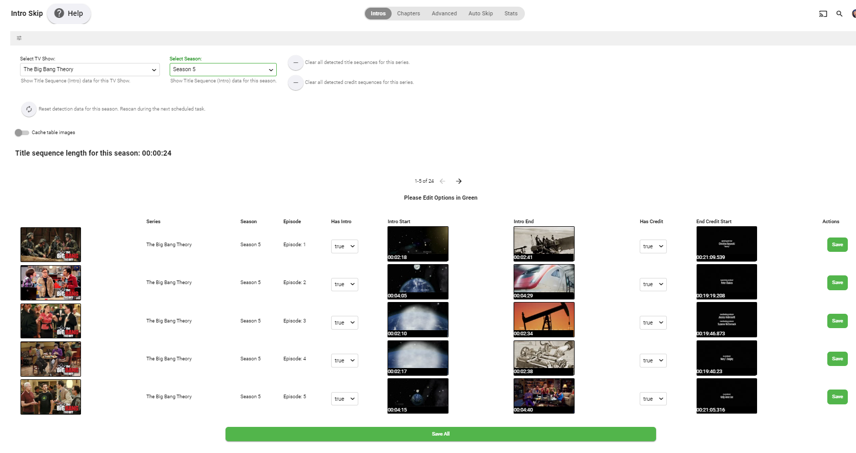

rbjtech 5345 Posted June 7, 2022 Posted June 7, 2022 It wasn't the Plugin causing the issues - BBT is second perfect for all seasons .. It probably got confused as you stopped the scan half way though, so didn't write some of the markers .. ? Anyway - All good now
MBSki 1116 Posted June 7, 2022 Posted June 7, 2022 Just now, rbjtech said: It wasn't the Plugin causing the issues - BBT is second perfect for all seasons .. It probably got confused as you stopped the scan half way though, so didn't write some of the markers .. ? Anyway - All good now Ahhh, gotcha! That makes sense. Thanks!
rbjtech 5345 Posted June 7, 2022 Posted June 7, 2022 (edited) 37 minutes ago, ebr said: But if the plug-in has placed markers in the chapters, then those would remain. I actually am not sure if the plug-in is placing actual Intro markers at this point. It is if you are running the chapters task (it will add the CreditStart marker too) - otherwise no. Both the Plugin and Core are working in harmony (as I use them to get the Button.. ) but stopping half way though any scan/process is going to throw a spanner into the works.. Edited June 7, 2022 by rbjtech 1
MBSki 1116 Posted June 7, 2022 Posted June 7, 2022 2 minutes ago, rbjtech said: It is if you are running the chapters task - otherwise no. Both the Plugin and Core are working in harmony (as I use them to get the Button.. ) but stopping half way though any scan/process is going to throw a spanner into the works.. I actually had the chapter task running, but after I uninstalled the plug-in all the chapters went away so I figured the markers were stored in the plug-in db.
rbjtech 5345 Posted June 7, 2022 Posted June 7, 2022 4 minutes ago, mbarylski said: I actually had the chapter task running, but after I uninstalled the plug-in all the chapters went away so I figured the markers were stored in the plug-in db. The Plugin is a bit of a hybrid currently - in order to get the 'button' we write exactly the same 'hidden' markers as the Core does - but the main data is written to a separate dB as Painkiller has correctly said - thus the plugin can view and edit the data independently. I believe the Core will soon be getting an editor - so Intro functionality will soon be on par with the Plugin. I'm not 100% sure what is happening with the End Credit detection yet in the Core - as currently, only the Plugin is providing this information to accurately bring up the 'Next Up' OSD - so if using the Core Introskip, for now, you will just see the normal 'Next Up' OSD pop up 30/40 seconds before the end of the episode as normal. 1
