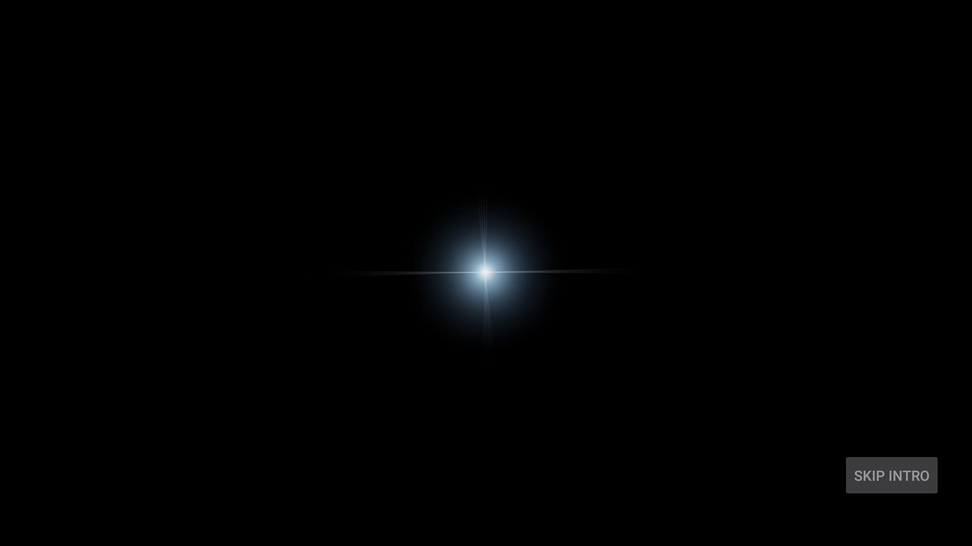

MBSki 1116 Posted June 7, 2022 Posted June 7, 2022 17 hours ago, Luke said: That seems like it would make sense. Ok, I waited and it finished detecting intros, but the Intro Skip button still shows up after the intro. And, it's showing up even when there's no intro. What do you need to help detect the issue?
MBSki 1116 Posted June 7, 2022 Posted June 7, 2022 2 hours ago, fuzzyaztc said: I have yet to see the skip intro button appear. Yea, I've seen the message pop up, but it's always been after the actual intro. I've watched Big Bang Theory several times since scanning for intros and the first time it popped up right after the intro, and the 2nd time it popped up 2 minutes after the intro. @Luke The intro skip doesn't appear to be working at all. Is there anything we can send to you to track down why it isn't working?

MBSki 1116 Posted June 7, 2022 Posted June 7, 2022 12 minutes ago, ebr said: BBT has been dead-on for me. Which season(s) have you tried? Season 5 and it was 2 minutes after the end of the intro. Season 6 and the Skip Intro started right after the intro. I tried using the standard android app. Are you using Android TV? 1
ebr 16354 Posted June 7, 2022 Posted June 7, 2022 Just now, mbarylski said: Are you using Android TV? Yes, but that shouldn't make any difference. The ones I've been watching are season 8 and 9. All dead-on. I'll check my season 5... 1
MBSki 1116 Posted June 7, 2022 Posted June 7, 2022 5 minutes ago, ebr said: Yes, but that shouldn't make any difference. The ones I've been watching are season 8 and 9. All dead-on. I'll check my season 5... I just tried season 8 and I have the same issue. It showed up about a minute after the intro on episode 1. Why would it be different on my instance?
ebr 16354 Posted June 7, 2022 Posted June 7, 2022 I just tested episodes 1-3 of season 5. Episode one was maybe 3-4 seconds late, episode 2 was right on and episode 3 was about 3-4 seconds early.
