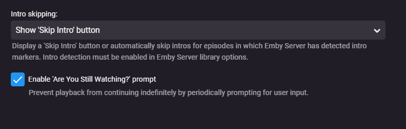

raudraido 48 Posted June 5, 2022 Posted June 5, 2022 11 minutes ago, mbarylski said: I'm running the scheduled tasks for intro skip right now, but I can't seem to select any users for auto skip. Do I need to enable something else to get my user list to show up? user settings are in their profile>playback page
rbjtech 5345 Posted June 5, 2022 Posted June 5, 2022 1 minute ago, raudraido said: user settings are in their profile>playback page For the core Introskip yes, but that screen grab was from the Plugin ..

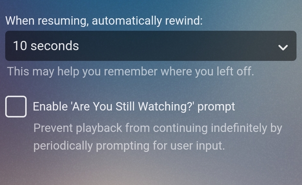

MBSki 1116 Posted June 5, 2022 Posted June 5, 2022 Ok, thanks. This has gotten a little confusing, sorry for the basic questions. I don't seem to have the Intro Skipping option in the profile page. It should show up for each user when they login right? One other question, as I seem to be running both core and plugin. Isn't the plugin needed to kick off the scheduled tasks manually? Without the plugin, how do we kick off the tasks and configure intro skip? I don't see any options without the plugin.
MBSki 1116 Posted June 5, 2022 Posted June 5, 2022 Ah, never mind, I see the option when I login locally. It's just not available when logging in via the mobile app.
rbjtech 5345 Posted June 5, 2022 Posted June 5, 2022 (edited) 32 minutes ago, mbarylski said: Ok, thanks. This has gotten a little confusing, sorry for the basic questions. I don't seem to have the Intro Skipping option in the profile page. It should show up for each user when they login right? One other question, as I seem to be running both core and plugin. Isn't the plugin needed to kick off the scheduled tasks manually? Without the plugin, how do we kick off the tasks and configure intro skip? I don't see any options without the plugin. See the answer above from Frosty to get the scheduled item listed link The Plugin and Core Intro skip are totally different - if you've never used Introskip before - then I suggest you stick with the Core version - and uninstall the Plugin. Edited June 5, 2022 by rbjtech 1
