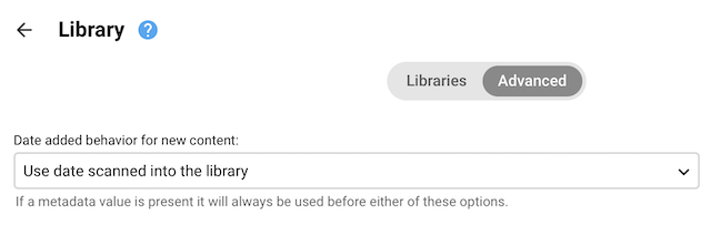

ebr 16946 Posted June 4, 2022 Posted June 4, 2022 1 minute ago, Anon28109 said: if MovieName (MovieYear)-1080p.mkv replaces MovieName (MovieYear)-720p.mp4 it's recognized as new. Hi. That depends on your date added setting. If it is file creation date, then yes because it is a new file. If, instead, it is added date, then that should not make it "new".
K22R8CT 25 Posted June 4, 2022 Author Posted June 4, 2022 13 minutes ago, ebr said: Hi. That depends on your date added setting. If it is file creation date, then yes because it is a new file. If, instead, it is added date, then that should not make it "new". That makes sense but I am using "date added"
