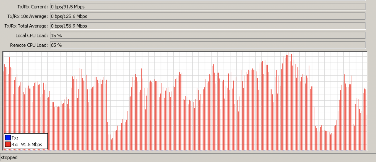

EmbyOak 23 Posted June 3, 2022 Author Posted June 3, 2022 This is 5 minutes of doing a mikrotik to mikrotik one way UDP bandwidth test over Starlink using an L2TP/IPSec tunnel. The worst is 27.7mb/s. Peak was 254.9mb/s. Even at the worst there is more than enough bandwidth to buffer content. At an average of 156.9mb/s (let's round down to 100mb/s), there is more than enough bandwidth to push an 8mb/s stream to buffer. In my prime (decades ago), I was a CCIE candidate (decided to let the younger kids do the work instead of finishing off the CCIE). I failed a moch lab exam by 2% and aced all the theory exams but I wanted to focus on people and business problems as oppose to programming routers all day. I currently over see teams that build large rural wireless networks as well as fibre communities. So, yes, I am sure. I'm fine with any questions or troubleshooting ideas you may have. But for now, I've exhausted my ideas and it currently points to not enough buffering, or buffering not taking advantage of bandwidth that currently exists.
