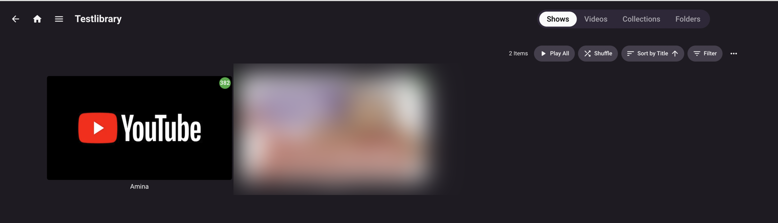

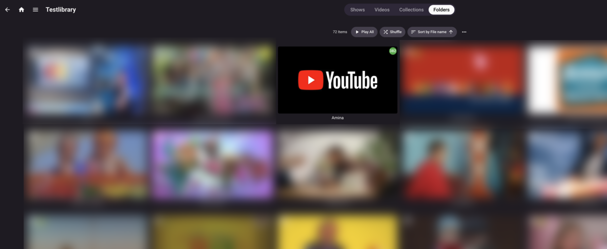

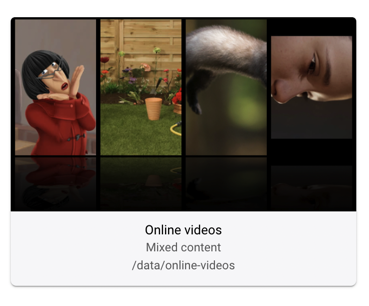

tophee 2 Posted June 3, 2022 Author Posted June 3, 2022 I'll do my best to provide any information you need to resolve this, but I'm not sure what you mean by a "specific example". Example of what? What information do you need? I'll try with some screenshots. So here is the folder "online-videos" which contains many folders with videos, one of them (the problematic one) is called Amina (and also contains various video files). The online videos folder is mapped onto a library: When I look at that library from the front end, it looks like this: All the blurred out folders are rendered correctly as folders containing videos. And so was the folder "Amina" until the most recent update (or whatever else may have cause the change). But now that folder is rendered as a TV Show, if I understand the terminology correctly. It doesn't say TV-show anywhere but when I open that folder, it doesn't give me a list of videos but this: Do you see the problem?

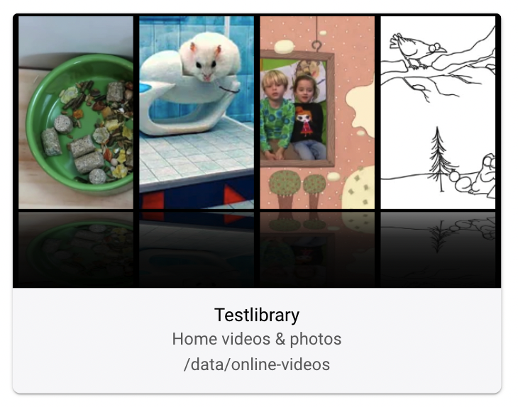

tophee 2 Posted June 4, 2022 Author Posted June 4, 2022 On 03/06/2022 at 16:29, ebr said: Can you please show us that? I don't know how a TV show would ever exist in a Home Videos library. How did you change the content type? From what I understood, it is not possible to actually change the content type, so I created a new library. Here you go: And then: I guess the easiest way of showing that it is a Show is by selecting Shows instead of folders: What do I do to fix this?
Luke 42186 Posted June 4, 2022 Posted June 4, 2022 Did you also make sure to remove the previous library?
ebr 16307 Posted June 4, 2022 Posted June 4, 2022 31 minutes ago, Luke said: Did you also make sure to remove the previous library? Ah, yeah, that's got to be it. Two libraries pointing to the same place.

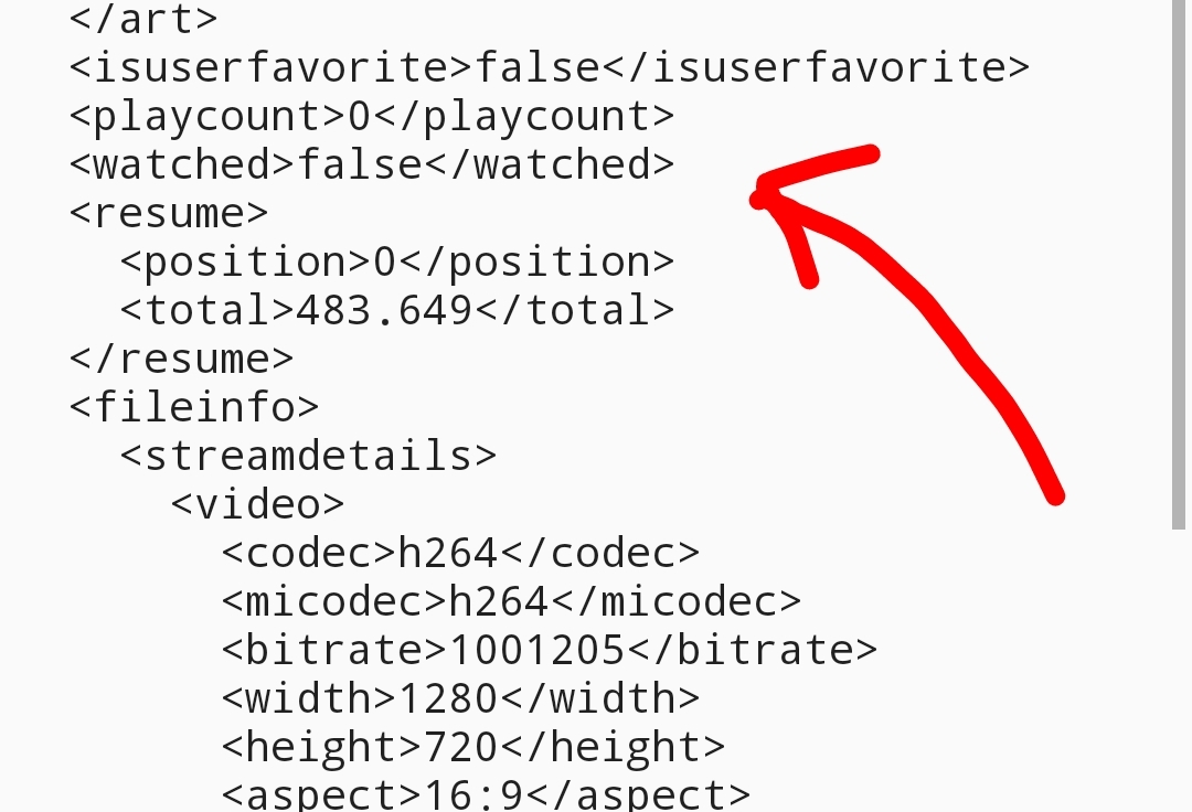

tophee 2 Posted June 6, 2022 Author Posted June 6, 2022 15 hours ago, Luke said: Playstate is an exception. We currently don't put that in nfo files. But it's right there in every nfo-file: Also the playcount is there and has been reset (it should be at least 1)...
ebr 16307 Posted June 6, 2022 Posted June 6, 2022 Hi. We have (had?) an option to write it for the benefit of other programs but Emby is multi-user and there is only one NFO file for an item so that information is not read by us.
