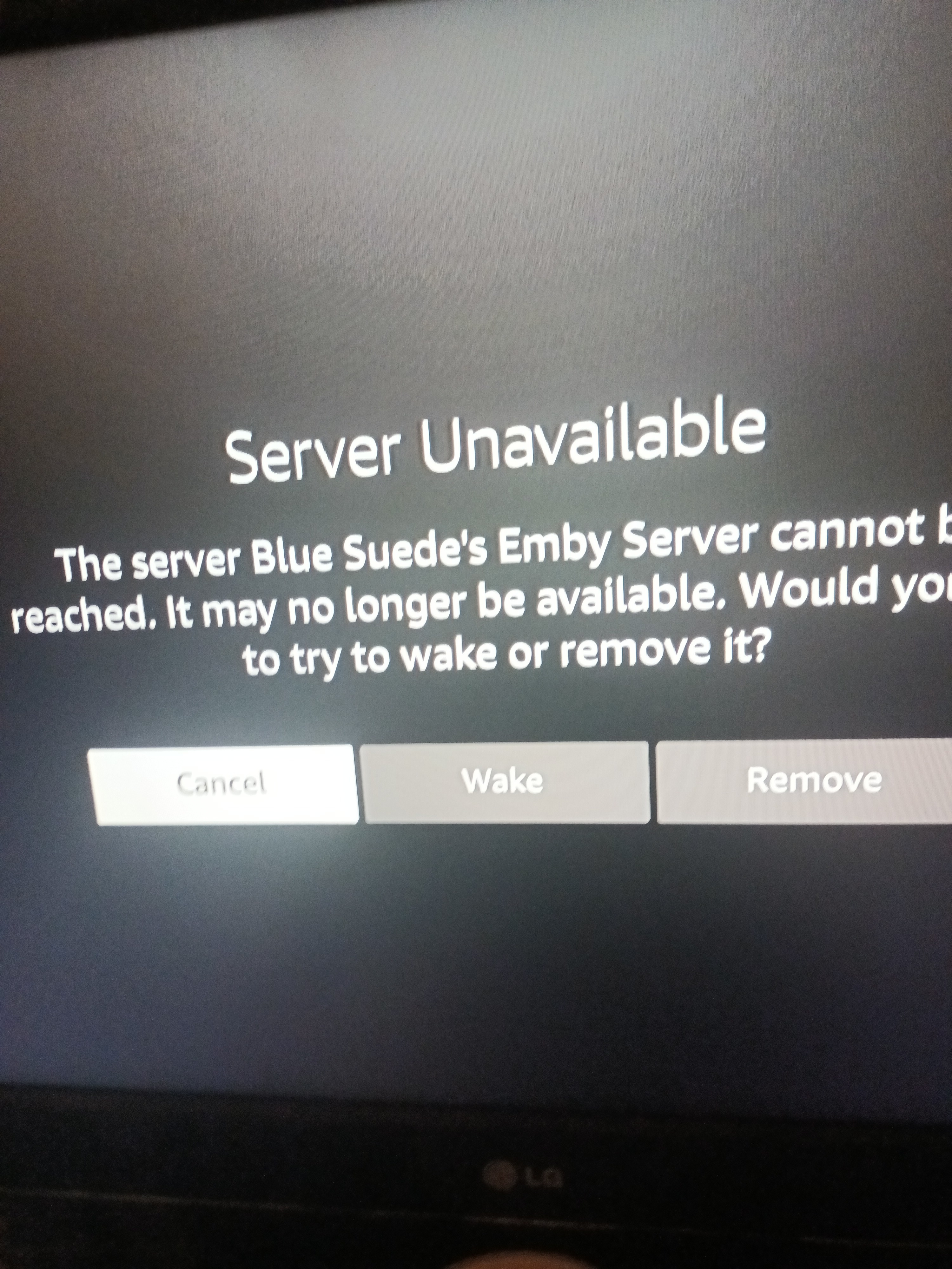

bluesuedeuk 1 Posted June 3, 2022 Author Posted June 3, 2022 Hi, a family member was trying to connect remotely last night and got the message "Sever Unavailable" (see attached image). When I restart the server at my end, it works again. Thanks.

visproduction 328 Posted June 14, 2022 Posted June 14, 2022 (edited) Blues, Your screen shot is from a TV. How are you connecting? Are you trying to access the Emby server from the TV directly? Or do you access Emby server through a phone, tablet or notebook, pick media and cast the video to the TV? The tech is quite different and unfortunately the first method is often changed by the TV and software updates to stop anyone from easily doing this method. Samsung, for example blocks a lot of access from the TV to servers. Sony TV's allow more. Every TV software update might block more access. They are all trying to avoid getting sued. This might explain why suddenly it is a problem. Either TV software was updated or your remote access from the TV features changed. Anything coming from the TV to find Emby server is likely to stop working with any update. I just avoid using this type of access alltogether. This is only a guess. I am not that familar with all the access from TV options. The second menthod works a lot better. Maybe it would an idea to convert to that method. Either get Emby phone app or access the Emby server with the web page turn on any media and send (cast) it to the TV. Hope that helps. Edited June 14, 2022 by visproduction
bluesuedeuk 1 Posted June 14, 2022 Author Posted June 14, 2022 Hi and thanks for the reply. Yes the screenshot is from a TV but it's running the Emby app on a Firestick. I've tested with various remote devices (phone, tablet, fire tv etc) and the result is the same. I've been trying some of the options from the 'connection help' page and so far I've established that my router is UPnP compatible and that it is turned on. I've managed to get remote Emby access working again for now by, once again, uninstalling Port Mapper then disabling UPnP and then re-enabling UPnP on my router. Why I'm confused is that the issue seems to have arisen since the update to Port Mapper 1.1.7 (and 1.1.8) and was working perfectly before this. Thanks again.
