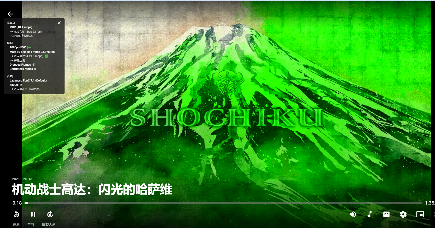

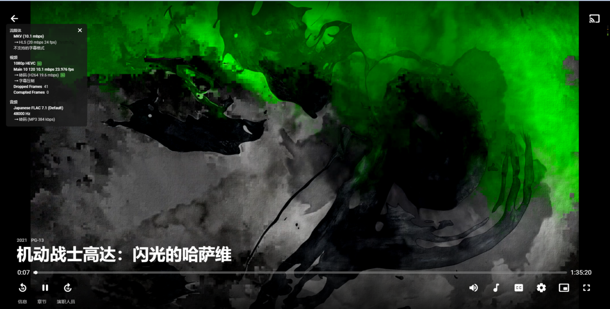

lihouyu001 0 Posted June 7, 2022 Author Posted June 7, 2022 ffmpeg-transcode-62ad6375-d0a5-48ab-bc72-0f2f227f0612_1.txt is this ok?
RanmaCanada 503 Posted June 7, 2022 Posted June 7, 2022 This should be moved to the Linux sub as this is not a windows server problem, this is a linux server problem, possible docker. There are also dropped frames, which should not be happening, which means it's a server end problem. Operating System: Linux version 5.13.19-6-pve (build@proxmox) (gcc (Debian 10.2.1-6) 10.2.1 20210110, GNU ld (GNU Binutils for Debian) 2.35.2) #1 SMP PVE 5.13.19-15 (Tu OS/Process: x64/x64 Emby Server version: 4.7.2.0 Operating system: Unix 5.13.19.6 00:35:03.730 [hevc_qsv @ 0xbfd040] get_buffer() failed 00:35:03.730 Error while decoding stream #0:0: Cannot allocate memory 00:35:03.730 [hevc_qsv @ 0xbfd040] get_buffer() failed 00:35:03.730 Error while decoding stream #0:0: Cannot allocate memory Are you using a docker or what?
lihouyu001 0 Posted June 7, 2022 Author Posted June 7, 2022 yes, i'm using docker from debian 2 minutes ago, RanmaCanada said: This should be moved to the Linux sub as this is not a windows server problem, this is a linux server problem, possible docker. There are also dropped frames, which should not be happening, which means it's a server end problem. Operating System: Linux version 5.13.19-6-pve (build@proxmox) (gcc (Debian 10.2.1-6) 10.2.1 20210110, GNU ld (GNU Binutils for Debian) 2.35.2) #1 SMP PVE 5.13.19-15 (Tu OS/Process: x64/x64 Emby Server version: 4.7.2.0 Operating system: Unix 5.13.19.6 00:35:03.730 [hevc_qsv @ 0xbfd040] get_buffer() failed 00:35:03.730 Error while decoding stream #0:0: Cannot allocate memory 00:35:03.730 [hevc_qsv @ 0xbfd040] get_buffer() failed 00:35:03.730 Error while decoding stream #0:0: Cannot allocate memory Are you using a docker or what?
RanmaCanada 503 Posted June 7, 2022 Posted June 7, 2022 maybe this addresses the problem? It would also help if you said what hardware is on the server. I know it's in the log, but it would be easier so other people know. I know there have been serious issues with quicksync and dockers on debian, and I will admit I know pretty much nothing when it comes to dealing with it. All I can do is googlefu.
lihouyu001 0 Posted June 7, 2022 Author Posted June 7, 2022 17 minutes ago, RanmaCanada said: maybe this addresses the problem? It would also help if you said what hardware is on the server. I know it's in the log, but it would be easier so other people know. I know there have been serious issues with quicksync and dockers on debian, and I will admit I know pretty much nothing when it comes to dealing with it. All I can do is googlefu. thank you,my hardware is J4125
Solution softworkz 5135 Posted June 11, 2022 Solution Posted June 11, 2022 @lihouyu001 - Does it work when you playback without subtitles? Does it work when you select VAAPI encoders and decoders instead?
lihouyu001 0 Posted June 12, 2022 Author Posted June 12, 2022 20小时前,softworkz说: @lihouyu001- 当您在没有字幕的情况下播放时,它有效吗? 当您选择 VAAPI 编码器和解码器时,它是否有效? 我已经尝试了你的项目,没有绿屏。但是转码效率有点低,所以我决定放弃这个视频。谢谢!
softworkz 5135 Posted June 12, 2022 Posted June 12, 2022 5 minutes ago, lihouyu001 said: I have tried your project and there is no green screen. But the transcoding efficiency is a bit low, so I decided to give up this video. Thanks! In one of the upcoming betas (next or one after the next), we will have hardware overlay for subtitles which will provide much better performance for subtitle burn-in. Thanks, softworkz
